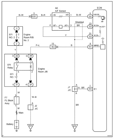

Car has a p2238 along with a p0456. Only concerned about diagnosing p2238 for now.
The oxygen sensor has been replaced with an OE Denso unit sometime within the past 3 or 4 years. Don't remember the code it threw it then.
I removed the harness connector and tested the 02 sensor on the manifold as well as a new one in box and they are both measuring 3.2ohms which leads me to believe the problem lies in the circuit. Nothing was physically noted as damaged as far as the harness or connector was concerned. DTC was cleared and reappeared.

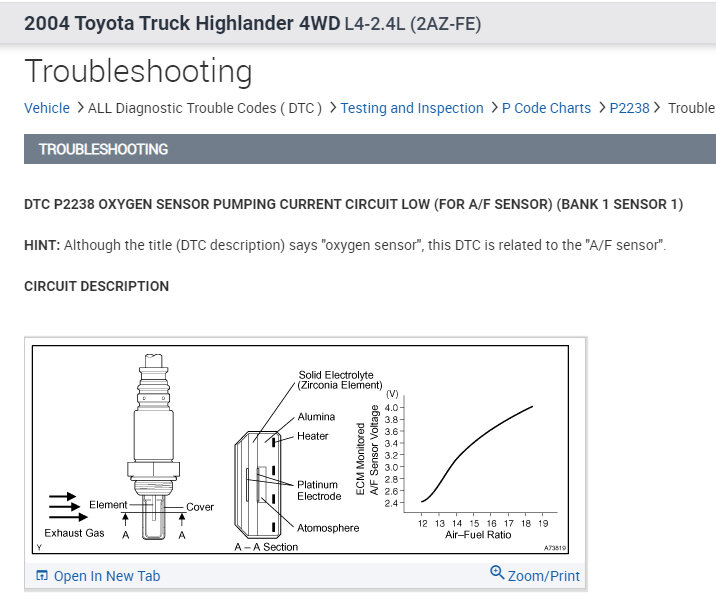

The code is specific to the bank 1 sensor 1 oxygen sensor. If it has been 3 to 4 years, the sensor may be the issue.
I attached the diagnostics below for you. Take a look through them and let me know if you are comfortable performing the procedures.

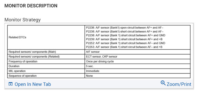

page 1-4
Basically, lists theory.

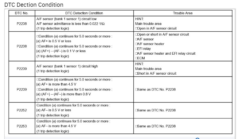

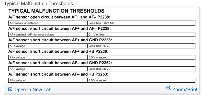

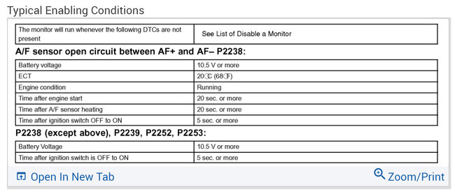

page 5 [typical enabling condition]
[question 1] is this information as it relates to theory? (Conditions to set MIL on) Or are these requirements for the troubleshooting procedures?

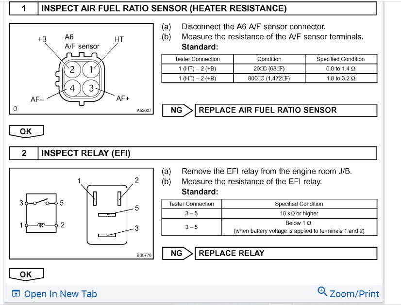

Page 9 [inspect AFR sensor heater resistance]
says to tests pins 1 and 2 @ 68F and the ohms should be 0.8 to 1.4
says to test pins 1 and 2 @ 1,472F and the ohms should be 1.8 to 3.2
[question 2] Its not specified, but I'm assuming these specifications are as it relates to Catalyst temperature?
[question 3] I already tested the 02 sensor in car as well as the new Denso and they were both around 3.2 at room temperature, which would mean they're both "bad"? ill reconduct the tests anyway to verify.
[inspect EFI relay]
test pins 3 to 5 and it should read 10k ohms?
test pins 3 to 5 with battery voltage and it should be less than 1 ohm?
[comment] Don't know if my meters go up to 10k ohms I will have to double check.

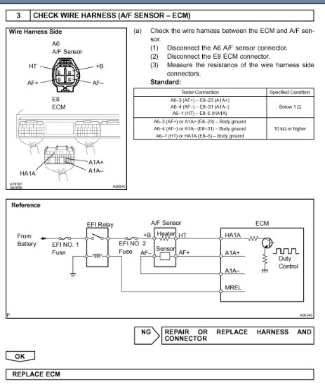

page 10[wire harness]
do not want to list all the pin specifications but roughly same process as EFI relay.
[question 4] My only question here is where the e8 ECM connector is located. I'm assuming on the ECM itself?

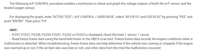

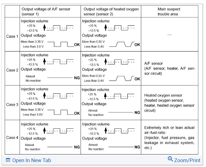

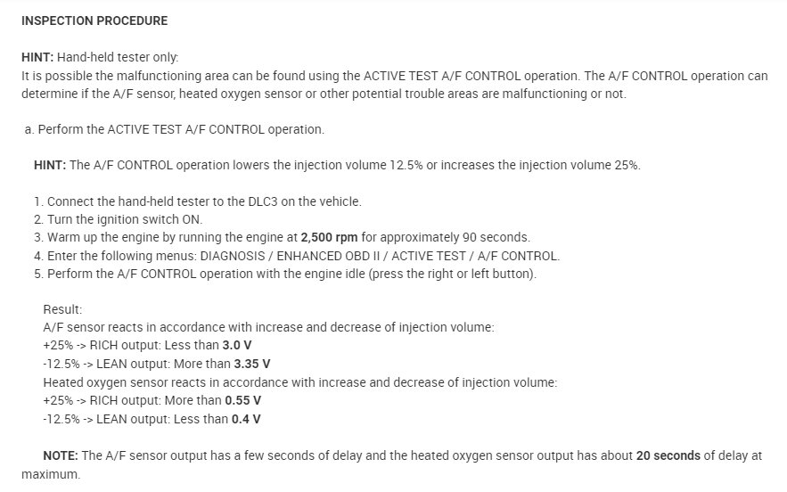

page 11-13
[question 5] This is information only applies to technicians with a bidirectional scanner, correct?
[question 6] Kind of related to question 1. Maybe i overlooked it but am i supposed to conduct all these tests with the battery connected, key off?
or
conduct them 20 seconds after engine running/5 seconds after Key Off to On (as outlined in enabling conditions).

What you are indicating sounds correct. Let me know how it turns out for you or if you have other questions.
