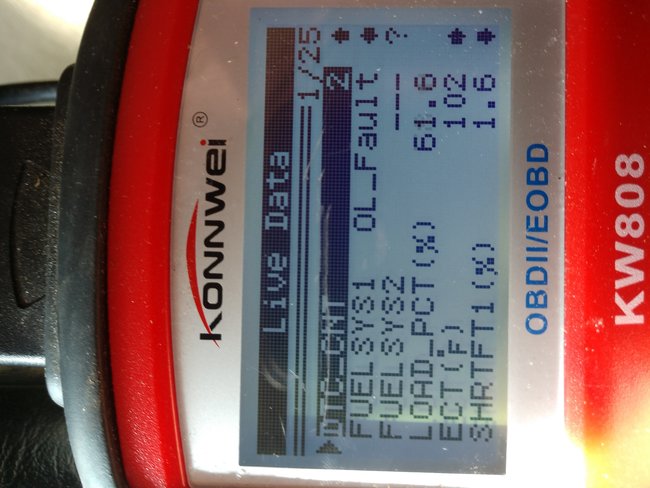

Hello all, I'm currently trying to get my car all fixed up after the wife rolled it. I've got the engine running again but it's throwing these two codes. Any thoughts on how to remedy this?

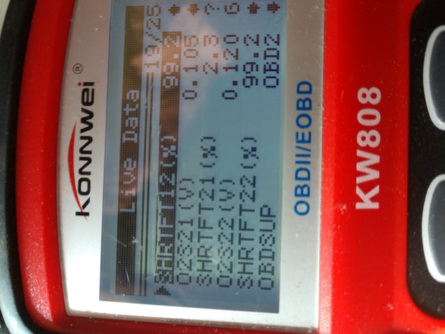

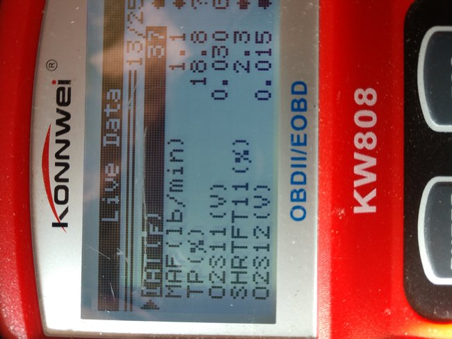

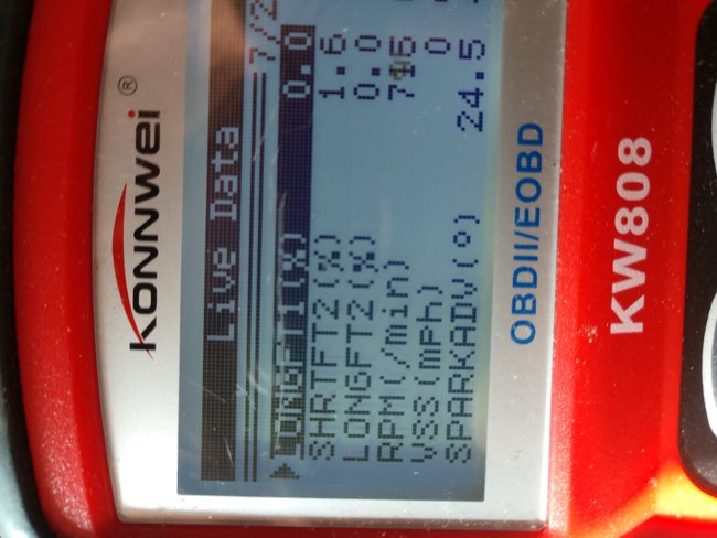

Those codes are for your upstream oxygen sensors stuck lean. Can your scan tool look at live data? If you can, look at the long and short term fuel data on banks 1 and 2. Also look at the the mass air flow data at idle with all loads off example, A/C off, lights off. Post your readings on here to get an idea as to what is going on.
You could have a vacuum leak, faulty mass air flow reading or low fuel pressure. It is very unlikely but plausible to have two upstream sensors stuck lean. Let us know what those readings are to get a an idea as to what is going on and any parts you have already replaced.

Honestly, I'm not too familiar with reading the live data, I'll add pictures to for the complete set. I haven't truly replaced anything except adding transmission fluid that drained out while upside down and the cleaning the upper intake that had oil in it and replacing the air filter.

I converted the mass air flow reading to grams per second and found the reading is 8.2 grams per second which is too high for your vehicle. Normal should be closer to 3 grams per second. I would recommend you start with cleaning the mass air flow sensor to see if we can get that reading down.

Yes, I have the 3.0. Cleaned the MAF.
MAF = 6.0479g/s
O2S11 = .040
02S12 = .015
Feb 14, 2019 at 2:15 AM

Put new MAF in-
MAF - 6.0479
O2S11 - .03-.035
02S12 - .015
Back to the original two codes.

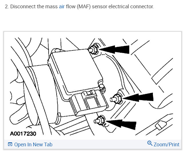

Can you also post a picture of the mass air flow sensor reading as well. And what brand sensor did you install?
Feb 17, 2019 at 5:09 AM

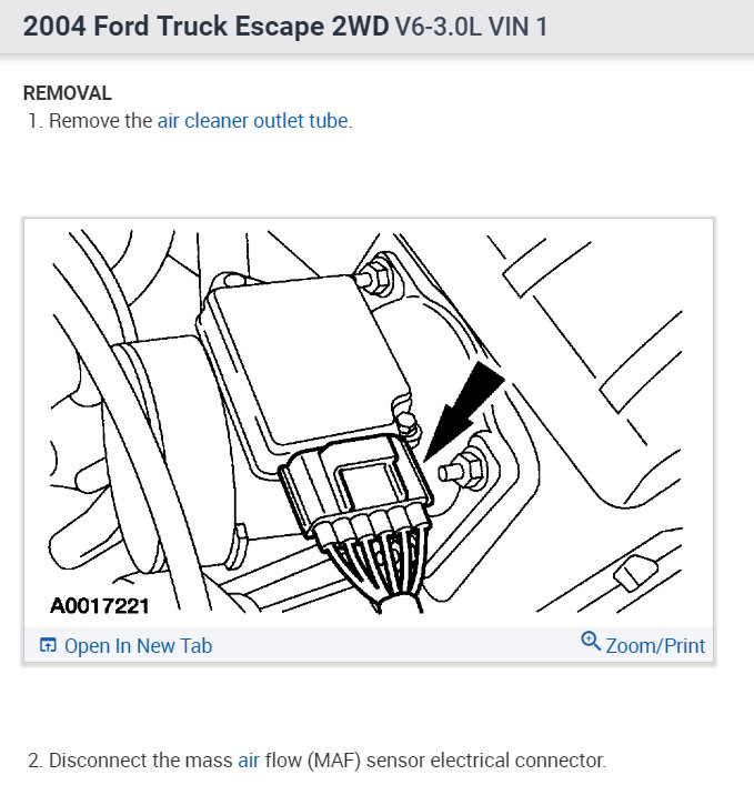

  • 55,746 POSTS
I have seen the MAF sensor cause this problem. here is a guide that will walk you through the steps and diagrams below to show you how on your car:
https://www.2carpros.com/articles/how-to-replace-a-mass-air-flow-sensor-maf
Feb 18, 2019 at 1:46 AM

If the code came back can you load pictures of the freeze frame data of the vehicle speed and long and short term fuel trims to see if this is happening at cruising speed. Also what name brand mass air flow sensor did you install?
Apr 4, 2019 at 1:02 PM
COLTEN MURPHY
  • 12 POSTS
How fast should I be going for the cruise? Can do up to about 35.
Apr 4, 2019 at 1:09 PM
JIS001
  • 3,412 POSTS
The data is already stored. Go to freeze frame on your scan tool and take pictures of the vehicle speed, rpm, and fuel trims.

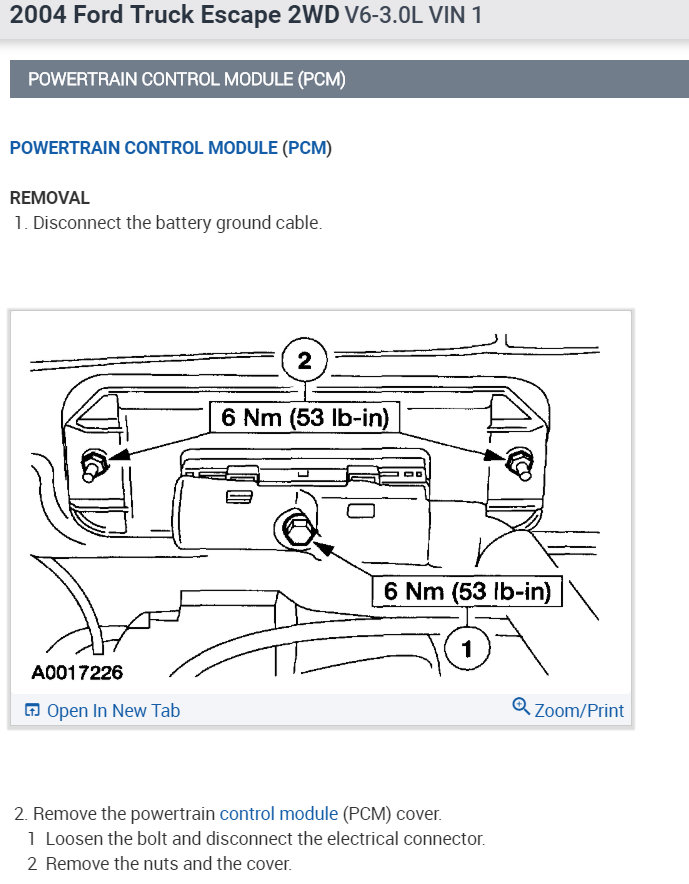

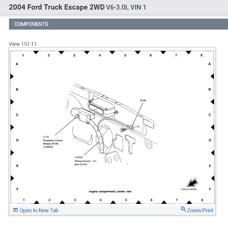

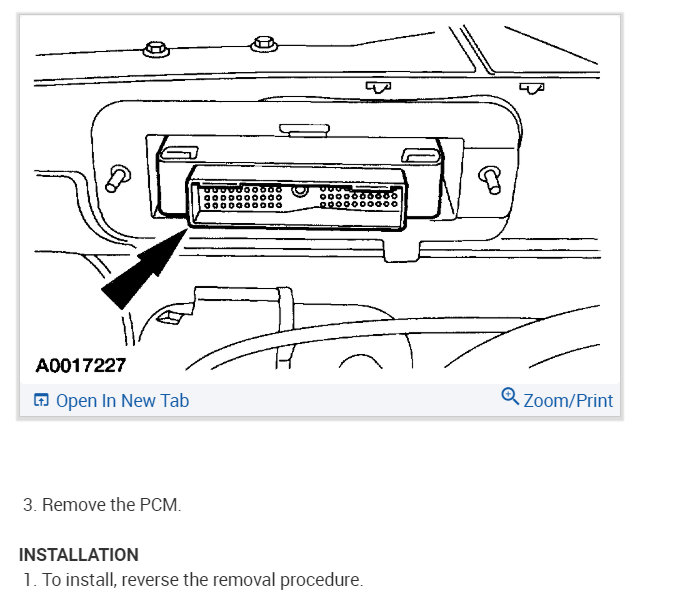

  • 55,746 POSTS
If fuel pressure is okay and you have a new MAF and the engine runs okay you have a bad PCM I would try getting a rebuilt/used one and plug it in to see what happens. Here is the location you might need it to be programmed if you get a used one.
Apr 5, 2019 at 2:37 AM
