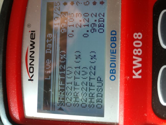

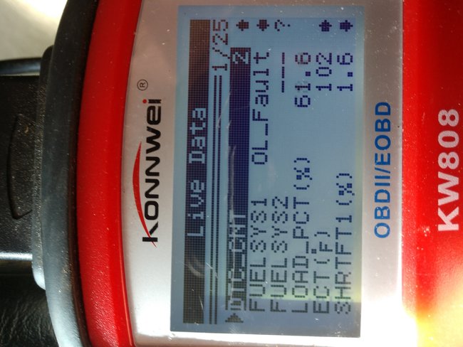

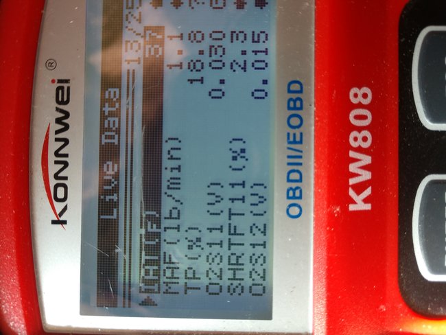

Honestly, I'm not too familiar with reading the live data, I'll add pictures to for the complete set. I haven't truly replaced anything except adding transmission fluid that drained out while upside down and the cleaning the upper intake that had oil in it and replacing the air filter.

I converted the mass air flow reading to grams per second and found the reading is 8.2 grams per second which is too high for your vehicle. Normal should be closer to 3 grams per second. I would recommend you start with cleaning the mass air flow sensor to see if we can get that reading down.

Yes, I have the 3.0. Cleaned the MAF.
MAF = 6.0479g/s
O2S11 = .040
02S12 = .015
Feb 14, 2019 at 10:15 AM

Reading is still high and with the new code it appears like the mass air flow sensor is the root cause for the light to come. If you have been driving like that for a while it could cause the oxygen sensors to remain stuck lean which may require you to replace as well if they remain stuck lean.
After replacing the mass air flow sensor, reset the light and recheck oxygen sensors to verify they are switching 0.8 to 0.1 volts (close to it). Also on a side note, buy a quality name brand sensor. Usually the house brand will be calibrated different then from the OEM.

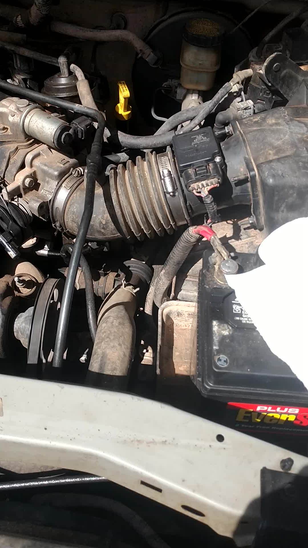

Can you also post a picture of the mass air flow sensor reading as well. And what brand sensor did you install?

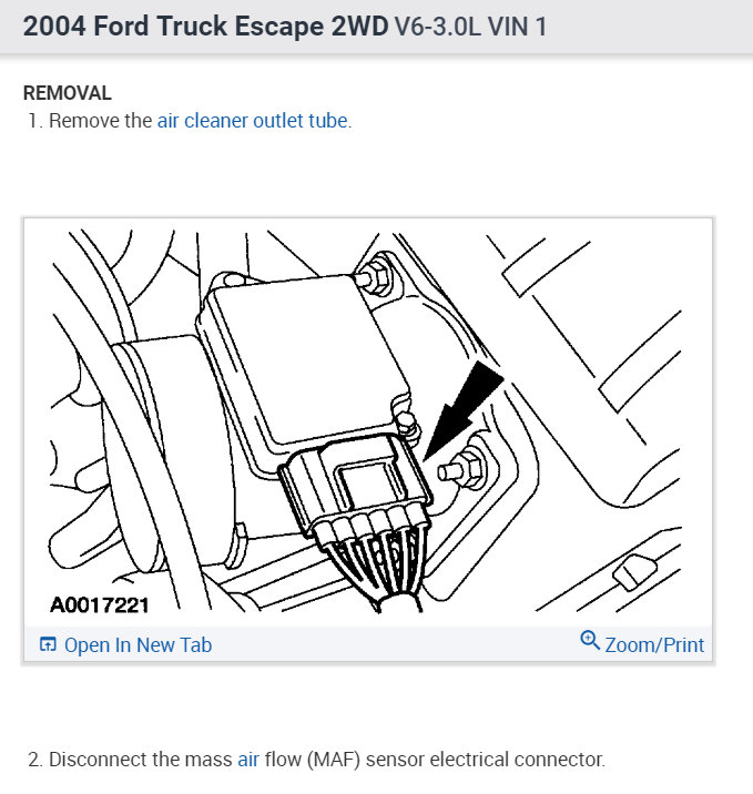

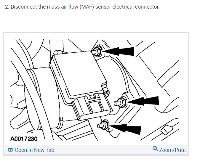

I have seen the MAF sensor cause this problem. here is a guide that will walk you through the steps and diagrams below to show you how on your car:
https://www.2carpros.com/articles/how-to-replace-a-mass-air-flow-sensor-maf

Sorry about the delay, we've been getting hit with snow and it's finally cleaning up. It's a bad sensor that I installed.

That's supposed to actually say BWD, problem isn't fixed yet.

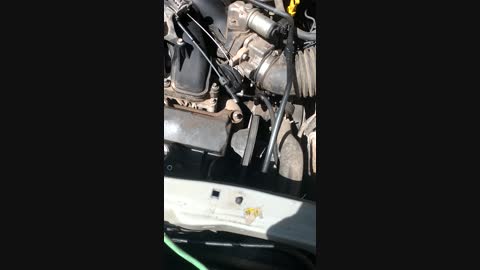

These codes are usually caused by a misfire how does the engine seem to run. Can you please shoot a quick video with your phone so we can see what's going on? that would be great. You can upload it here with your response.

The engine runs mostly fine, shakes a bit. I've replaced both upstream O2 sensors and b2s1 is still showing a code. Video should be attached.

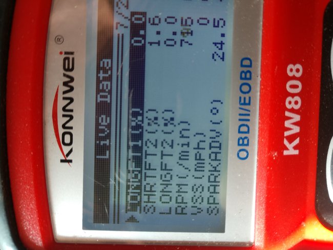

If the code came back can you load pictures of the freeze frame data of the vehicle speed and long and short term fuel trims to see if this is happening at cruising speed. Also what name brand mass air flow sensor did you install?

  • 3,412 POSTS
The data is already stored. Go to freeze frame on your scan tool and take pictures of the vehicle speed, rpm, and fuel trims.

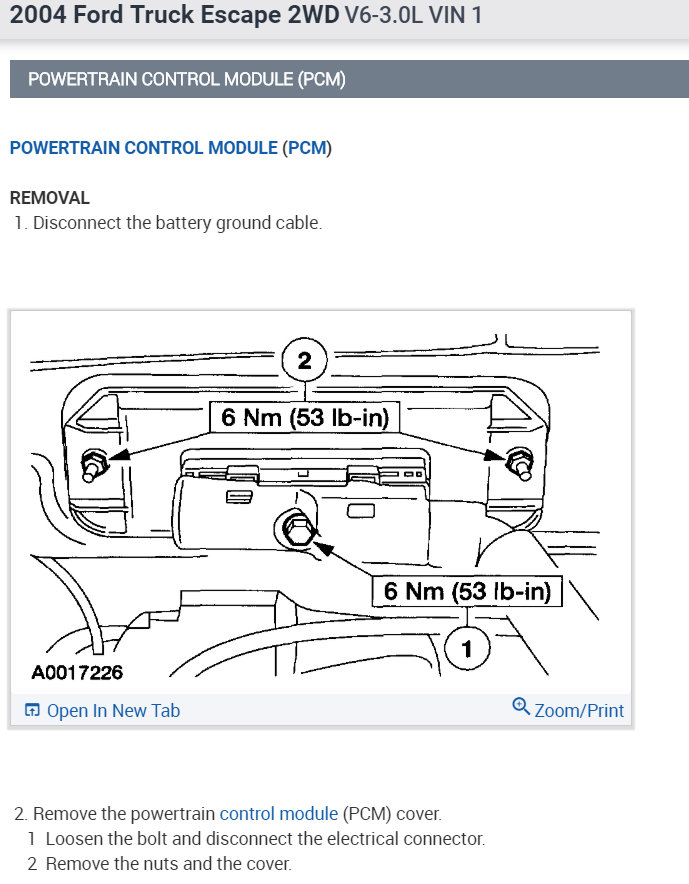

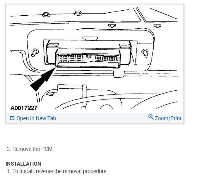

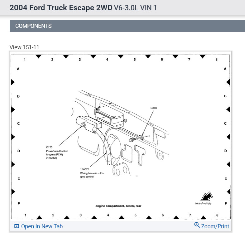

  • 54,832 POSTS
If fuel pressure is okay and you have a new MAF and the engine runs okay you have a bad PCM I would try getting a rebuilt/used one and plug it in to see what happens. Here is the location you might need it to be programmed if you get a used one.
