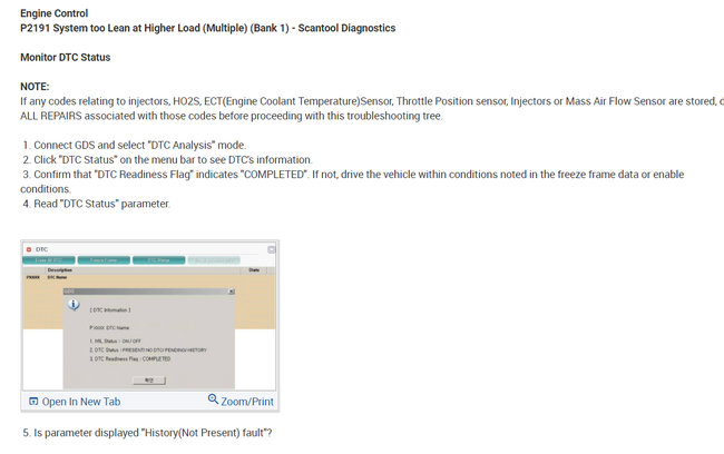

In order to provide the best possible combination of drivability, fuel economy and emission control, the PCM uses a closed loop air/fuel metering system. The PCM monitors the HO2S signal voltage and adjusts fuel delivery based it in closed loop fuel control. Changes in fuel delivery will be indicated by the long-term and the short-term fuel trim values. The ideal fuel trim value is around 0%. The PCM will add fuel when the HO2S signal is indicating a lean condition. Additional fuel is indicated by fuel trim values that are above 0%. The PCM will reduce fuel when the HO2S signal is indicating a rich condition. Reduction in fuel is indicated by fuel trim values that are below 0%. The DTC relevant to fuel trim will be set when the amount reaches excessive levels because of a lean or rich condition.
DTC Description
If the lambda controller reaches the maximum or minimum threshold, then feedback control is no longer possible and emissions will be increased. The PCM sets DTC P2191 if no proportional post catalyst fuel trim adaptation occurs for a defined time after the lambda controller has reached its maximum threshold at part load.
Engine Control
P2191 System too Lean at Higher Load (Multiple) (Bank 1) - Inspection/Repair:_:W/Harness Inspection

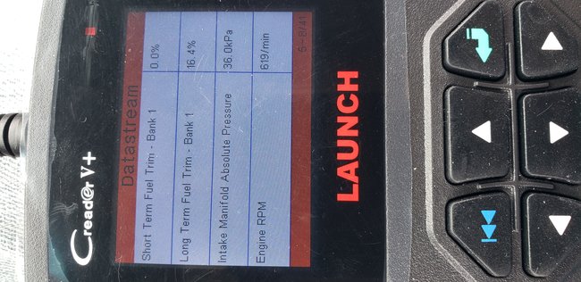

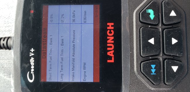

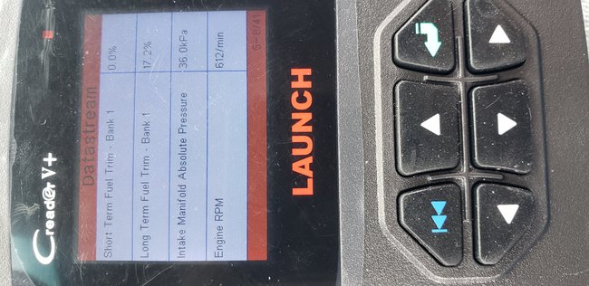

So I purchased a better scan tool and I ran a check on long term fuel trim and it fluctuates between 26 and 28 at idle. Is that at or around normal?
Apr 18, 2021 at 3:54 PM
No, not at all. It should close to 0 and maybe about -3 to about +4.
You have a vacuum leak somewhere causing this. Get some carburetor cleaner spray and with the scan tool hooked up and the engine running, spray it were the intake manifold meets the head. If the readings change, the intake manifold gasket is leaking.
https://www.2carpros.com/articles/repair-lean-mixture-codes-p0171-or-p0174-on-some-manufacturers
https://www.2carpros.com/articles/replace-intake-manifold-gasket
Apr 18, 2021 at 4:27 PM

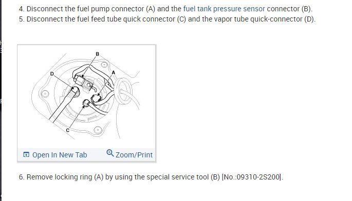

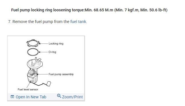

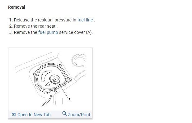

Okay, so smoke test done on evap system and no leak detected. All air intake checked for leaks and none found. Fuel pump is putting out good pressure but quickly drops after turning engine off. Going to replace fuel pressure regulator in the fuel pump assembly and see if this is good fix for P2191. Thoughts?
May 26, 2021 at 2:04 PM
I would replace the entire pump assembly, not just the regulator. The regulator is part of the pump assembly. If you have it out, I would just replace it.
https://www.2carpros.com/articles/how-to-replace-an-electric-fuel-pump
With the pressure bleeding back as it is, there is a good chance it is the check valve in the pump itself, not the regulator.
May 26, 2021 at 2:42 PM

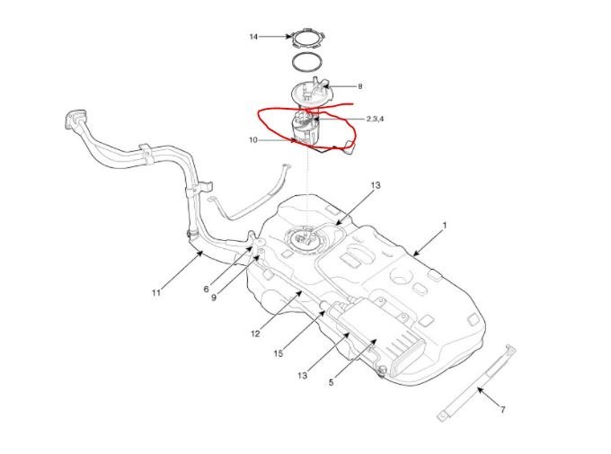

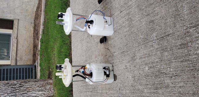

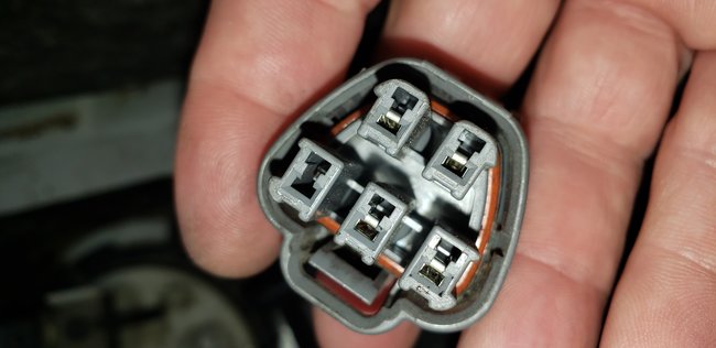

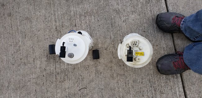

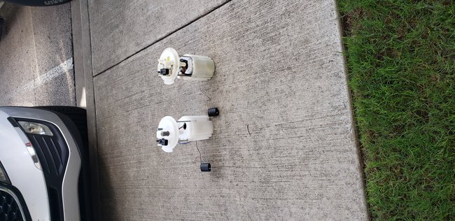

Okay, and I have a new pump in the box. There are only two differences in the part in box as compared to existing assembly. The sending unit looks a little different but I am sure the functionality will be good on it. Then on top there are two electrical connectors which they both have. There is a three prong connector and a four prong pyramid shaped connector. The difference is in the pyramid connector. My existing pump assembly pyramid connector has four prongs in it and new pump assembly pyramid connector has five prongs on it. Do you think that will make it not function properly? My parts source has been very consistent in the past 10 plus years in providing parts that fit and work good. What are your thoughts please? Thank you in advance.
May 26, 2021 at 5:46 PM
LESQUENAZI
  • 25 POSTS
I guess the real question is, could this loss of pressure be causing the P2191 code in your experience?
May 26, 2021 at 6:02 PM
No, it does not sound right.
Do you have the part number from the old pump?

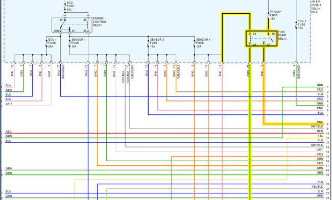

If there are 5 prongs, then you need the correct connector. I attached possibiles for you below and the OEM number is there as well. It has to be the exact part number.
May 27, 2021 at 2:31 AM
LESQUENAZI
  • 25 POSTS

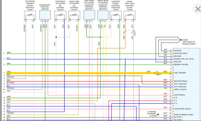

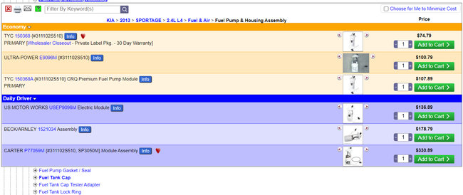

I do use RockAuto.com for my parts source. The pump I purchased is a TYC model no.150368. Which is what RockAuto lists for my particular year, make and model.For a 2.0l turbo engine. When I visit the www.tycusa website they show same pump as fitment for my particular vehicle.
May 27, 2021 at 8:04 AM
Can you post a picture of the new pump and the old pump side by side?
May 27, 2021 at 8:58 AM
LESQUENAZI
  • 25 POSTS

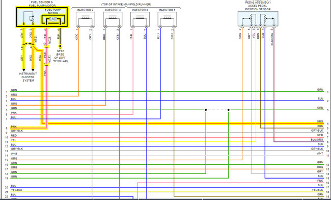

So I just finished installing new pump and drove it for 15 miles. I don't notice a difference and to be quite honest I have tried so many things. I have lost all hope in that getting that code removed. Six months of research,hundreds of dollars on dealership, mechanic and my adding parts in hopes that the new parts will remove this stubborn P219. And it keeps coming back. And the dealership suggests that the remedy is buying a new one. Lol!! They wanted to throw a new pump on there for $680.00 but could not guarantee that would remove the code. Now my registration will expire on 5/31/21 and I use my car to work. Work will not allow me to use my vehicle with expired tags. I'm bumming. I loaded some pictures anyway.
May 27, 2021 at 5:10 PM

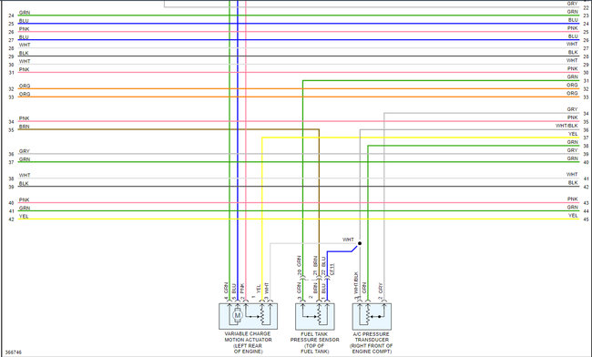

Okay, it looks like the fuel pump is correct as in the diagram I attached, the connector only uses 4 wires in the connector. The fifth cavity is empty.

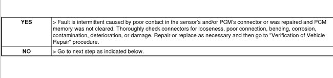

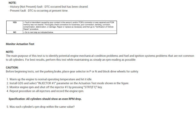

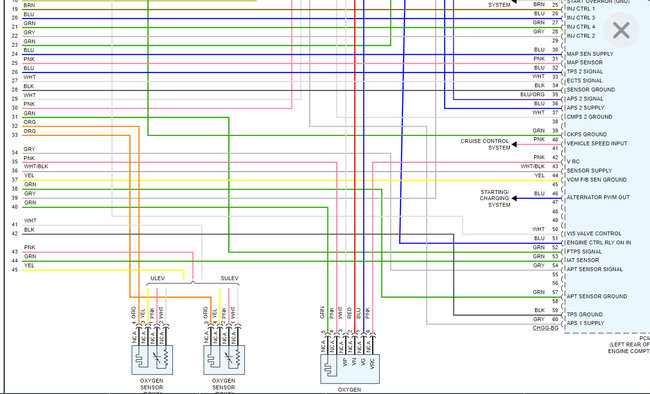

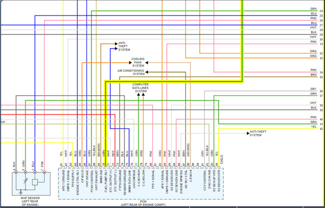

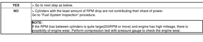

You need a scan tool to measure the long-term trim percentage. That will tell me how lean this is running. It is also possible the injectors are partially clogged. Additives have no effect on cleaning. The only way to clean them is to disable the pump, use a system that connects to the pressure port, and injects cleaner directly into the system. The engine will run on this fluid and does a great job cleaning the injectors.

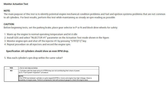

I also attached the flow chart for the code to follow. The only catch is you need a scan tool for the testing. A code reader will not help at all.
May 28, 2021 at 1:45 AM
LESQUENAZI
  • 25 POSTS
So I put in new pump assembly and ran it for almost 3 hours straight last night. After that time and 91 miles check engine light came back on just as I was getting my hopes up. That was the longest time elapsed and mileage covered after clearing the code and it coming back on. Same code P2191. still idles a little rough. Still not getting optimal gas mileage but not off by much. No other performance issues other than that. Hooked up scanner and long term fuel trims fluctuate from 15 to 18 at idle. This is an improvement from the last time I checked them when they were at 25 to 28 at idle. I put pictures for you to see below. What do you think? I really appreciate your attention and help on this as I am really struggling to correct this issue.
May 28, 2021 at 2:54 PM
I think you need to have the injectors cleaned. They sound like they are not delivering enough fuel.
