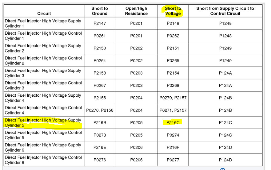

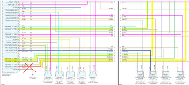

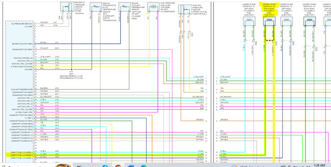

misfire on cylinder 5. dtc code p216c is for fuel injector 5 circuit high. i replaced the fuel injectors and still get the same code. i need the wiring diagram for the ECU to test ohms of each injector circuit as well as continuity between the ECU connector and injector connector.
Aug 16, 2023 at 10:10 AM
  • 110,244 POSTS
To get you started, the code is specific to a short to power for the number five injector. I thought that might make it easier for you. (See pic 1)

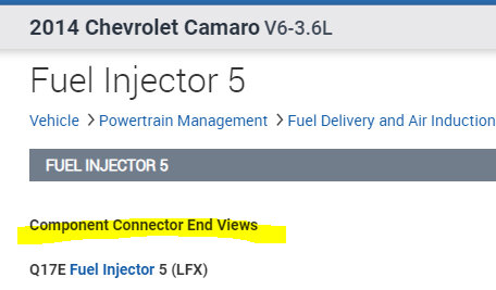

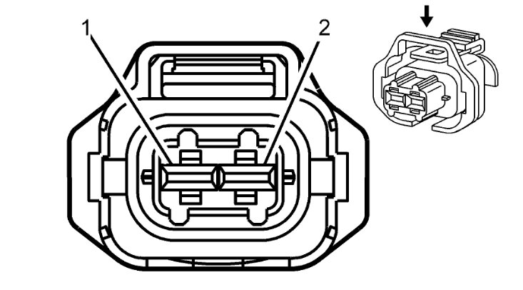

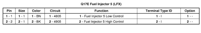

Now, I attached the wiring to injector 5 from the PCM below (pics 2 and 3). Additionally, I attached a connector pinout for the same injector. (Pic 4, 5, 6)
Let me know if this is what you needed, or if you have other questions.
Aug 16, 2023 at 3:45 PM
SKRIPTIC_15
Could this short be caused by the ECM? Thank you for the diagrams.
Aug 16, 2023 at 3:47 PM
  • 110,244 POSTS
It could, but chances are it is either wiring-related or connector related. Check to see if there is constant power or ground at the injector connector. If there is, then make the same check at the PCM itself. Note that the pins are small at the PCM, so it is possible one is damaged or making contact with another.
Let me know what you find. I'm interested in knowing.
