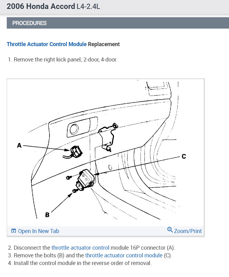

Yes, I don't like using secondhand parts for the throttle system, but there is a throttle actuator control module I would replace because they go bad and can cause this code. Here is the location and how to replace it in the diagrams below. Check out the diagrams (below). Let us know what happens and please upload pictures or videos of the problem.

Sorry this reply has been so long in waiting. The car is back in my hands now. I have replaced the module in question, car seems to be running fine with it. Unfortunately it may be days weeks or months waiting to see if the problem comes back. I have not got any pictures or videos of the problem, but should it arise again i will endevour to take some.
Also i bought myself a decent scan tool so that i can recalibrate the TPS should it happen again, as thats what the garage did and would solve the problem for a time. If the module in question is faulty, would it be a case of the module not activating the throttle plate intermitantly and over time this would cause the sensors to read out of place?

That is hard to say because the unit all inclusive. Make sure the connector is clean with no corrosion. Let me know if the problem comes back.
