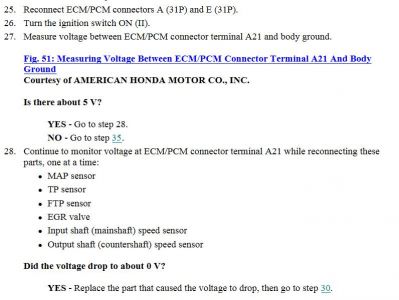

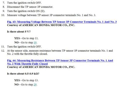

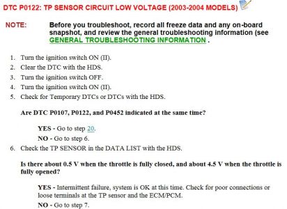

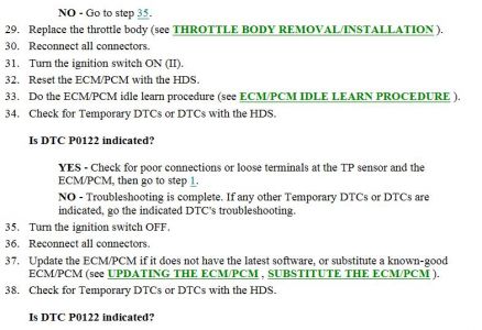

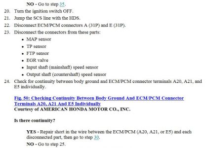

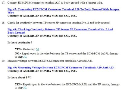

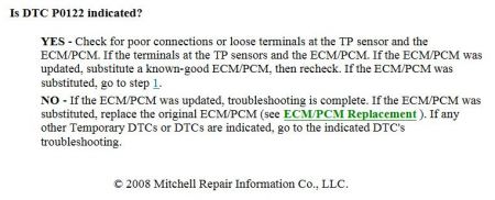

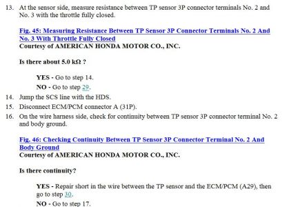

hi there
i have p 0122 tps a circtlow coad
so how to fix that
May 30, 2009 at 9:20 AM
KHLOW2008
  • 41,814 POSTS
Hi darshan, Here are the procedures.
https://images.2carpros.com/forum/automotive_pictures/192750_DTC0122TP03Accord4cyl01_1.jpg
https://images.2carpros.com/forum/automotive_pictures/192750_DTC0122TP03Accord4cyl02_1.jpg
https://images.2carpros.com/forum/automotive_pictures/192750_DTC0122TP03Accord4cyl03_1.jpg
https://images.2carpros.com/forum/automotive_pictures/192750_DTC0122TP03Accord4cyl04_1.jpg
https://images.2carpros.com/forum/automotive_pictures/192750_DTC0122TP03Accord4cyl05_1.jpg
https://images.2carpros.com/forum/automotive_pictures/192750_DTC0122TP03Accord4cyl06_1.jpg
https://images.2carpros.com/forum/automotive_pictures/192750_DTC0122TP03Accord4cyl07_1.jpg
https://images.2carpros.com/forum/automotive_pictures/192750_DTC0122TP03Accord4cyl08_1.jpg
