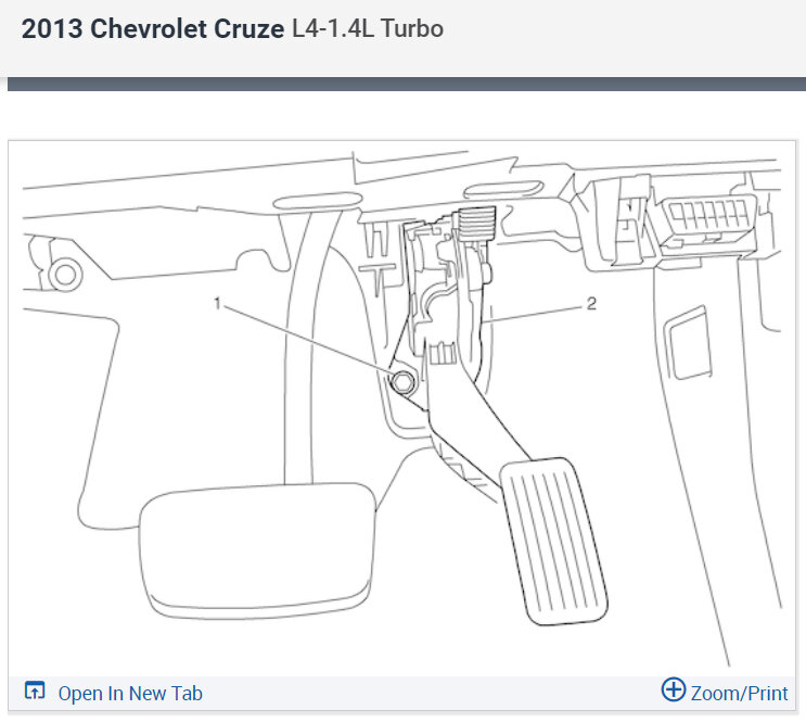

Hello. I need some help figuring out why my valve connecting to my throttle body has oil in it? I cleaned it and it ran after for about 10ish minutes and the same amount came back when I inspected it again. The codes I received have put my vehicle into limp mode. They made my car have a rough idle while it was in limp mode and RMPS fluctuates a little without limp mode. I do not know what to look into. PCV, turbo (I know it has a crack, probably stress crack, near the fan), injectors, valve cover gasket, piston blowby?

These are throttle pedal position sensors codes, but and can be the throttle body causing it, that is the catch 22 on this problem. Since the throttle body takes the most abuse they go there first. When cleaning it, it must be done thoroughly.
P2135 - Throttle/Pedal Position Sensor/Switch A/B Voltage Correlation:
P0222 - Throttle/Pedal Position Sensor/Switch B Circuit Low Input:

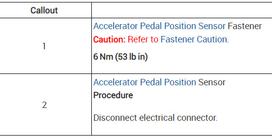

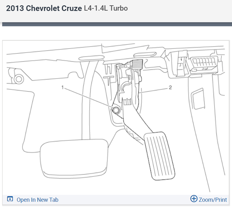

You can try getting the pedal sensor and try it first since it is the easiest. Or you can try testing the output of the sensor which I can show you.
Here is the location of the sensor. Check out the images (below). Please let us know what happens.
