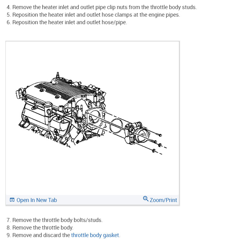

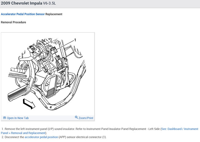

I keep getting code P2127: Throttle/Pedal Position Sensor/Switch “E” Circuit Low. This started off as an "engine power reduced" message maybe every 4-6 months but it always went away after restarting the car, until it didn't.
At this point I've cleaned inside the throttle body, and I've gotten a new gas pedal. Nothing is helping.
At the moment I'm not even getting a code on my reader.
I have an idea to simply unplug the 2nd air check valve sensor, but I can't find it.
Can anyone help me find the sensor or should I just replace the throttle body?
Any suggestions are welcomed.
Sep 6, 2023 at 12:07 AM
  • 55,649 POSTS

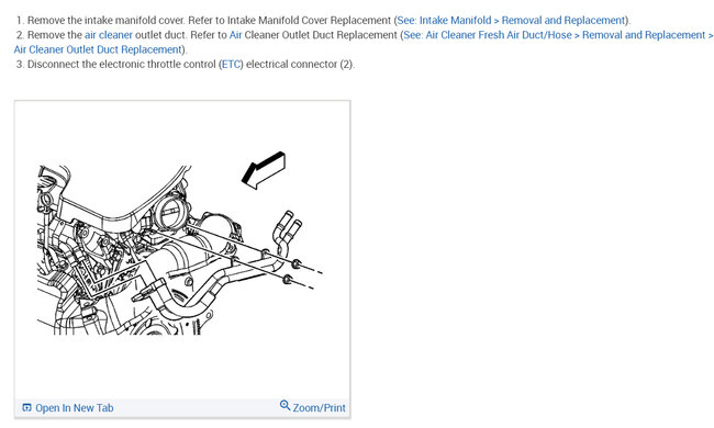

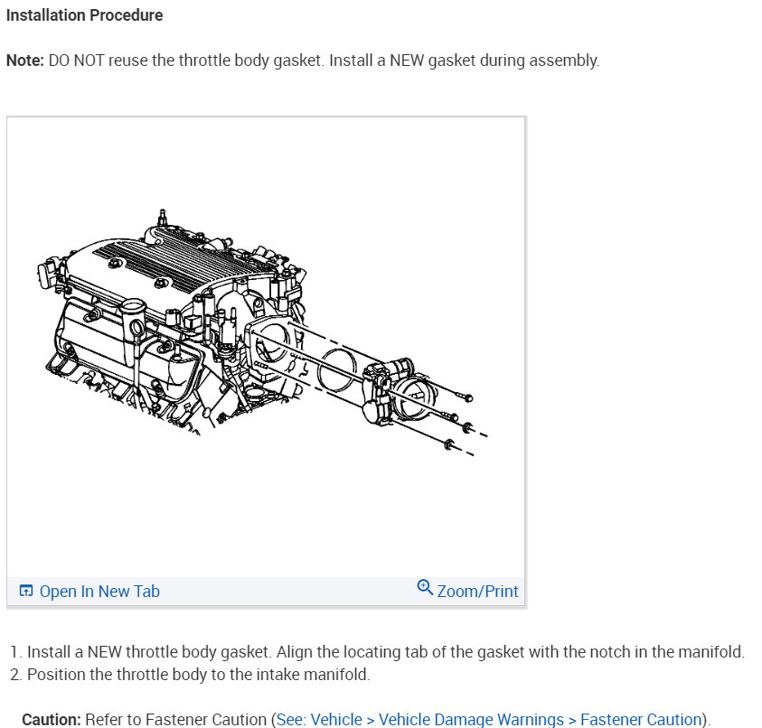

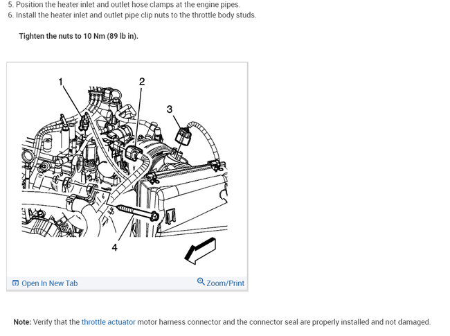

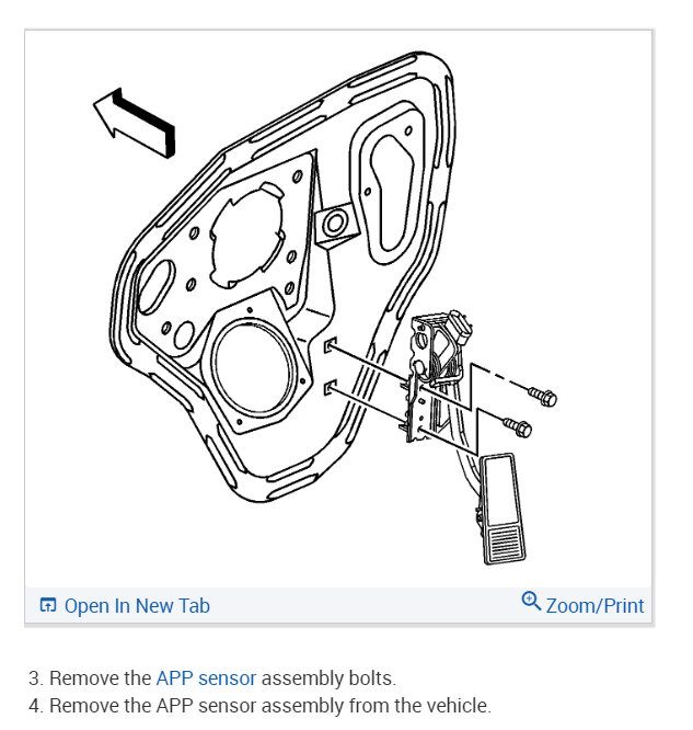

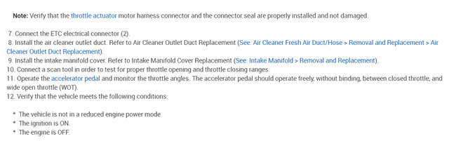

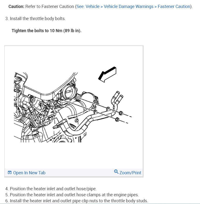

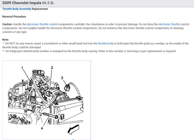

If you have replaced the accelerator pedal with sensor then I would replace the throttle body, cleaning it will not help. Here is how to change the throttle body out correctly and I have included the accelerator pedal as well to make sure we are on the same page. Check out the images (below). Please let us know how it goes.
