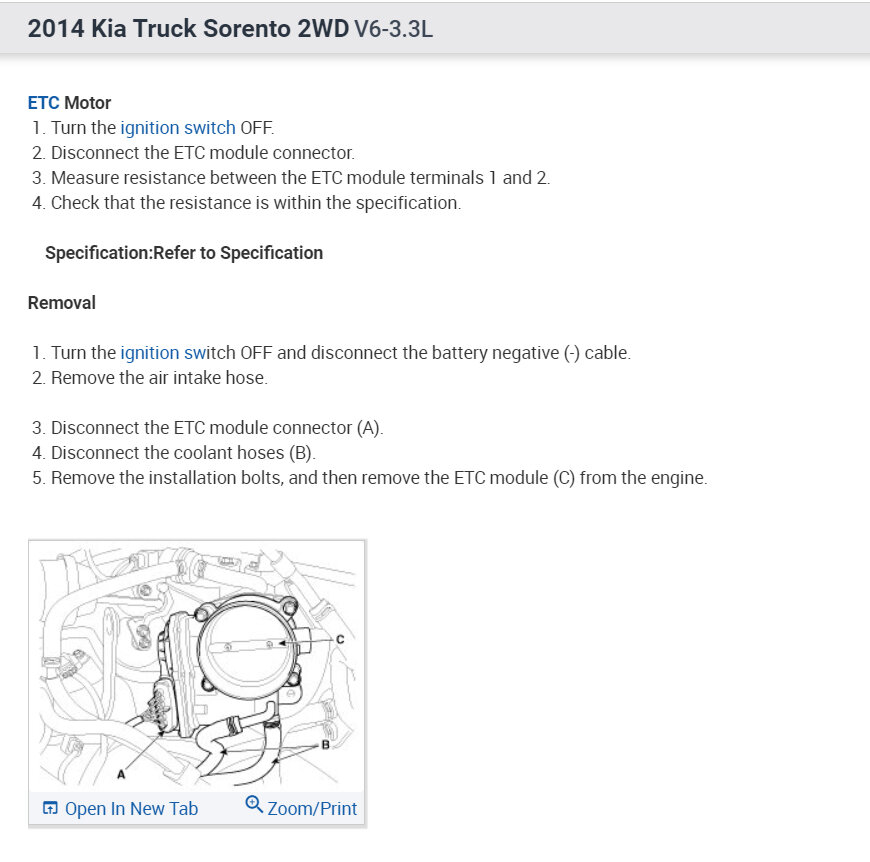

Recently the battery and alternator were replaced. Car had a coolant leak two days later. Leak stopped. Drive for a week with no issues. Car went into limp home mode after a week and threw a p2110 code. Had the computer reset since the first mechanic didn’t after he replaced the battery and alternator.
Car drove fine for 2 days. Wouldn’t start this morning.
No idea what to check next.

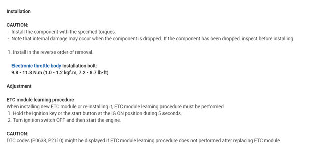

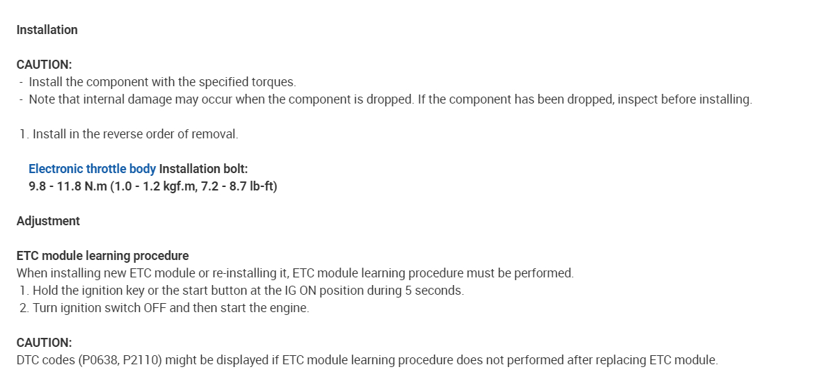

P2110 is a major failure in the throttle actuator control which will make the car not start. I would service the throttle bore first because "coking" can cause the malfunction. This guide will help you and I have included how to do the job on your car in the images below.
Check out the images (below). Let us know what happens and please upload pictures or videos of the problem.
