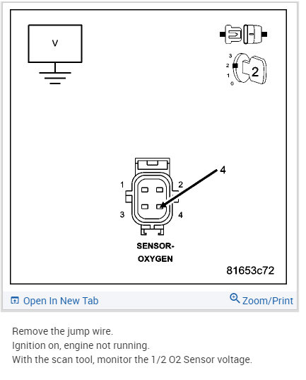

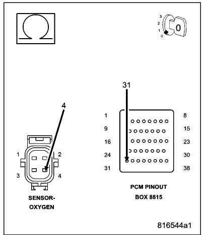

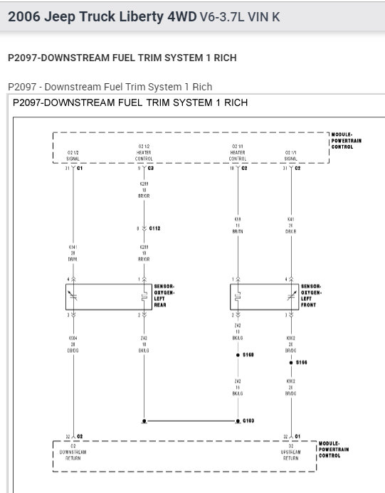

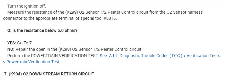

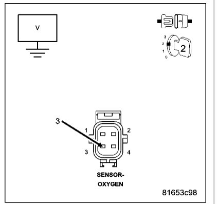

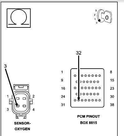

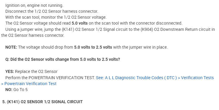

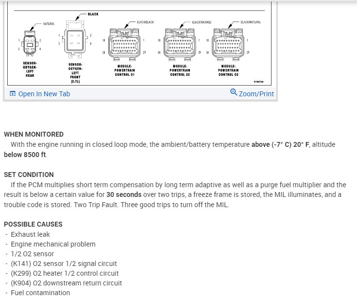

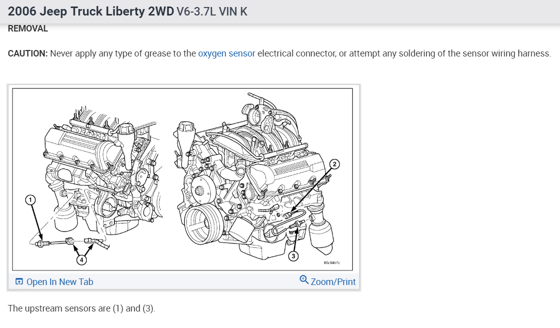

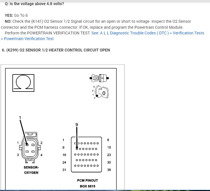

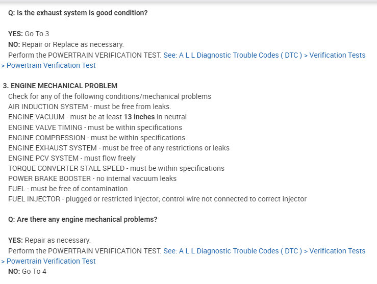

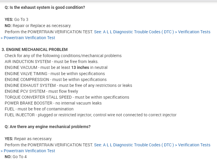

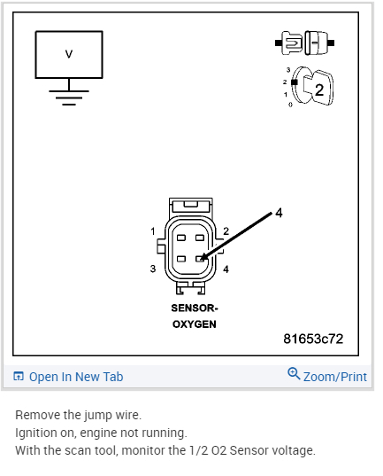

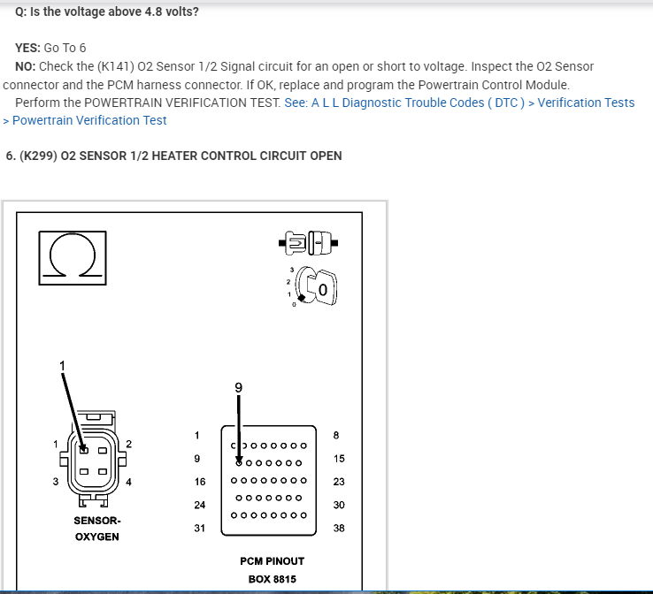

Have code p2097 come up. I know it's bank one, but not sure what sensor. I'm guessing bank 1 sensor 2. Saying fuel trim too high.
Aug 13, 2019 at 6:42 AM
DANNY L
  • 5,648 POSTS
Hello, I'm Danny.

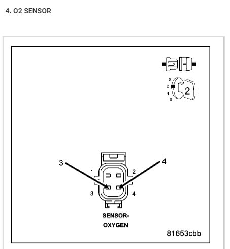

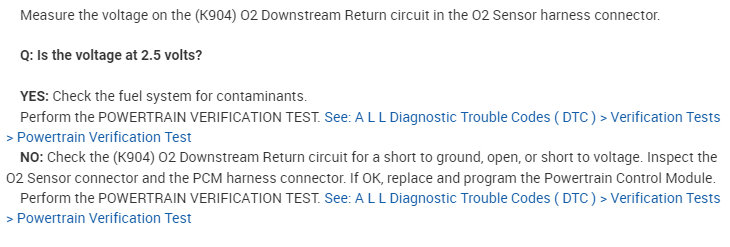

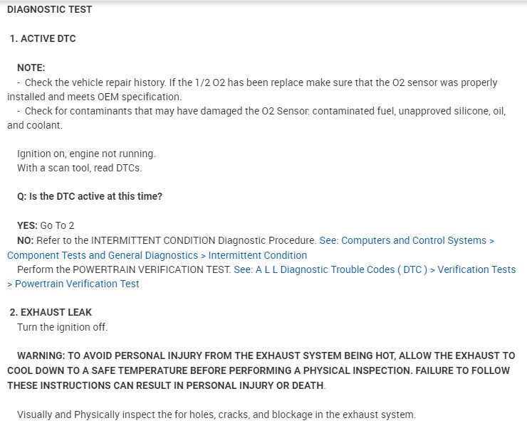

I've attached a series of step-by-step pictures below to help diagnose you problem. Hope this helps and thanks for using 2CarPros.

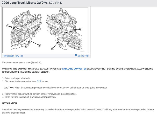

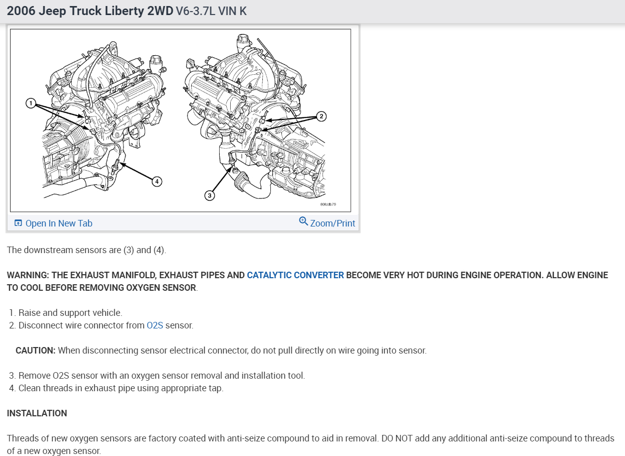

Thank you for the information. i am guessing it's bank one sensor 2. just had new muffler and tail pipe put on code came back.
Aug 15, 2019 at 12:43 AM
  • 55,399 POSTS
P2097 Post Catalyst Fuel Trim System Too Rich Bank 1 this is the oxygen sensor after the catalytic converter. Here is a guide to walk you through the repair and the location of the sensor in the guides below:
https://www.2carpros.com/articles/how-to-replace-an-oxygen-sensor
