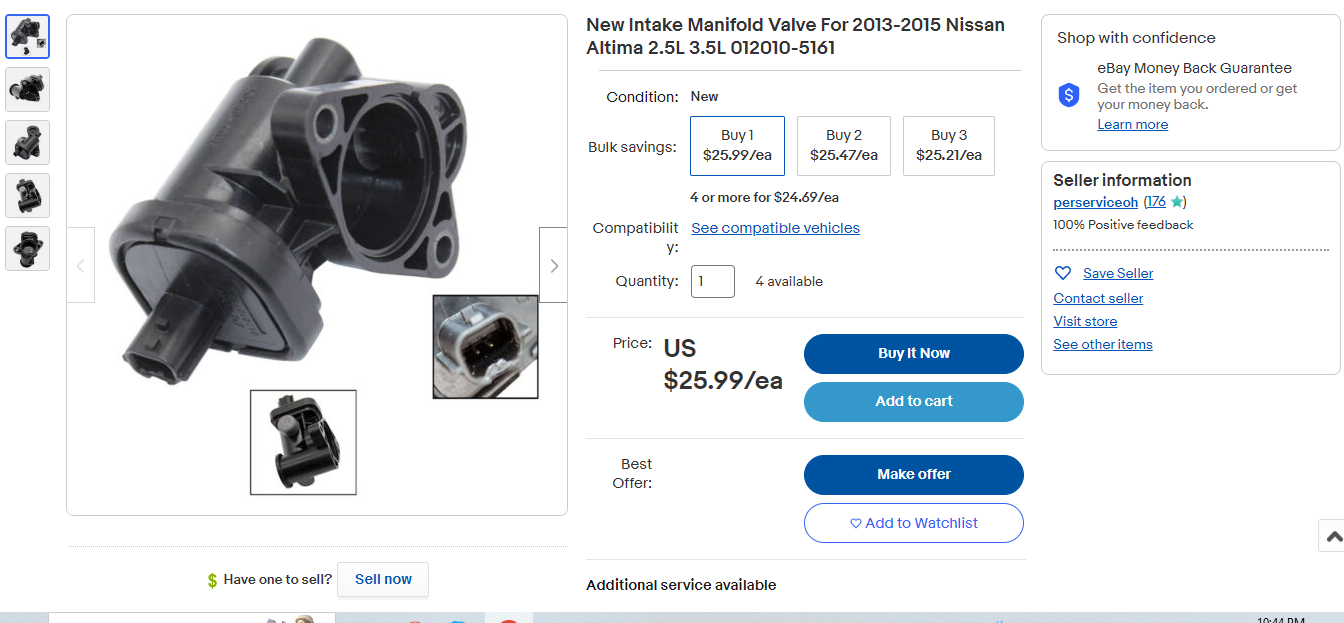

I got the engine light on my car with P2004 code. Got it diagnosed and found that the intake manifold swirl valve malfunctioned. Where can i find this part? Dealership is saying it's in back order nationwide since last 5 months now.
Mar 6, 2023 at 6:35 AM
  • 110,244 POSTS
They have been on backorder. Because of that, the only suggestion is to see if you can find a good one from a salvage yard.

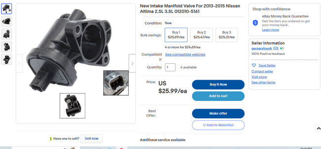

You should be able to find one online as well. See the pic below from Ebay. The actual part is called an intake manifold runner control valve. You can confirm it with the dealership, but I believe the OEM part number is 012010-5160. If they do confirm that this is correct, the part below will work and there are many other suppliers that have it available.
Let me know what you find or if you have questions.
See pic below.
