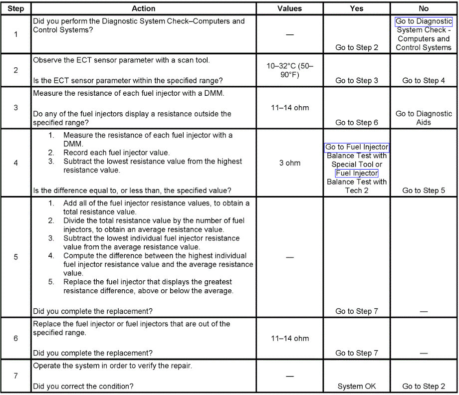

had a code p306 replaced the coil pack ,plug still had problem.
-replace injector
truck ran great for about2 days
then had p0200 pop up drove truch about 50 miles now running rough and code p0302 shows up ??
any ideas???
thanks
Apr 29, 2020 at 7:32 AM
  • 110,248 POSTS
It sounds like the injector in cylinder 2 has now failed. The power-train control module (PCM) enables the appropriate fuel injector pulse for each cylinder. Ignition voltage is supplied to the fuel injectors. The PCM controls each fuel injector by grounding the control circuit via a solid state device called a driver. The PCM monitors the status of each driver. If the PCM detects an incorrect voltage for the commanded state of the driver, DTC P0200 sets.
Now, chances are it is the injector. Follow the diagnostic for the injector driver tests in pic 1. Let me know what you find.

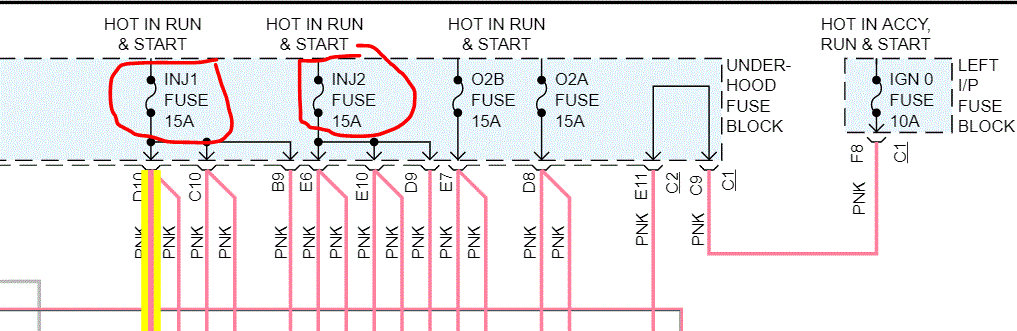

Since having injector #6 replaced if truck sits for 3-4 days batter goes dead?? Could this be related or just a coincidence?? Batter is good charging system working??
Apr 30, 2020 at 3:15 AM
  • 110,248 POSTS
There could be something causing a power draw. You could pull the injector fuses and see if still goes dead. I attached a picture to help locate them.
Let me know if that helps.
