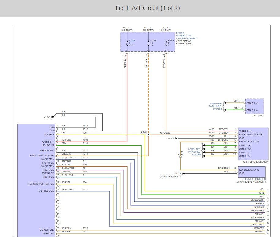

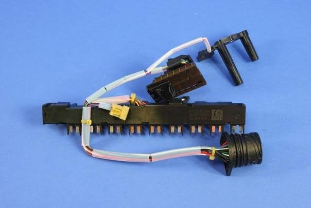

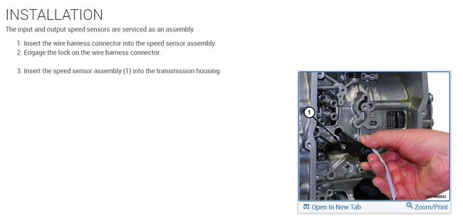

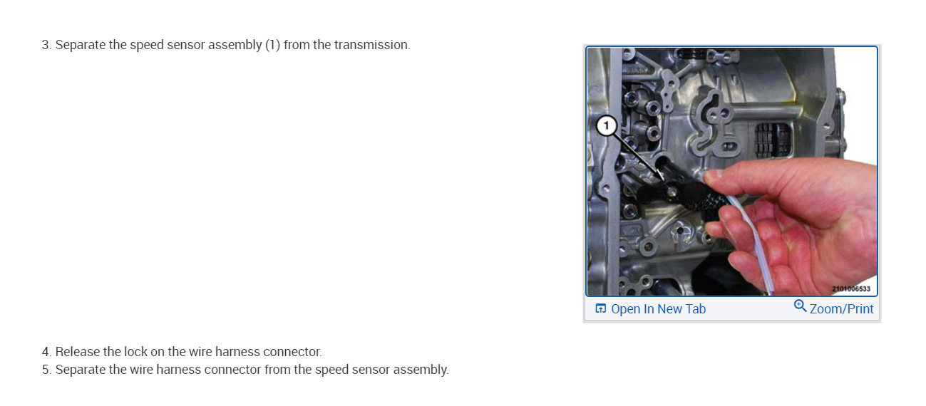

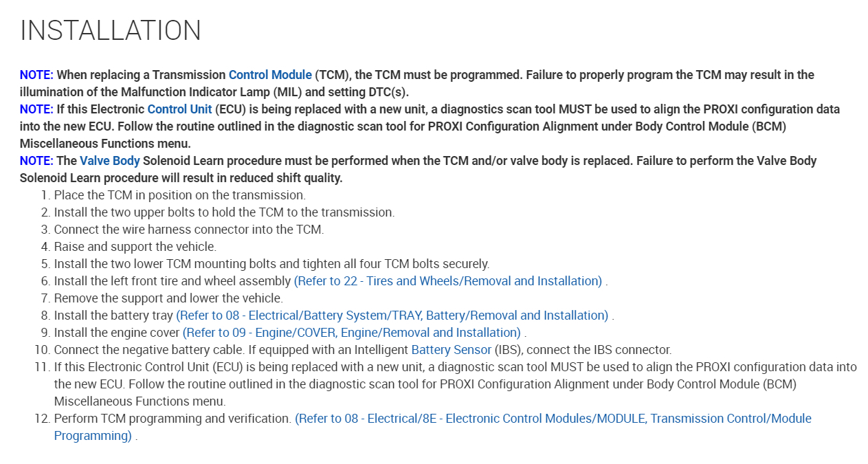

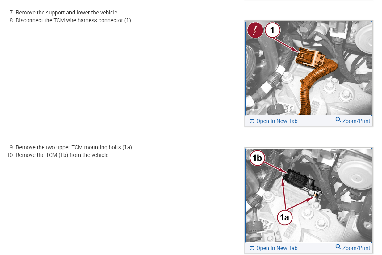

It sounds like the TCM is going out or the input shaft speed sensor is not working correctly. For this problem you can get a CAN scanner from Amazon for about $30.00 here is a video to show you how. This can tell more of what's going on than a regular code reader.
https://youtu.be/u-4syLc-ifQ
Here is a scanner link:
https://amzn.to/3o41KcZ

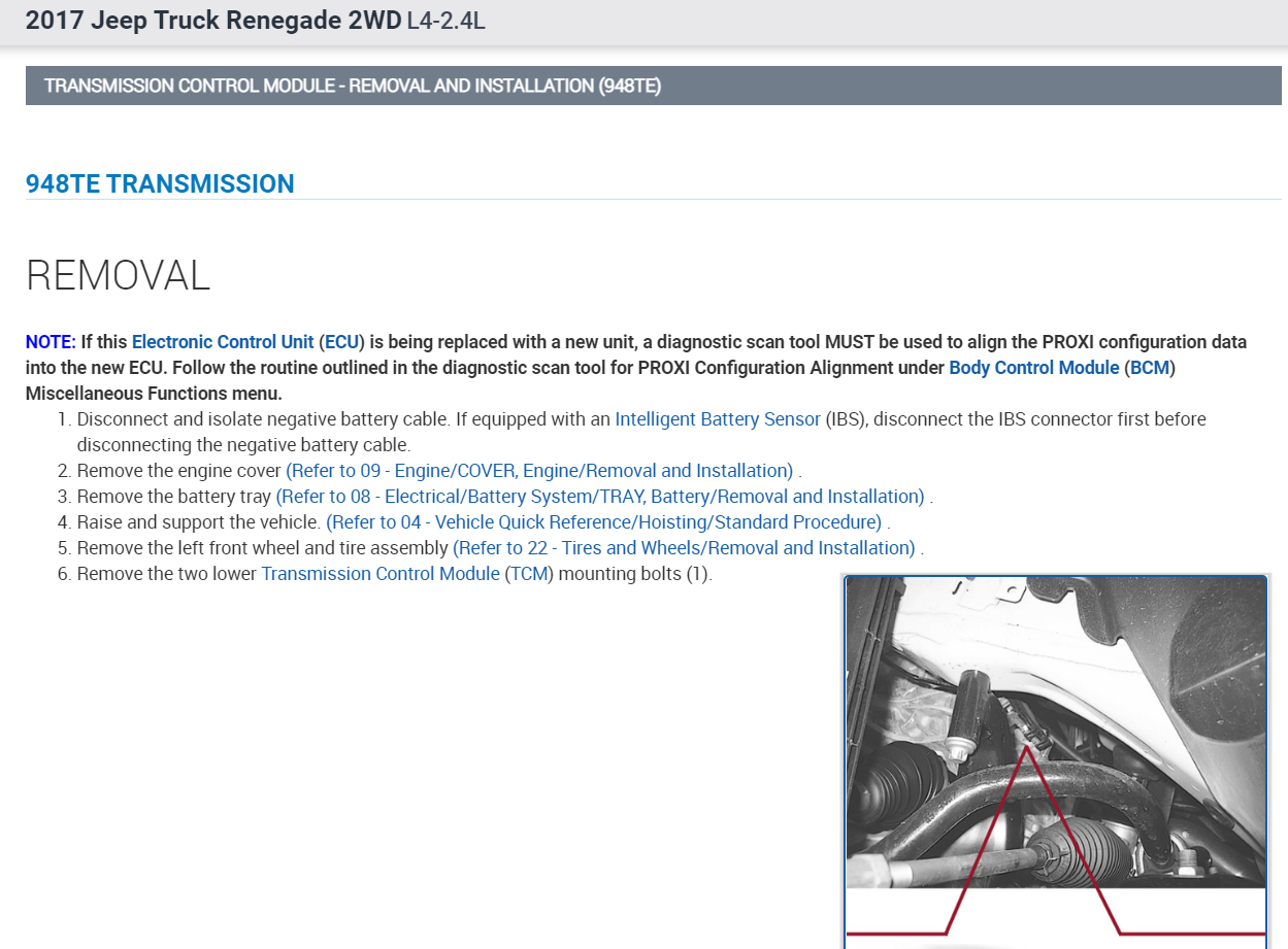

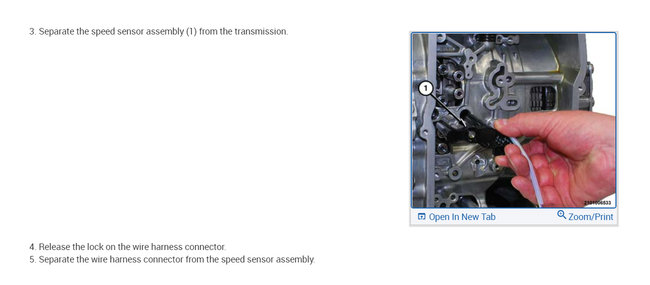

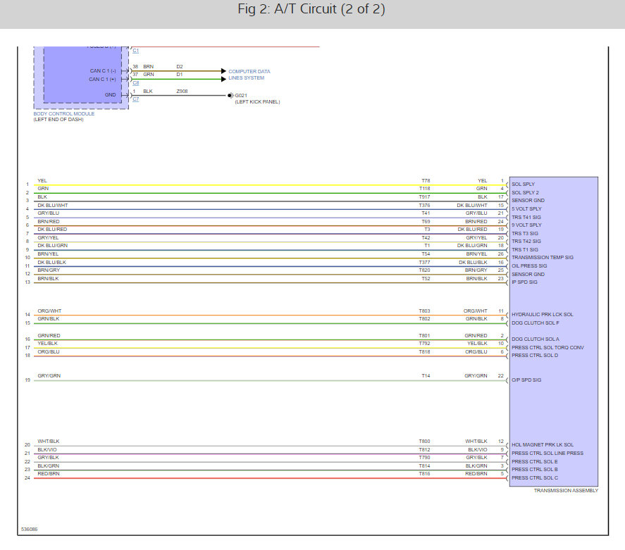

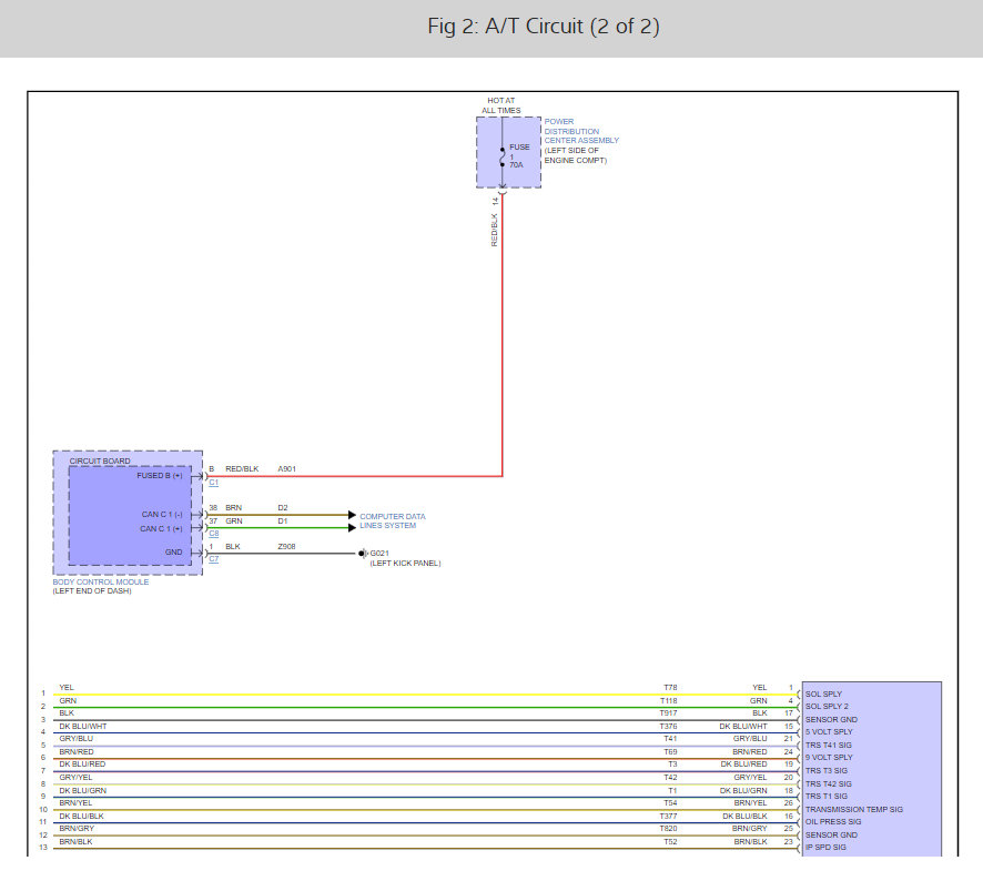

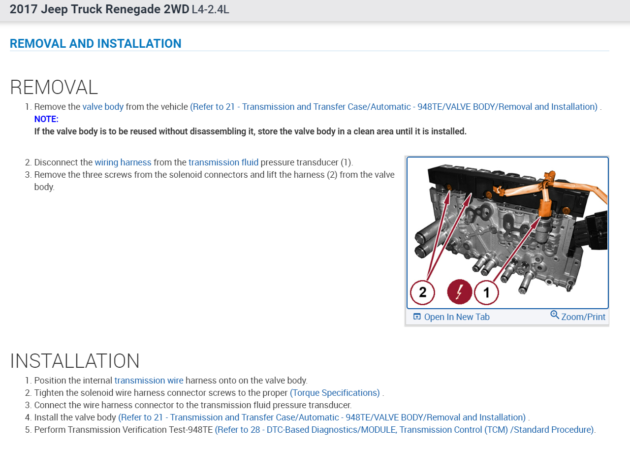

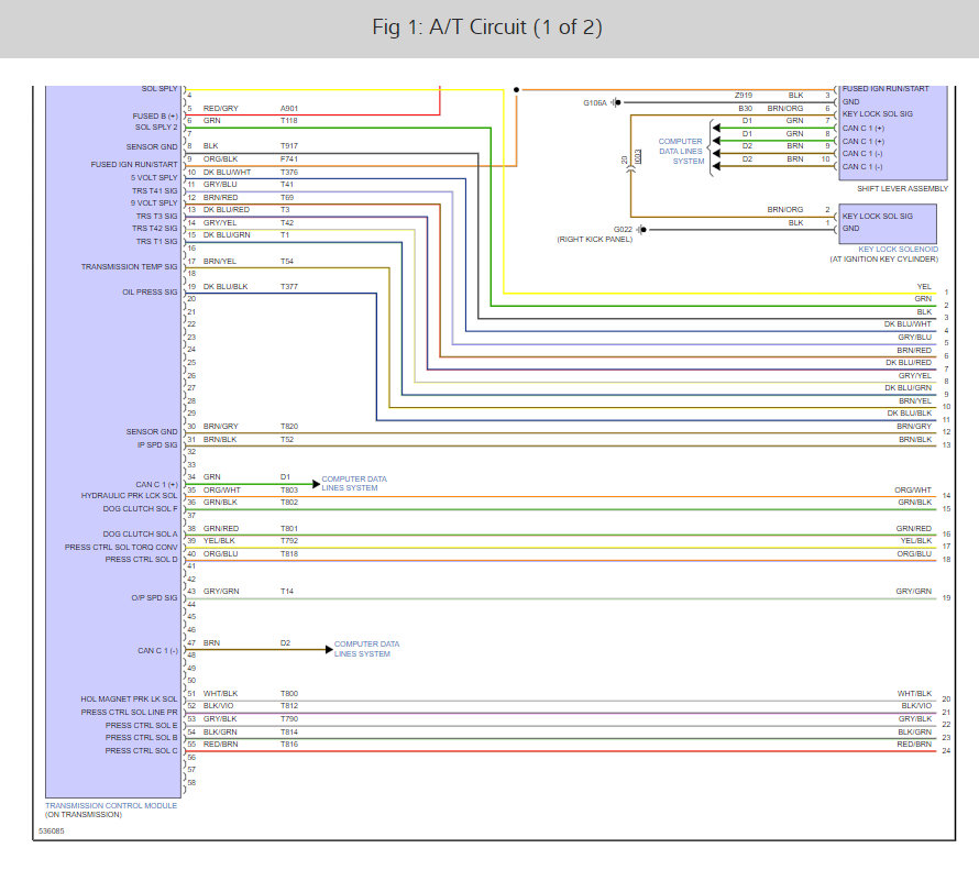

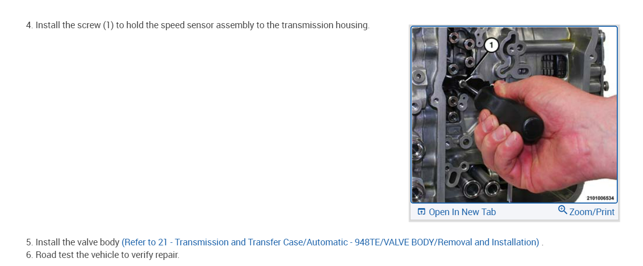

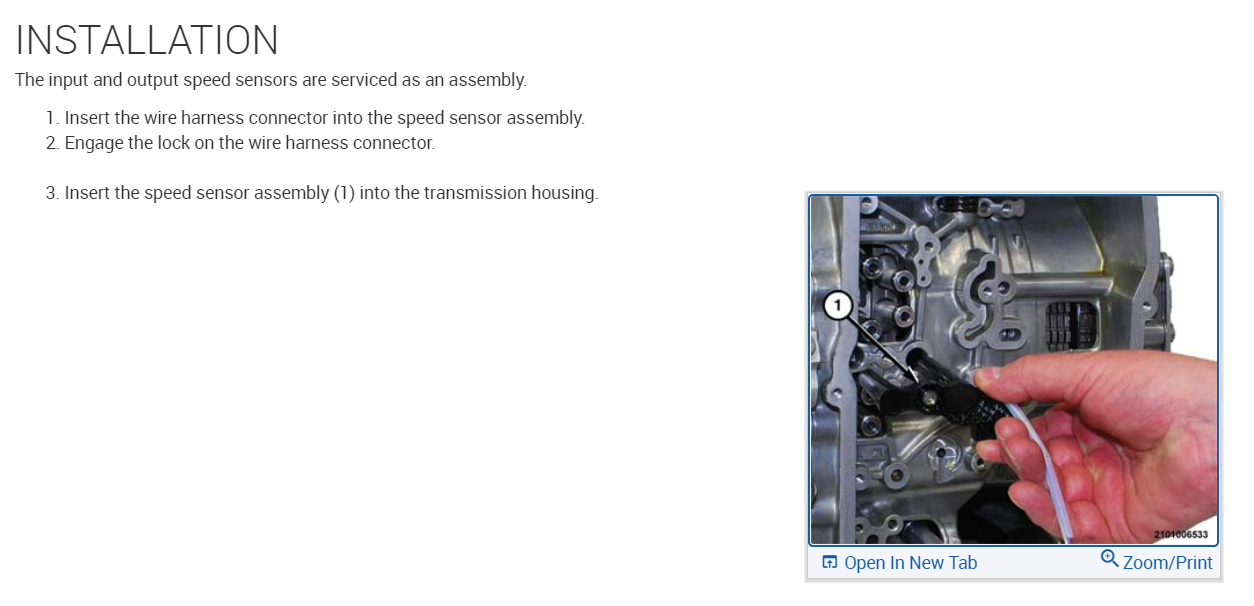

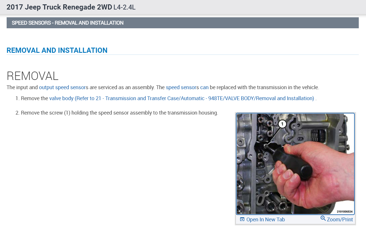

Here are the instructions on how to replace the TCM and input shaft speed sensor in case this is what comes up in the diagrams below. Also, I have included the transmission wiring diagrams so you can see how the system works. Also, because the TCM is mounted with the electrical connector pointing upwards I have seen water get into the connector causing corrosion which can cause all kinds of issues. Remove the connector to check.

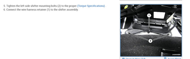

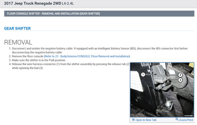

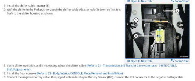

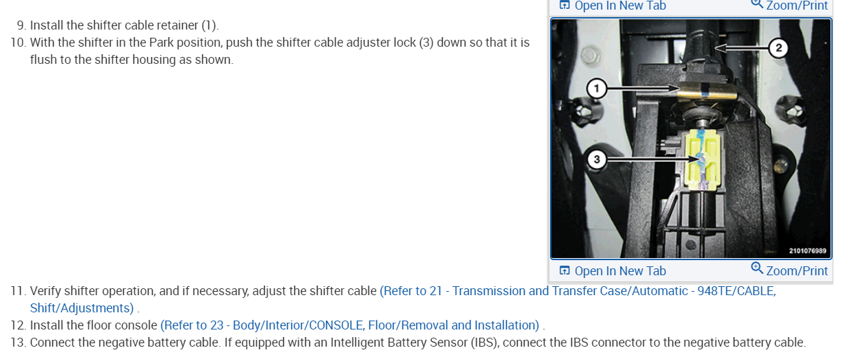

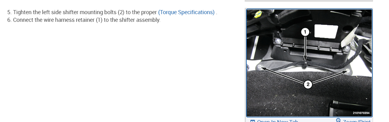

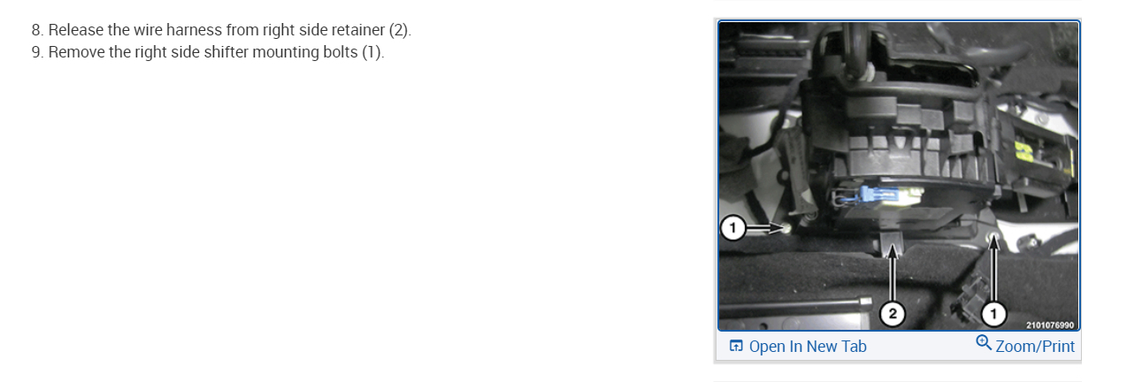

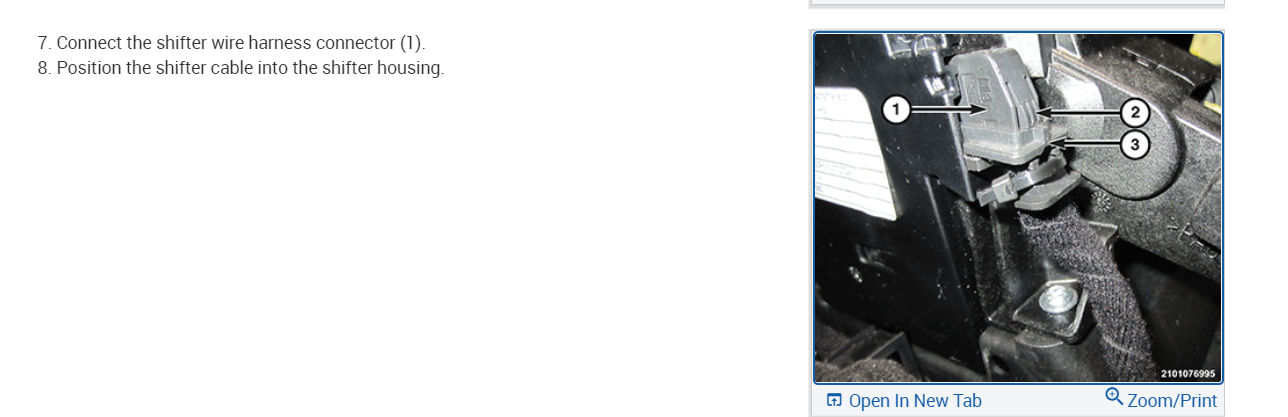

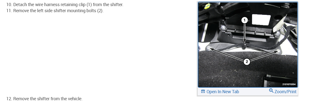

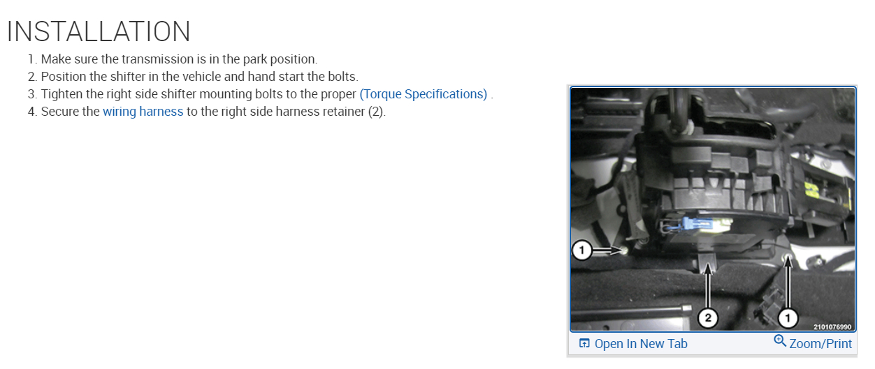

We like to keep all conversations on the site so others can benefit from it. The code P1C9D is for the Gear Shift Position Sensor which is in the shift lever. Here is the location so you can check out the connections and connector. Check out the diagrams (below). Please let us know what happens.
Jul 16, 2022 at 4:05 AM

Can you send pics of location in c635 transmission?
This sensor location above transmission or attached to valve body?
Jul 16, 2022 at 9:57 AM
  • 55,433 POSTS
The sensor is attached to the gear shifter itself.

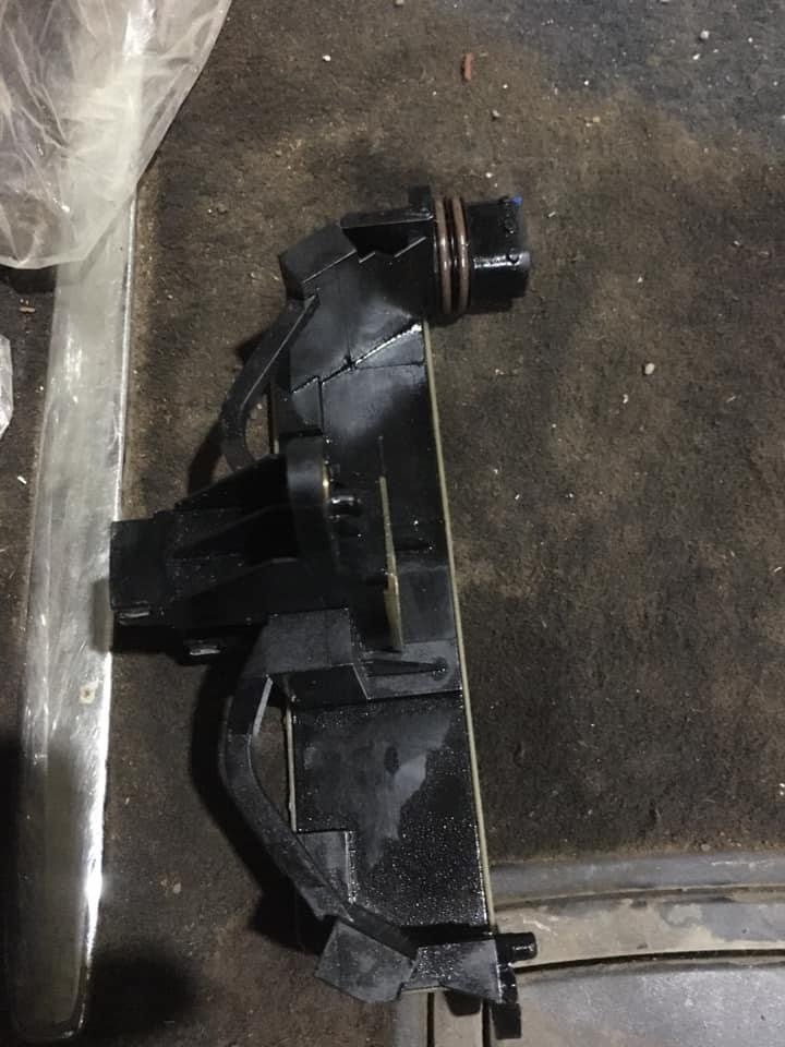

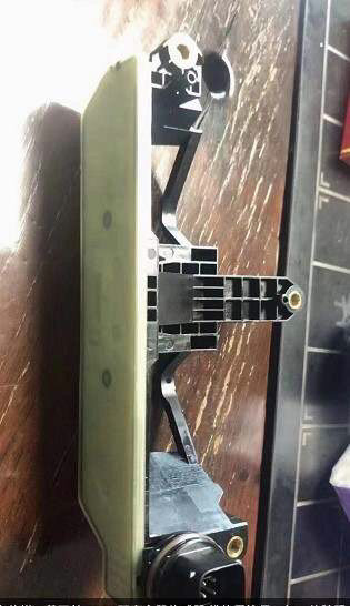

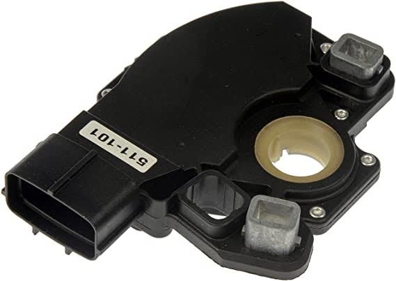

This one ?
Jul 17, 2022 at 10:23 AM
ÃHMèD ÅL-HüSSINI
  • 24 POSTS
Bro, i tried to drive the car today it work normally and no error.
This car will make me mad.
Jul 17, 2022 at 10:47 PM
  • 55,433 POSTS
It is hard to say from the picture the part would need to be removed and matched up, also the switch problem could be intermittent or had a dirty contact and will be okay now. Sometime dirt or dust can get down inside switch and cause an intermitted problem.

  • 55,433 POSTS
I would try Ebay and if not, it will be from the dealer. Here is what the manual says about the conductor plate. Diagrams below.

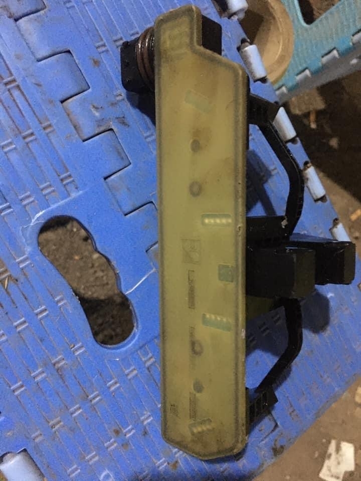

Is gear shift position sensor inside valve body on the conductor plate ???
Jul 24, 2022 at 11:40 PM
  • 55,433 POSTS
Yes, I would clean the contacts in the switch by the steering column. I don't think there are contacts inside the shift plate, I might be wrong though.

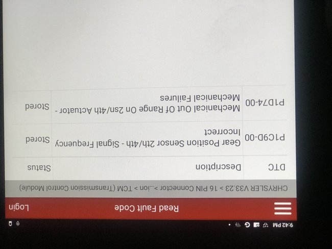

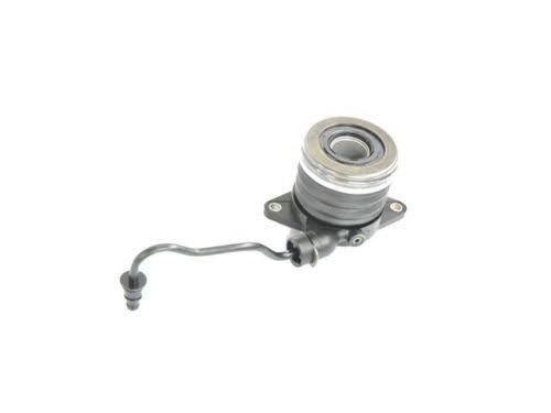

The mechanic asked me if i changed the release bearing before, i said yes because there was a leak, then he asked me if i replaced original new i told him I'm not sure if it was original or not. so, he told me maybe it's not work good and sometimes stuck and appear error code.
(Mechanical out of range on 2nd-4th actuator)
P1D74
And p1c9d (2nd-4th gear sensor position signal incorrect)
What is your opinion bro?
Jul 29, 2022 at 3:42 AM
  • 55,433 POSTS
Those are pictures of a throw out bearing for a stick shift car?

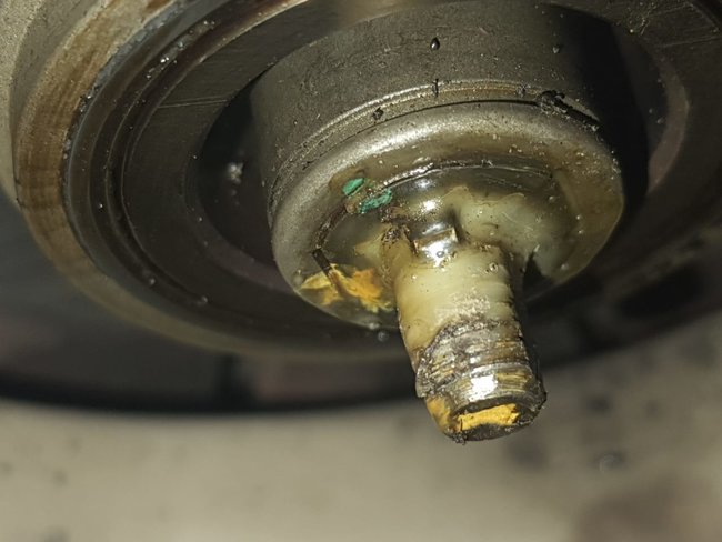

My mechanic found that the old mechanic who worked in it before making big problems by adding glue material to hold the bearing he decided to rebuild it again.
Jul 30, 2022 at 8:44 AM
  • 55,433 POSTS
Oh man, that doesn't look good, let me know, I feel we are getting closer to fixing it.
Jul 31, 2022 at 6:33 AM
ÃHMèD ÅL-HüSSINI
  • 24 POSTS
He replaced the k1 bearing and this long shaft inside the transmission because the stupid mechanic before put some glue and internal oil seal damaged and there is some oil on the clutch, he told me he thinks after rebuilding the transmission everything will be good and valve body will not need replacing.

Yep, it sounds like a wiring issue, let me know if you need wiring diagrams. Let me know what happens.
