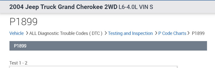

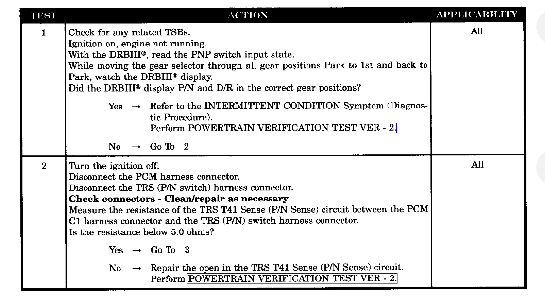

need to know exactly how to change park/neutral switch.
Oct 28, 2019 at 1:22 PM
SCGRANTURISMO
  • 4,897 POSTS

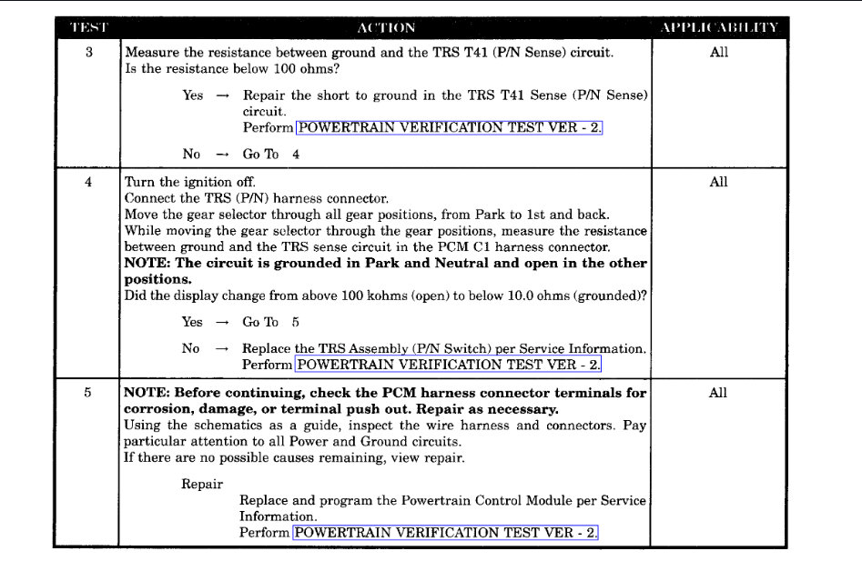

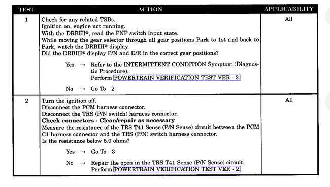

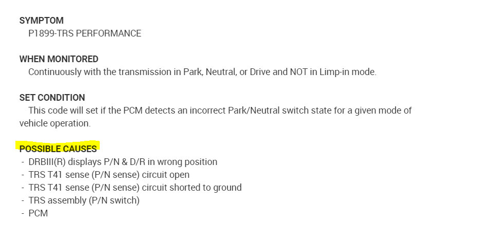

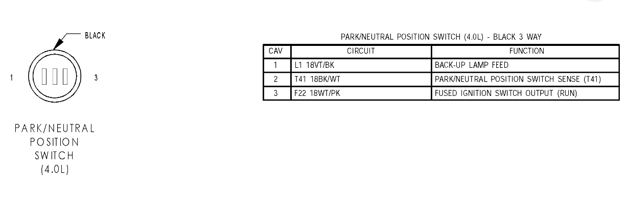

Unfortunately the vehicle manufacturer does not provide this information in either of the two reference guides that we work with. However, I can offer you the diagnostic troubleshooting guide from the vehicle manufacturer for Direct Trouble Code [DTC] P1899, which I have included in the diagrams down below. Please go through this guide and get back to us with what you are able to find out.
