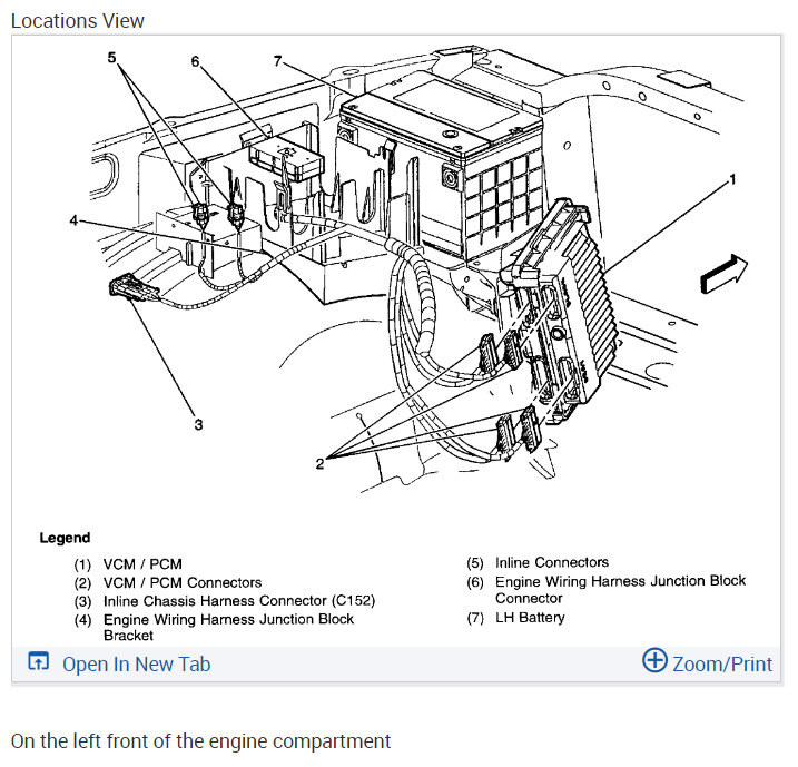

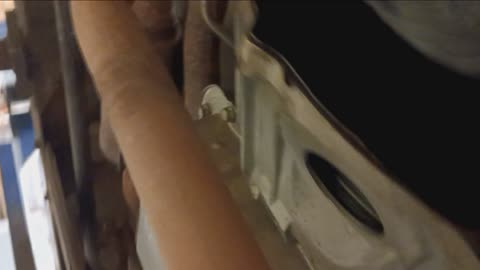

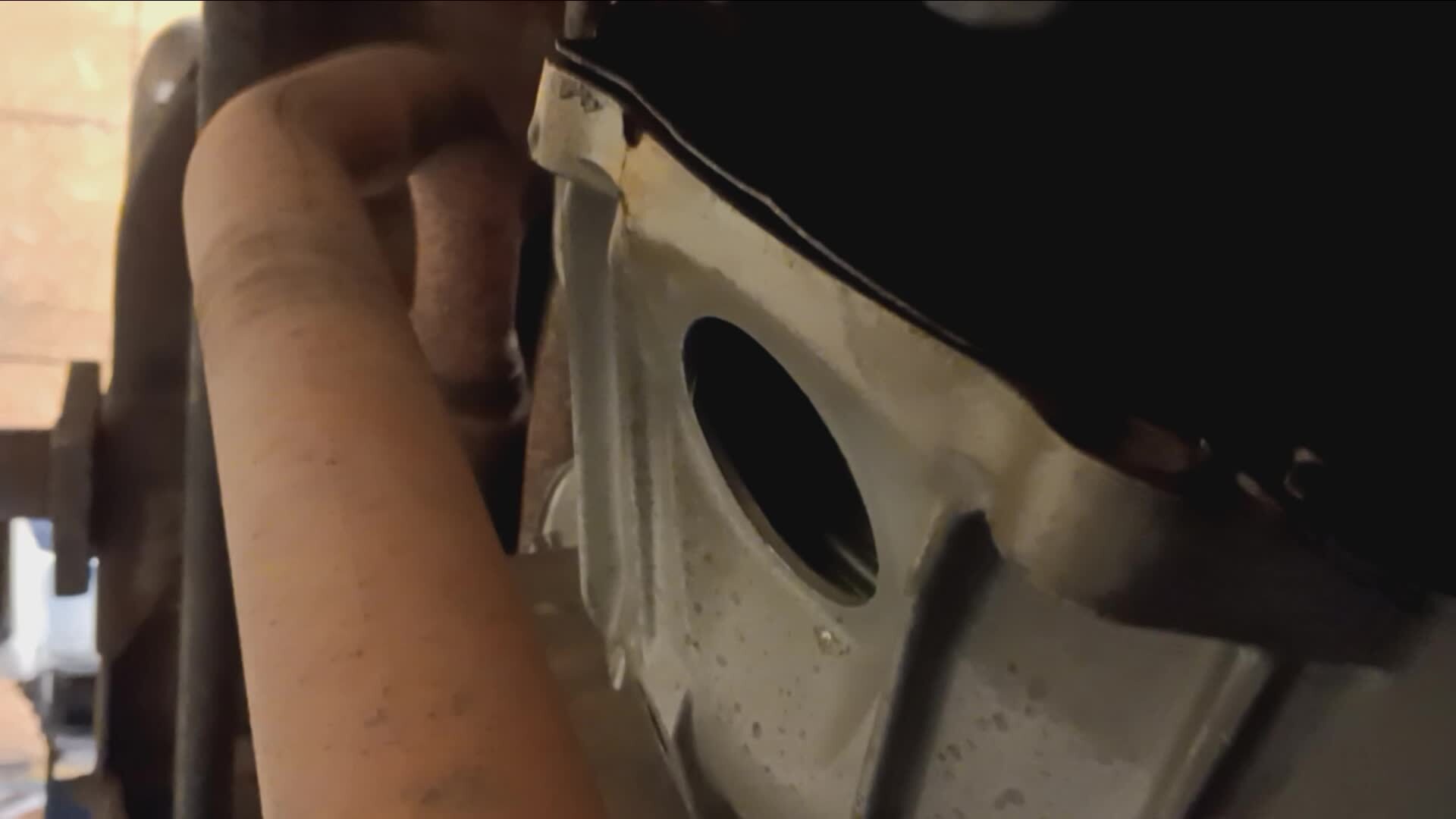

The vehicle listed above is a z71 old model. i just installed a brand-new rebuilt transmission. This is the second one in just a few months. when i clear the DTCs the noise it is making goes away for a few seconds. so, i know the transmission is good. its giving a p1860, p1626, p0785, p0740. please help.
Jan 28, 2024 at 10:02 PM
  • 55,433 POSTS
Can you please shoot a quick video with your phone so I can hear the noise? That way I can tell for sure what's going on. You can upload it here with your response. We need to hear the noise, so we know which direction to go to help you fix the car. It takes time to upload so please be patient.
P1860 - TCC PWM Solenoid Circuit Electrical
P1626 - Theft Deterrent System Fuel Enable Circuit
P0785 - Shift/Timing Solenoid Malfunction
P0740 - Torque Converter Clutch Circuit Malfunction

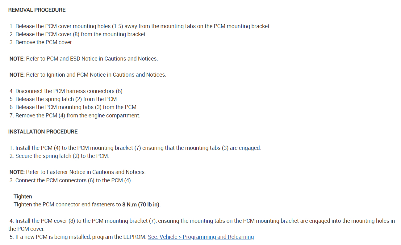

With these codes I would check the electrical connector at the transmission make sure the connector is free from dirt and that it is in good shape and fully secured. If so then the problem is inside the transmission. I would get a rebuild valve body to install, if you know the transmission is good, I would replace the PCM with rebuilt unit but check the electrical connectors first. You can get a preprogrammed unit by searching Google or Ebay. Check out the images (below). Let us know how it goes.

Thanks for the video. if the codes come back that fast it is a hard code. How is the condition of the transmission electrical connector? Also did the vehicle have these codes before you started the repairs?

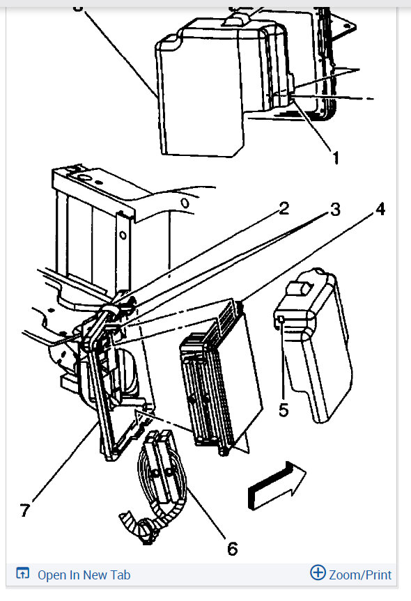

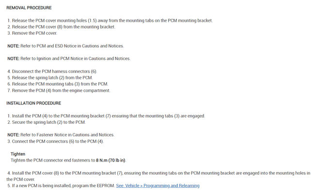

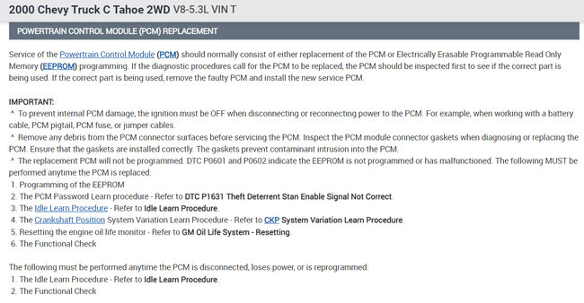

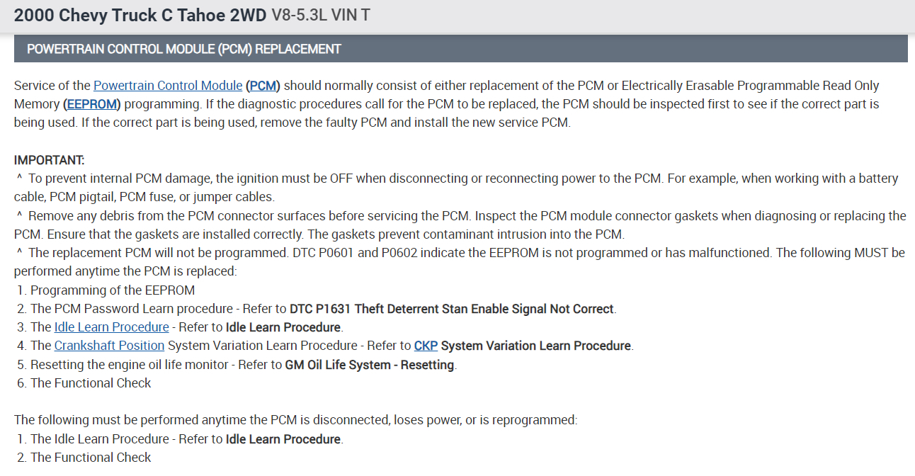

Okay, I would try the PCM then, let me know please.
Feb 5, 2024 at 2:35 AM
EARL91
  • 88 POSTS
I replaced the PCM no change. i have no idea what it could be. i hope they didn't send another transmission with issues.

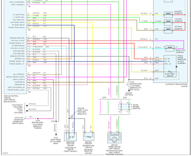

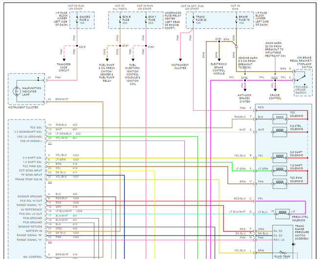

  • 55,433 POSTS
I would try a new wiring harness if this has been the same problem with a different transmission. To be sure you can check the wiring by following this guide. You should be able to repair the wiring.
Here are the complete wiring diagrams so you can do the testing. Also, double check the fuses in the wiring diagrams for power with the key on. Check out the images (below). Let us know what you find.

So, my gauge cluster does not work. i know in certain vehicles that if the gauge cluster is bad, it will affect the transmission. Do you think this could be the issue?
Mar 8, 2024 at 10:30 PM
  • 55,433 POSTS
Yep, I have seen that as well, the cluster is a part of the CAN network.

I believe it's the wiring that goes to the VSS.
Mar 13, 2024 at 3:34 AM
  • 55,433 POSTS
Put the wiring through the tests in the guide that should help us see what's going on.

EARL91
  • 88 POSTS
It was my gauge cluster. I punched it until it started working. I'm going to get another for when the one i have now goes out fully. Runs better that it has since i got it. Thank you for all your help.
