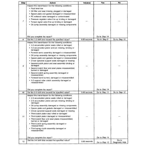

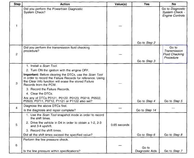

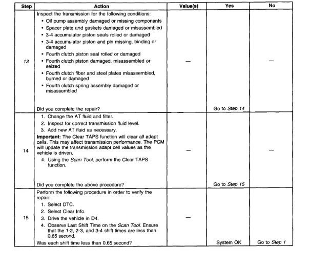

The description is below and the flow chart is there to follow.
Circuit Description
The transmission pressure is modified by an adaptive modifier which controls the shift execution time. This diagnostic tests the time required to accomplish the shift. If the shift takes longer than 0.65 seconds and the adaptive modifier cannot shorten this time, then a counter increases by one.
If the PCM detects a counter value of 2 during one trip, then DTC P1811 sets. DTC P1811 is a type C DTC.

Test Description
The numbers below refer to the step numbers on the diagnostic table.
7. This step inspects components that may cause low line pressure.
9. This step inspects or repairs components that may cause a maximum adapt and long 1-2 upshift.
11. This step inspects or repairs components that may cause a maximum adapt and long 2-3 upshift.
13. This step inspects or repairs components that may cause a maximum adapt and long 3-4 upshift.
