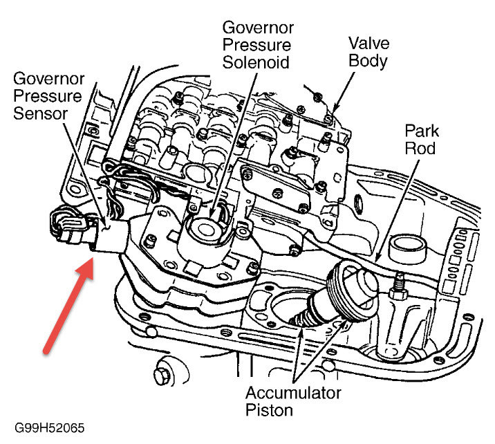

Code P1762
2001 JEEP CHEROKEE
125,000 MILES • AUTOMATIC
DAVEPREWETT
Hi, is it okay to drive until I can get it fixed?

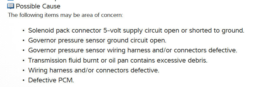

that is the governor pressure sensor problem which is inside the transmission pan. See picture for causes other than that. the pressure sensor is a high failure rate and most dealers stock them auto parts might.
Nov 24, 2016 at 11:13 PM
HMAC300
  • 48,601 POSTS
forgot if it is giving you problems shifting then it will continue to get worse.
