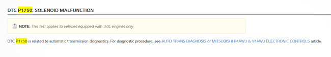

My check engine light came on, so i took it to AutoZone to get checked and a P1750 code came out says it's a A/T Shift, Pressure or Damper Clutch Solenoid Fault. my question is, what is that? Can it be fixed? Can I still drive it?

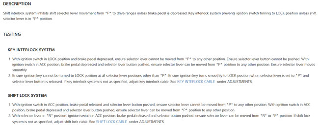

I have included all the information you requested in the diagrams below. Check out the diagrams (Below). Please let us know what happens.
Thanks,
Alex
