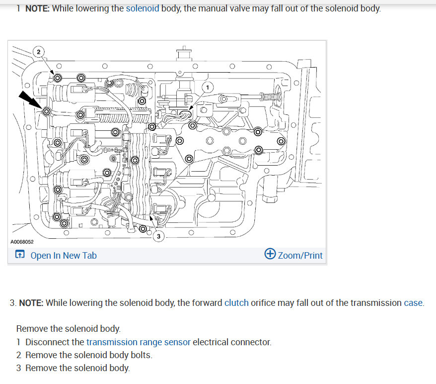

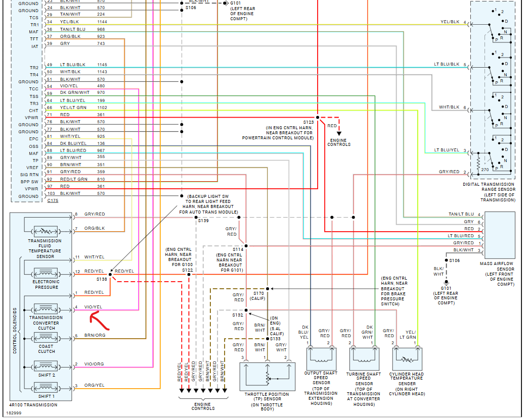

So this means the Torque Converter Clutch is not working, typically the control solenoid needs to be replaced.
P1744 - Torque Converter Clutch (TCC) System Stuck in Off Position
The solenoid is located on the valve body with the vio/yel wire going to it. Here is what I am talking about. Check out the images (below).
