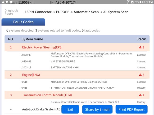

Codes P16E2, P0615, U0100-00, and U0416-68?

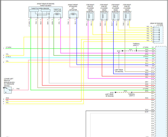

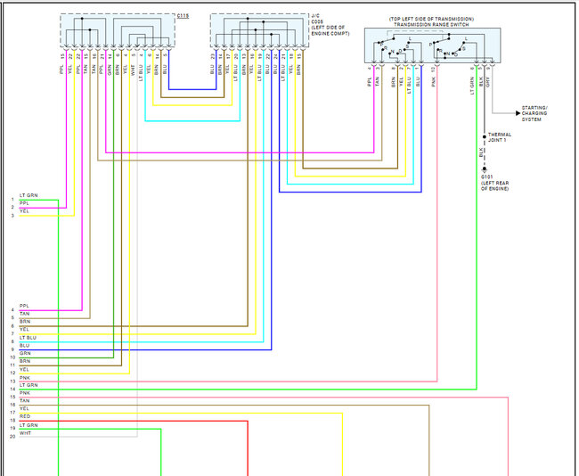

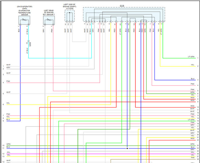

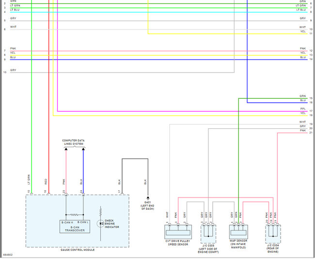

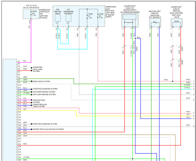

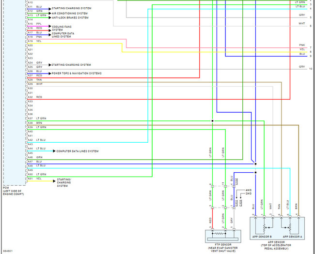

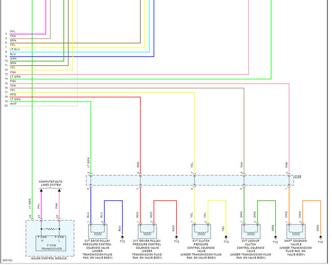

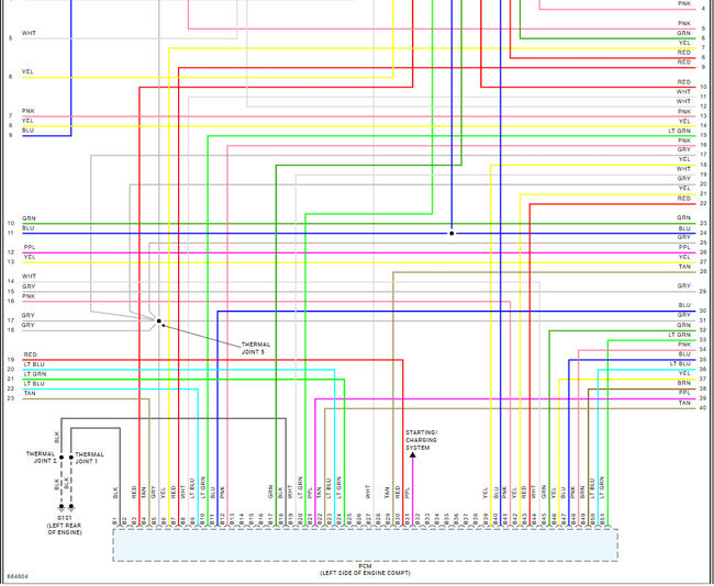

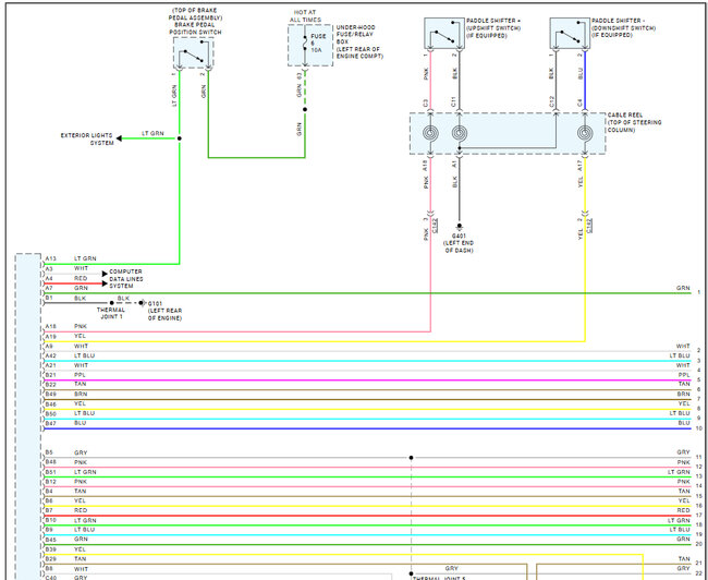

This vehicle transmission CVT chain was broken and there was no place to buy it. The transmission was replaced and the vehicle started disengaging when on drive. Please I need wire diagram from ECM to communication line to check for open circuit. thanks
Feb 27, 2025 at 4:53 AM
MALLYBOY
  • 329 POSTS

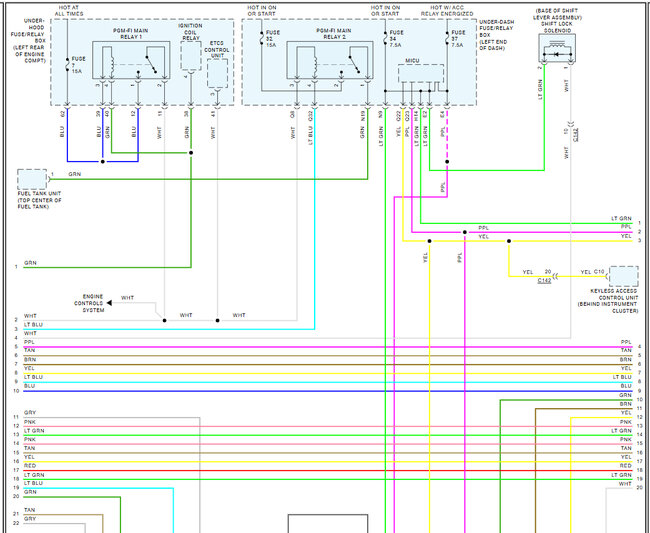

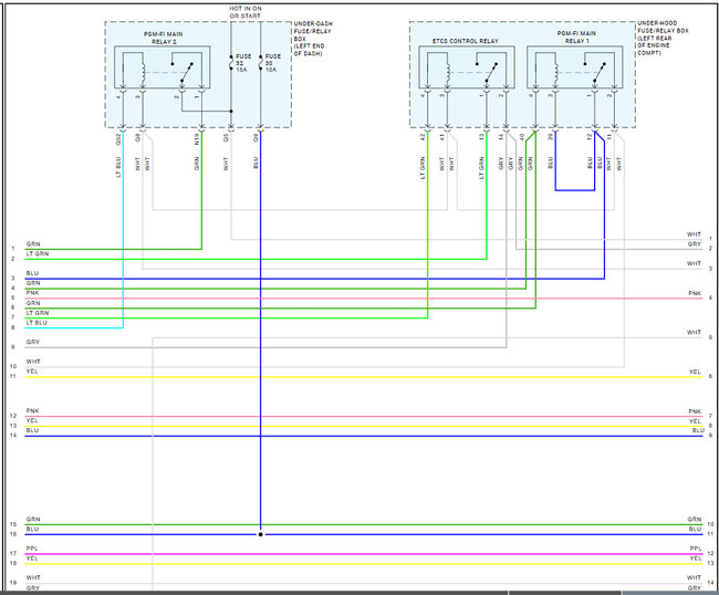

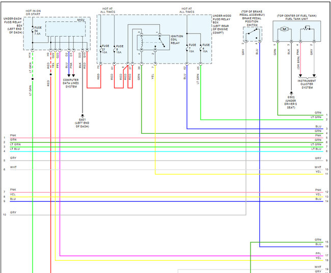

And also fuse box diagram.
Feb 27, 2025 at 6:12 PM
  • 55,816 POSTS

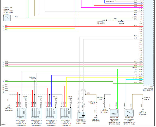

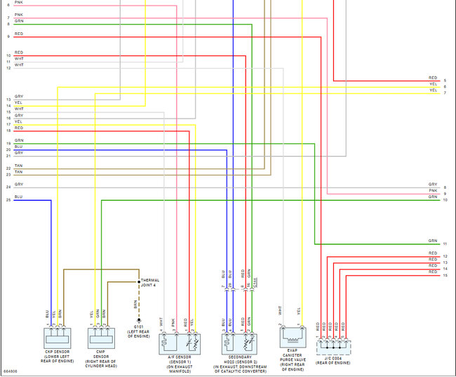

Sure, here are the wiring diagrams for the engine and PCM with a guide to help you test the connections.
Please start a new thread for the fuse panels, check out the images (below). Please let us know what happens.
Feb 28, 2025 at 11:06 AM

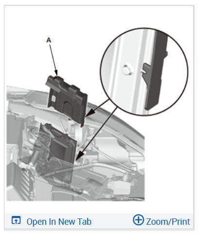

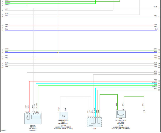

I have check the wiring of this vehicle and correct somethings, but the is still returning P0796: Pressure Control Solenoid C stuck off. Where's the TCM location? Let me replace it and see if it can correct the issue since the transmission has been replaced twice and problem still exist?
Mar 21, 2025 at 2:50 PM
  • 55,816 POSTS
There is no TCM just the PCM. Here is the location, you can get a preprogrammed unit by searching Google or Ebay. Check out the images (below).
Mar 22, 2025 at 4:02 AM
MALLYBOY
  • 329 POSTS
There is no TCM just the PCM, okay.

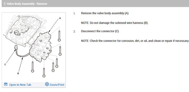

Now since the PCM is returning P0796, and whenever the code appears, the vehicle will disengage from Drive or Reverse until you clear the code before it begins to drive forward or reverse. Please where is the Pressure Solenoid C located so that I can replace it and see whether is solve it?
Mar 22, 2025 at 7:39 PM
  • 55,816 POSTS

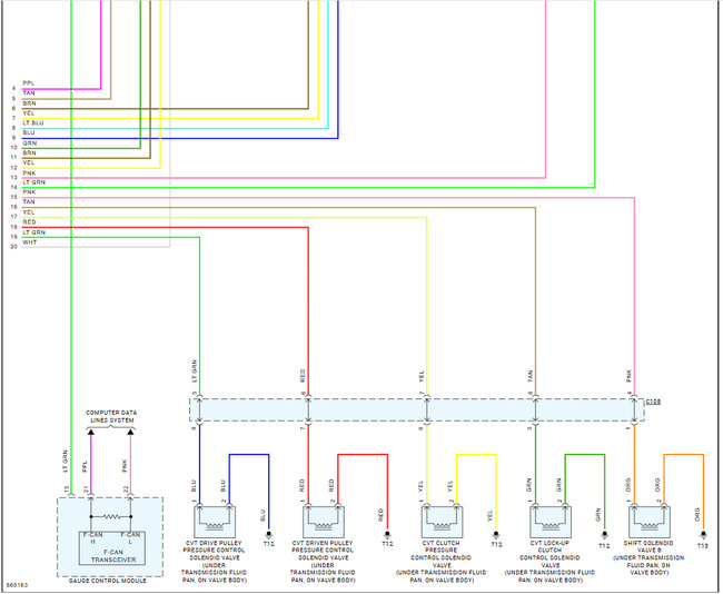

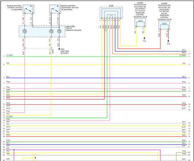

There are 3 pressure control solenoids, here are the wiring diagrams so you can see how the system works and how to remove the valve body to change it out.
https://youtu.be/-iv2yJgVXJM?si=kQgM8pDpI7jknBsC
Check out the images (below). Let us know how it goes.
Mar 23, 2025 at 2:57 AM

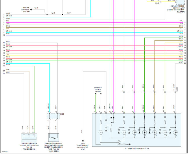

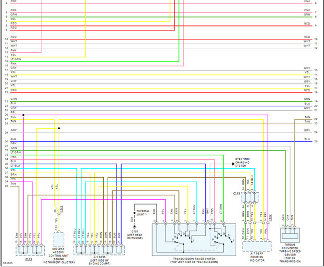

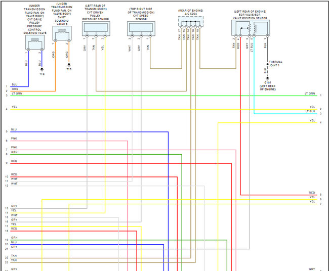

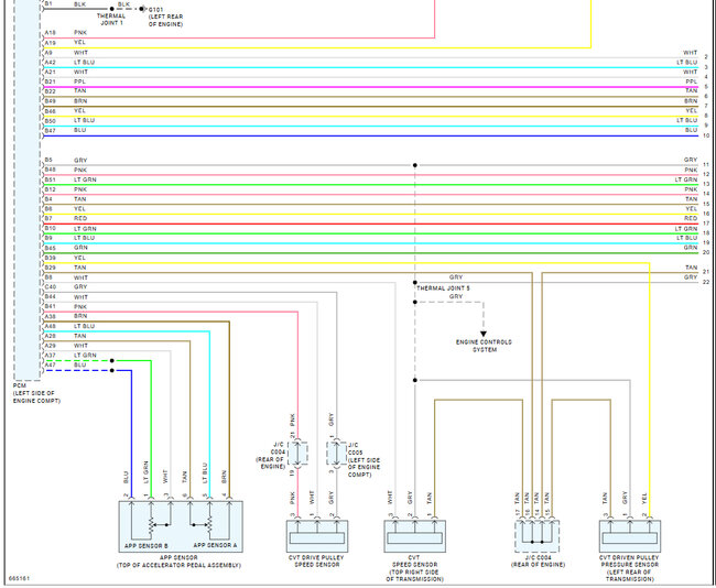

But you didn't specify the particular solenoid for it to be easy. And the diagram was not complete to help me check resistance from PCM? Send a complete diagram to help me locate it?
Mar 23, 2025 at 8:11 PM
  • 55,816 POSTS
Sure, sorry about that, here you go, let me know how it goes. Check out the images (below).

I have replace that pressure control solenoid C and when I was test-driving, the vehicle disengage from Driveand Gear position indicator was blinking at neutral and I scan and it report P0717= Input/turbine speed sensor A Circuit No signal, please where is this sensor located? I attached screenshot below.
Mar 31, 2025 at 5:50 AM
  • 55,816 POSTS
I don't see the image, can you please try again?
Apr 1, 2025 at 1:51 AM
MALLYBOY
  • 329 POSTS
Thank you so far, i have come to tell you that i have solved the problem, that fault code was pointing to torque converter turbine speed sensor. The circuit was interchanged and i used diagram to trace it and solve tjr the problem.
