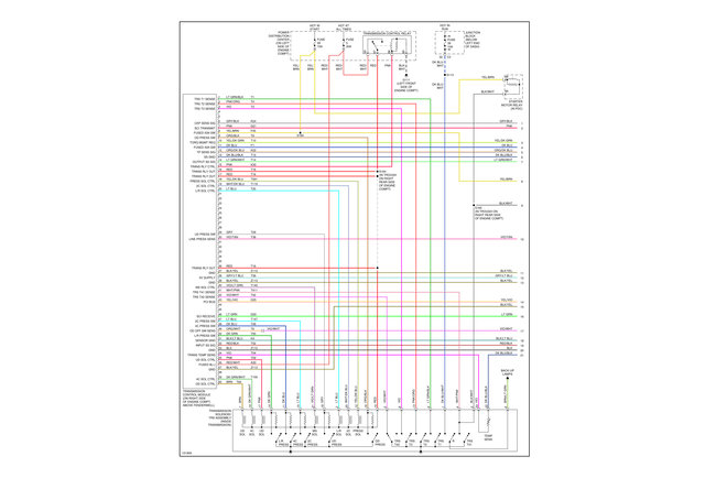

Code P1698, crank not start?
2002 JEEP LIBERTY
183,000 MILES • 3.7L • V6 • 4WD • AUTOMATIC
JAMESD916

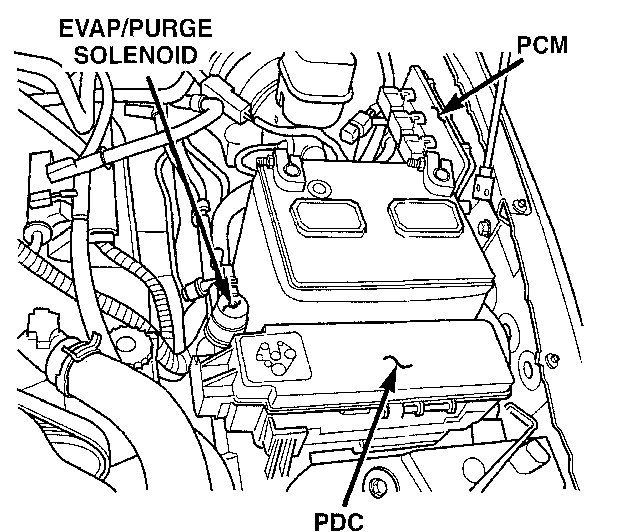

Will not crank turns over but want fire
Says PCU nor talking to TCU.
I've replaced camshaft and crankshaft position sensors.

P1698 - No CCD Messages received from TCM
Bus communication failure to TCM. A Companion DTC was set in both the PCM and TCM.
DTC P1698: No BUS messages received from TCM

Possible Causes
* No Response To TCM
* Open CCD BUS Circuit From PCM To Data Link Connector
* Open CCD BUS (-) Circuit From PCM To Data Link Connector
* Open Ground Circuit
* TCM

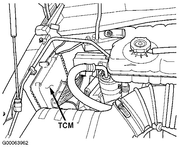

I would suggest to first check 12V supply and ground at the TCM.
The TCM is located on the passenger side engine compartment, see image 5
The fuses are located in the Power Distribution Centre(PDC) at the left front of engine compartment, see image 1

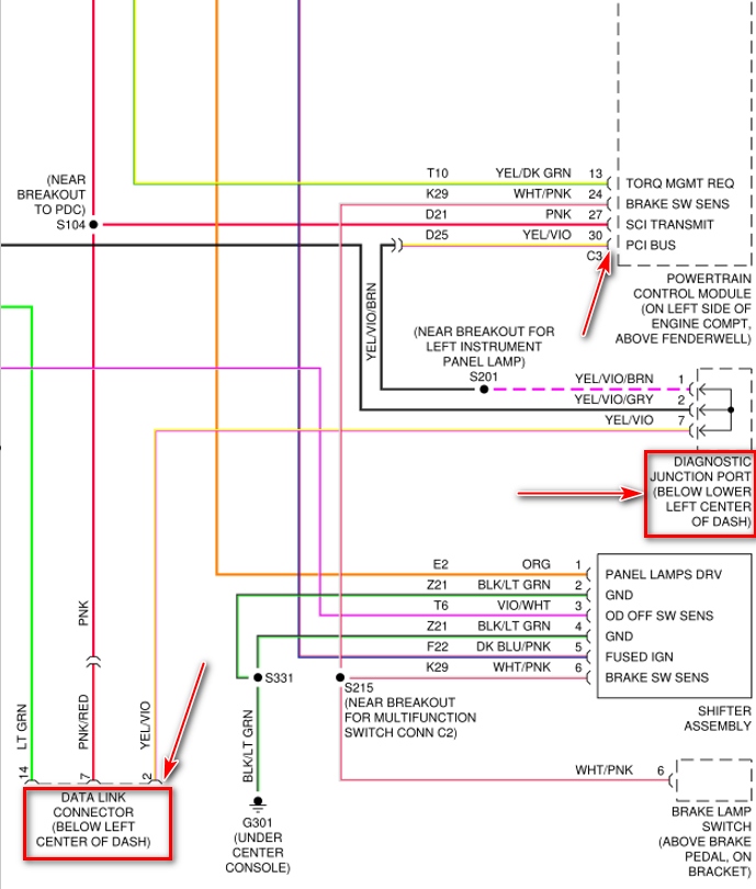

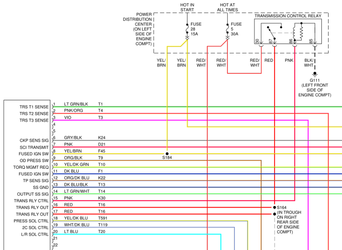

Pin out at TCM
Pin 8, yellow/brown wire ignition in from fuse 28, 15A, in PDC
Pin 37+39, black/yellow wire ground
Pin 56, red/white wire constant 12V feed from fuse 5, 30A, in PDC
See image 2+3 below
Pin 43, yellow/violet wire PCI bus to diagnostic junction port pin 2.
This then links up with PCM pin 30, connector C3, and the OBD connector pin 2
If the 12V supply and ground are good next check the PCI bus from pin 43 out to PCM and OBD connector, see image 4
The 12V and ground can be checked using either a test light or voltmeter
