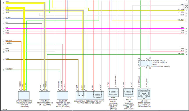

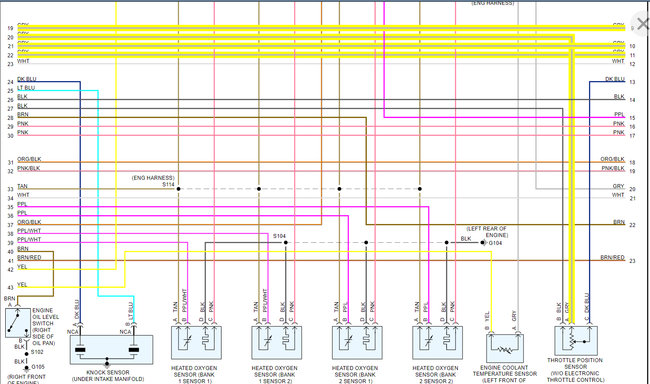

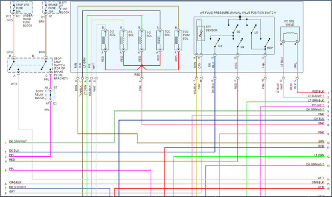

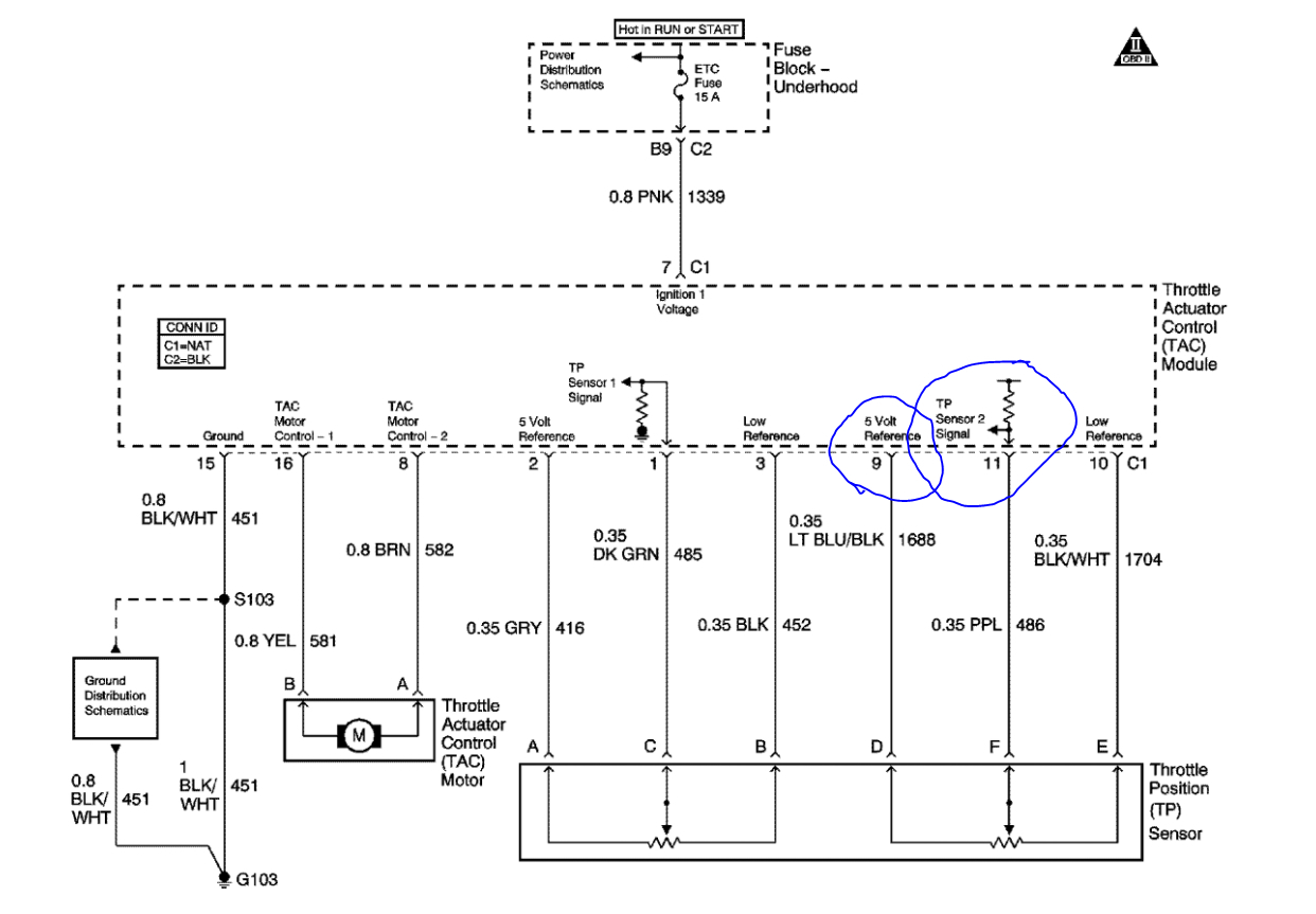

P1639 reading 5 volts at throttle position sensor with truck switched on and about 7.5 to 11.4 with truck running. Trying to find out if I have a short going to ground or a bad PCM.
Apr 25, 2021 at 4:11 PM
Good morning,

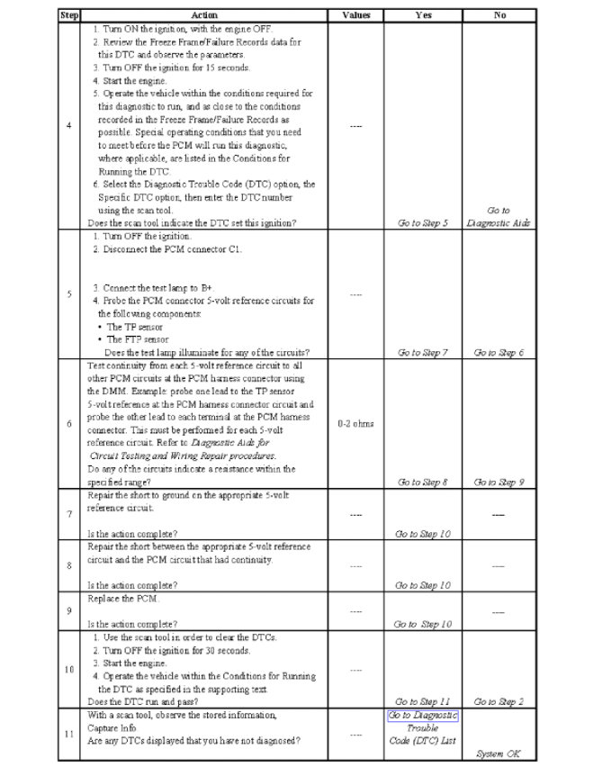

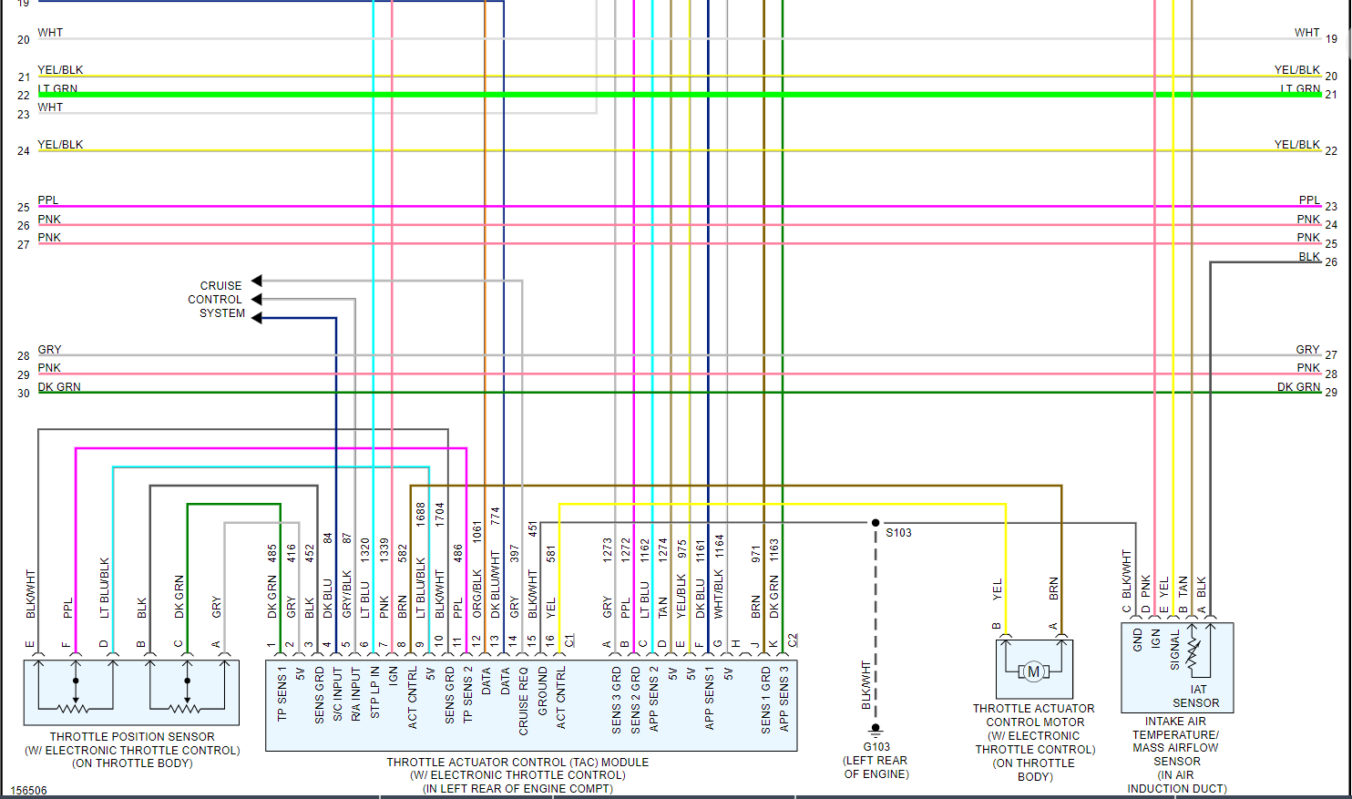

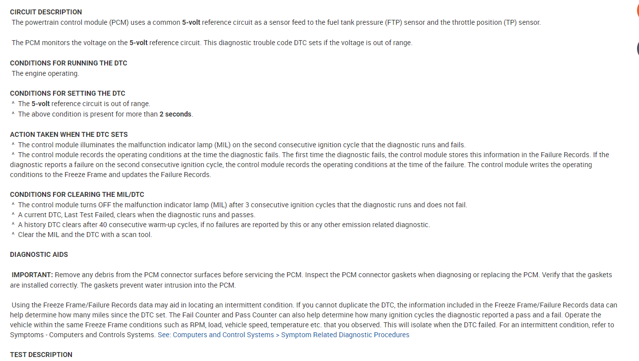

I attached the diagram of the TPS circuit number 2. The reference and signal voltage should only be 5 volts.
What color wire were you testing? I attached a flow chart and description for you. You should not have more than 5 volts.

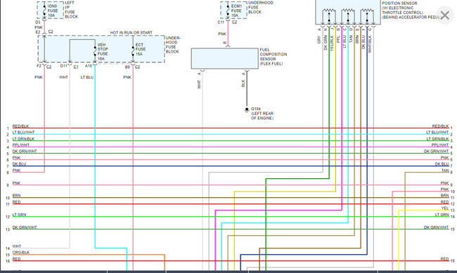

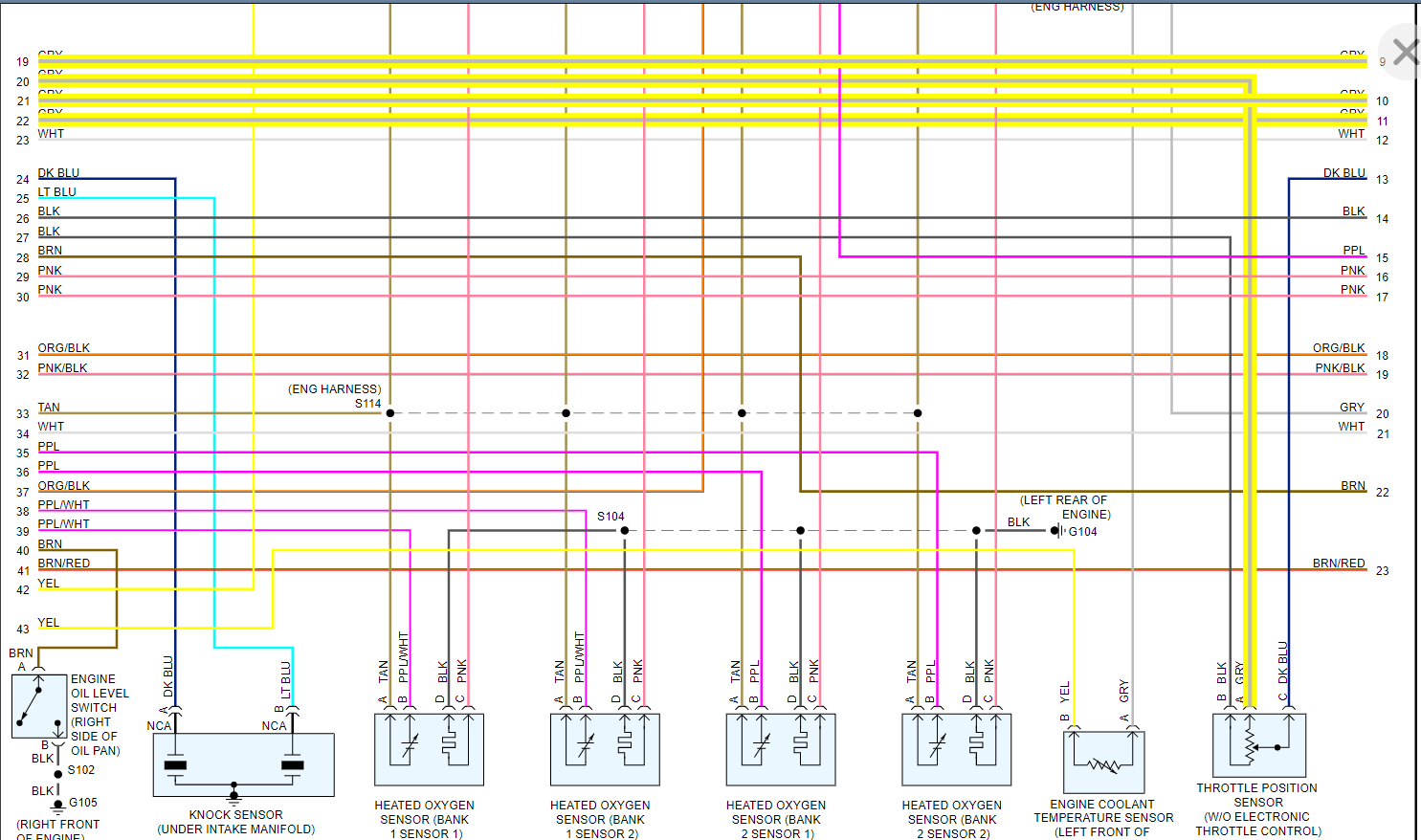

Thanks for the reply. I need to know what other sensor is on the 5v reference circuit 2. Also was thinking that I may have a short to voltage problem instead of short to ground. I have taken the wiring harness apart going to the fusebox and found nothing wrong with the 5v reference wire on my TP sensor.
Apr 26, 2021 at 5:30 AM
All sensors have a 5-volt reference and signal voltage.
All switches and solenoids have 12 volts.
It sounds like you have a wiring harness issue but finding it will be a challenge.
Again, what color wire is the concern?

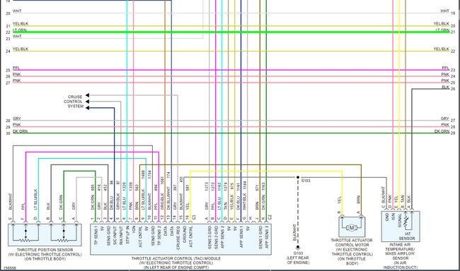

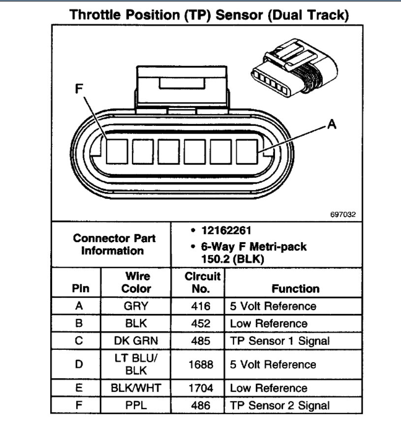

At the TP sensor only a 3 wire sensor. Grey 5v ref black sensor ground blue signal. 2002 has the cable throttle. I just unhooked the fuel tank pressure sensor and my 5v reference at the tp sensor is still high.
Apr 26, 2021 at 7:42 AM
RADJOHN
  • 14 POSTS

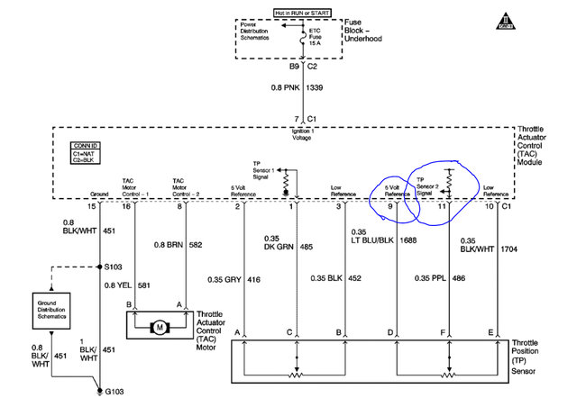

This the 5v reference circuit two. It shouldn't affect the circuit 1 5v reference circuit .
Apr 26, 2021 at 7:43 AM
What do mean by high?
A 3 wire sensor indicates only 1 circuit for the TPS, not 2.

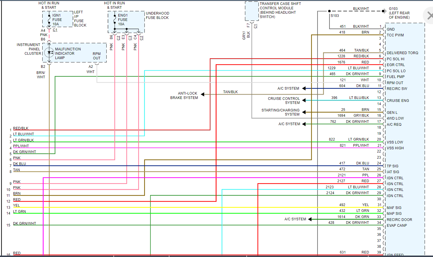

If I can find out all the sensors on that number 2 circuit then I can check the harness going to each one. Any wiring diagram will be very helpful. thanks.
Apr 26, 2021 at 8:18 AM
RADJOHN
  • 14 POSTS

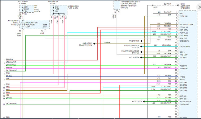

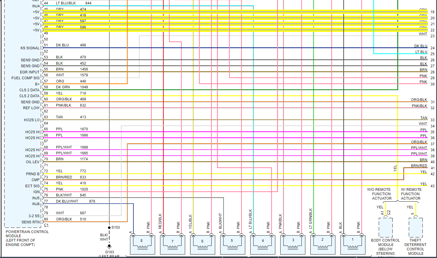

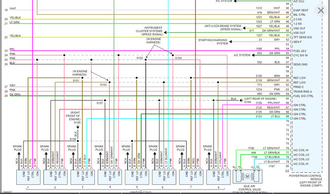

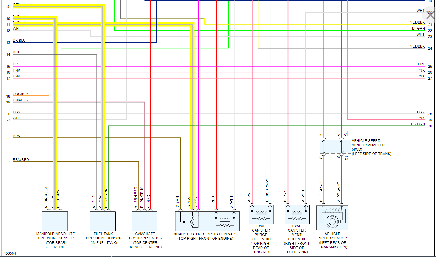

5v reference circuit 2 is reading 8.4 volts. This circuit goes to the tp sensor. Inside the pcm it is connected to the sensors. I just don't know what other sensors are controlled by this 5v circuit .
Apr 26, 2021 at 8:29 AM

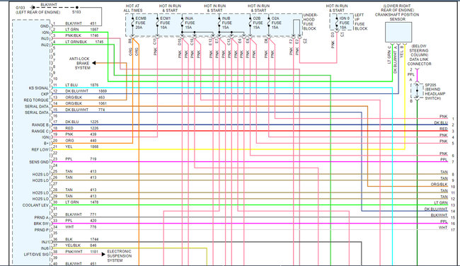

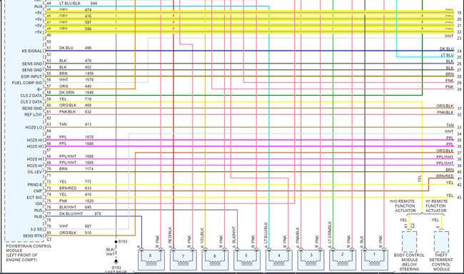

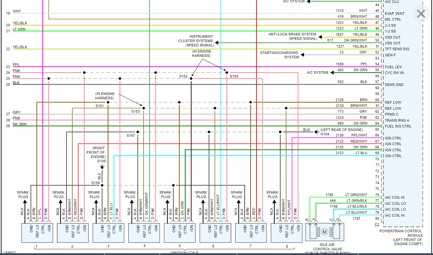

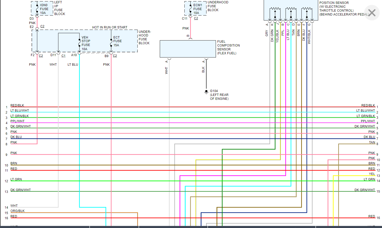

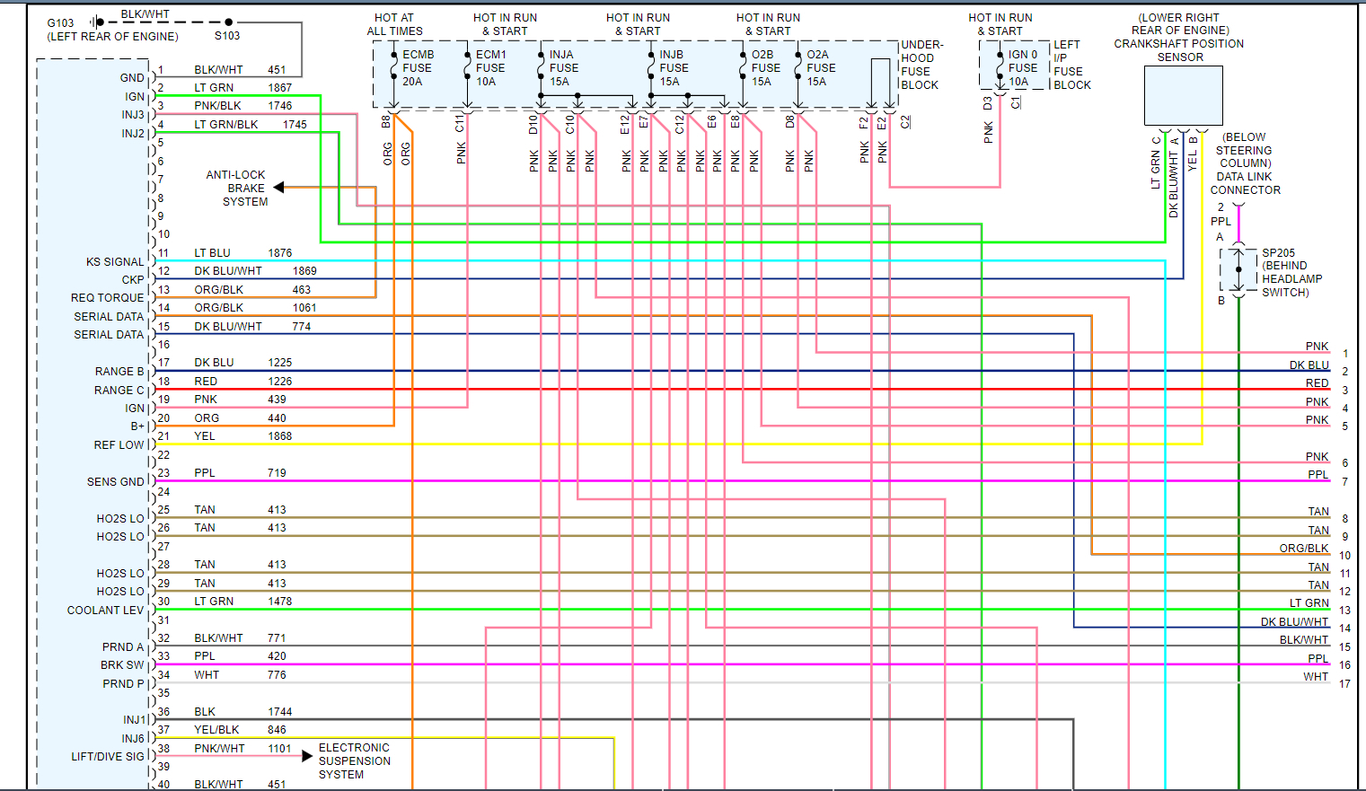

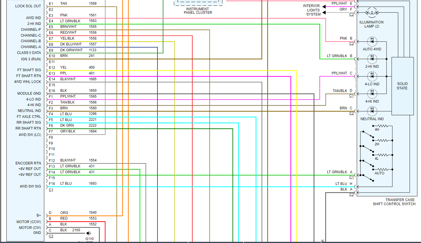

I attached the wiring diagram of the complete system.
Apr 26, 2021 at 8:31 AM
RADJOHN
  • 14 POSTS
Thanks that should help me out. I will have to study it later. I work night shift and about to go to work now. Thanks again for your help.
Apr 26, 2021 at 8:36 AM

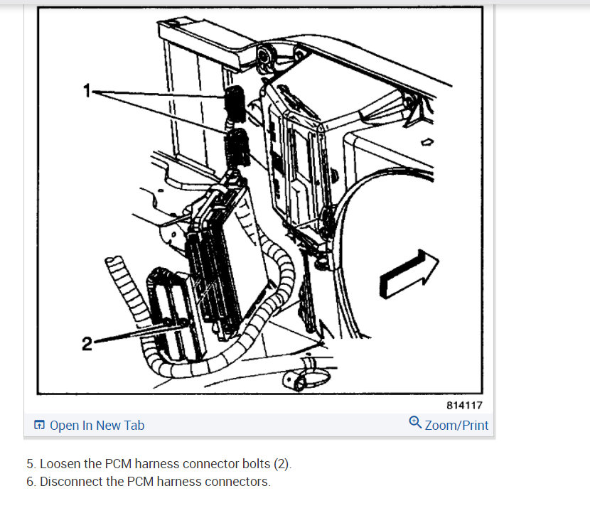

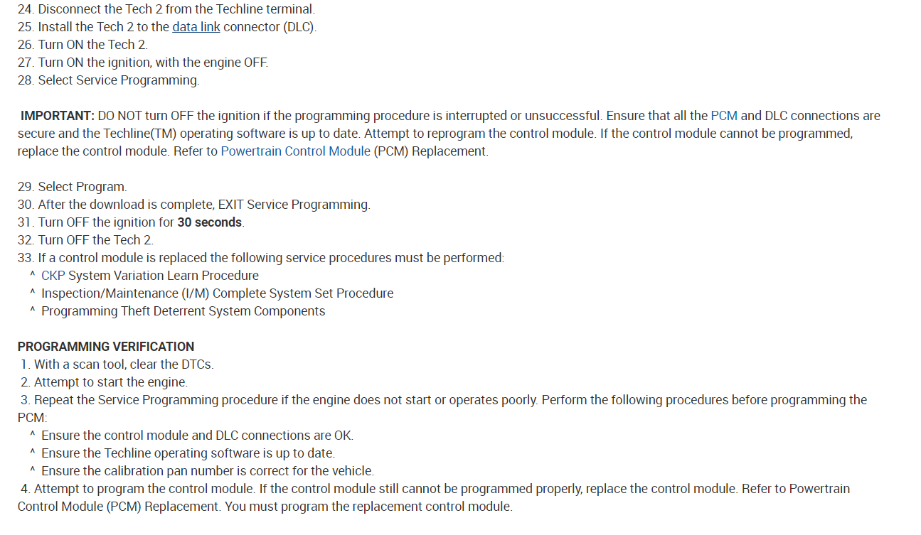

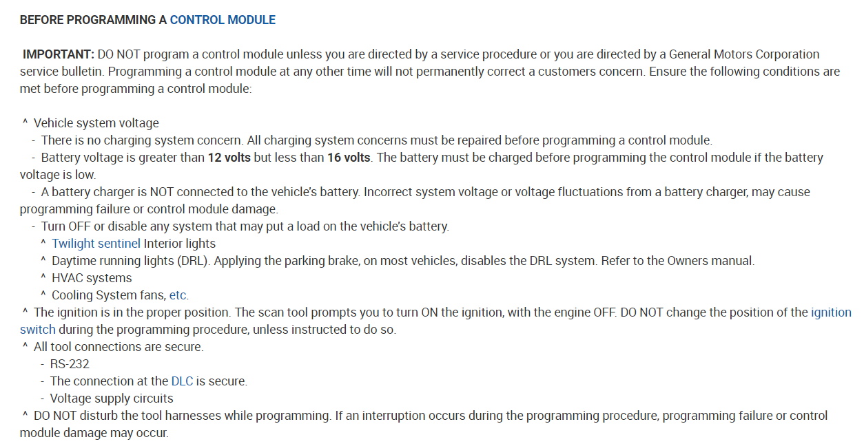

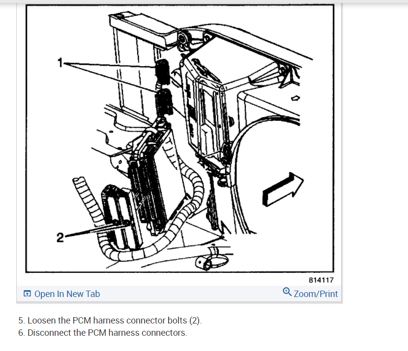

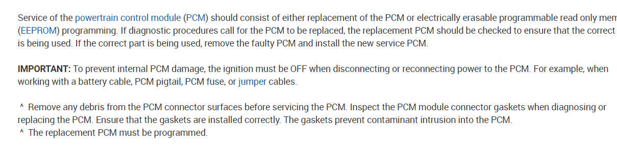

I think that I have a bad PCM at the tp sensor and the fuel tank pressure sensor I have 5v sometimes with key on. I crank the truck and both go to 7 or 8. Switch off truck then back on and voltage doesn't go back to 5. Leave it off for a few minutes and I have 5.
Apr 27, 2021 at 8:49 AM

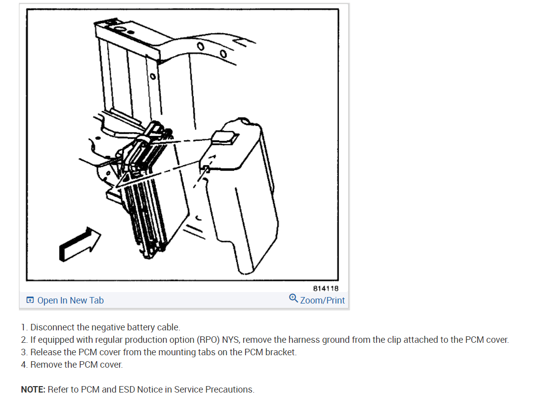

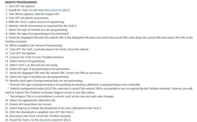

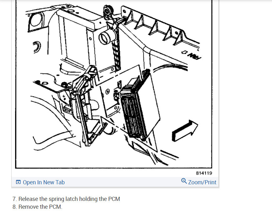

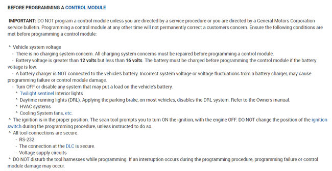

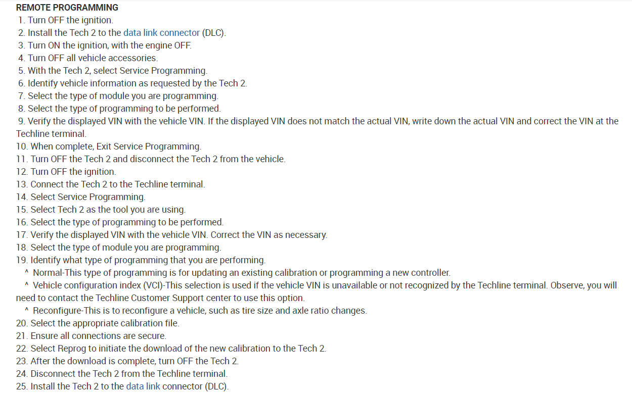

Very possible. It should only be 5 volts.
I attached the procedure for replacement and programming which must be done.
Apr 27, 2021 at 8:58 AM

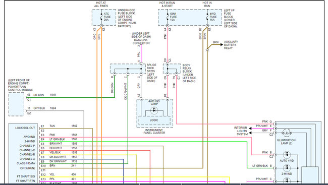

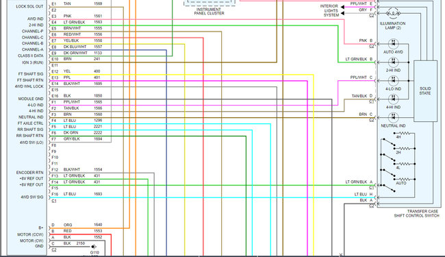

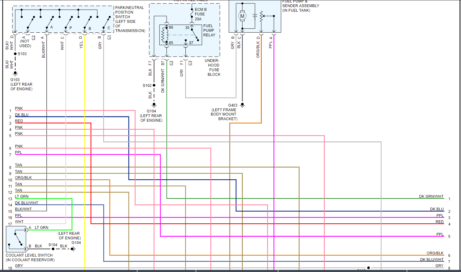

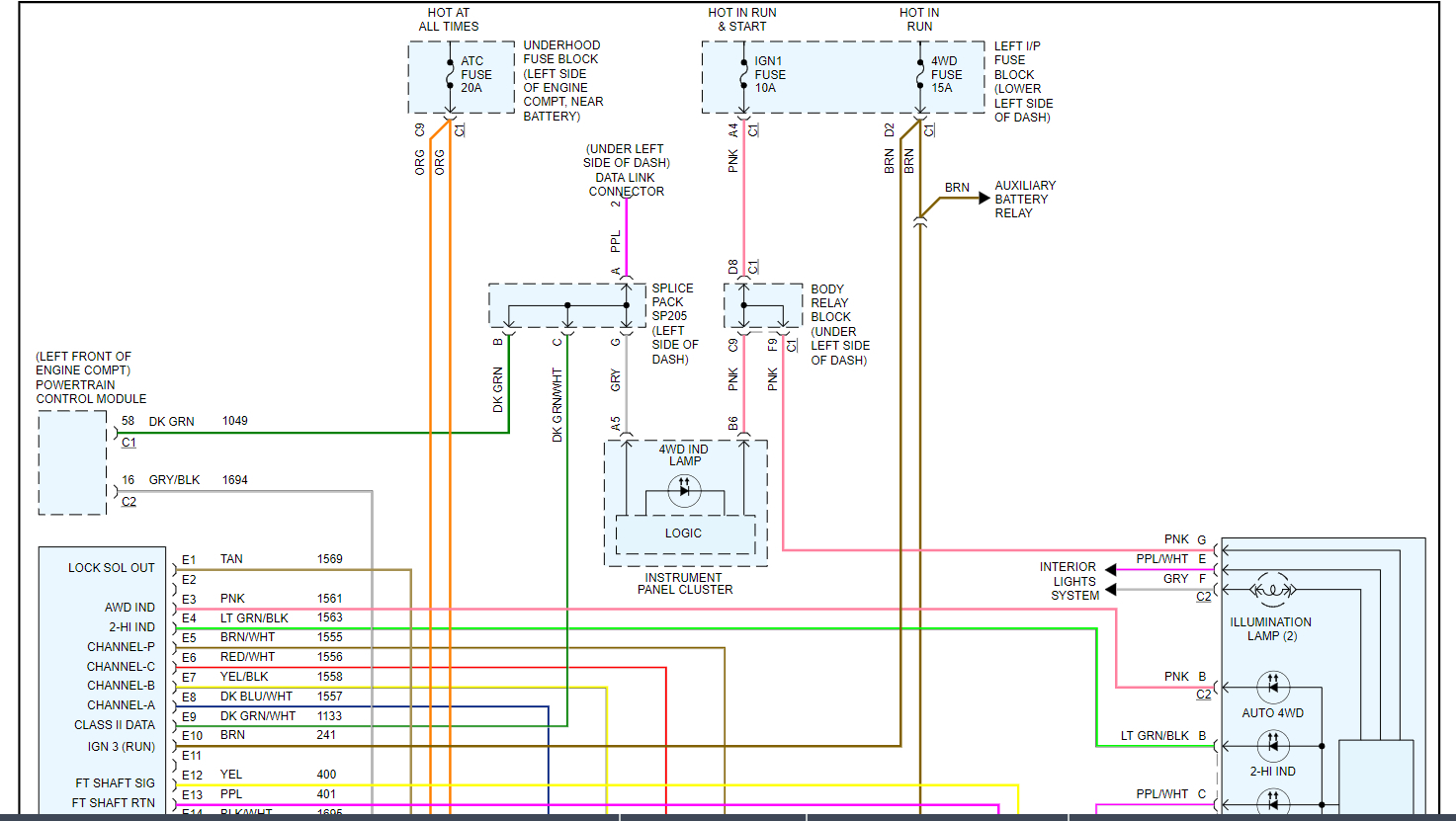

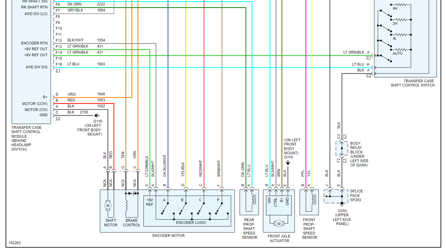

Thanks. but, I don't have the capability to program the computer. I do apologize for not letting you know earlier but this truck is a 4x4. Was wondering if the wiring diagram for that is available. I need to check the position encoder motor and sensor. Should be something like a 5v reference to the range position sensor to let the computer know what position the transfer case is in.
Apr 27, 2021 at 10:53 AM
I attached the circuit for the 4 wheel drive for you to view.
Apr 27, 2021 at 6:20 PM
RADJOHN
  • 14 POSTS
Thanks again. I have the older style of encoder motor with two plugs.one plug is 4 wire for motor and a 6 wire for position sensor .
Apr 27, 2021 at 6:42 PM
You are welcome.
The encoder motor works on an 8-volt reference signal if you notice in the diagram.
Apr 27, 2021 at 6:45 PM
RADJOHN
  • 14 POSTS
The newer ones have one plug with 10 wires the older ones have two plugs. One with 4 wires to control the motor and one with 6 wires to go to the position sensor. It is the same setup just two plugs instead of one. The 8v reference will be on the 6 wire plug going to the range position sensor on the encoder module. Thanks again for your help and patience. I need to get me a set of those diagrams. I like the Chevrolets and GMCs from that era 20000 to 2006.

Was a broken pin on the PCM very corroded going from PCM to wiring harness.
May 11, 2021 at 8:19 AM
Good find. Glad it is fixed.
