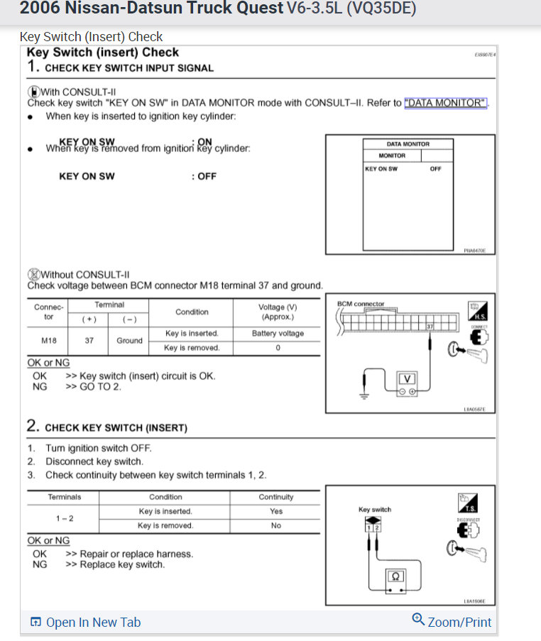

engine not running - P1610 code ?
2006 NISSAN QUEST
177,110 MILES • 3.5L • V6 • 2WD • AUTOMATIC
NISSAN20
I replaced the battery, bank 1 and bank 2 cam shaft sensors, and the crank shaft sensor. When I hooked it all back up the code P1610 was now present. It would crank beautifully but never start up. My Obd2 reader said the description of the code was an invalid key was used 5 times. So my question is could I have a locksmith reprogram my key and the system would recognize the key and allow the car to start?

Yep, that is the problem. the P1610 code is telling you the key is not right for the car but you might be able to reset the system this guide can help. Is the security light flashing?
https://www.2carpros.com/articles/how-to-reset-a-security-system
We are instructions for your car below.. Check out the diagrams (below). Please let us know what you find.
