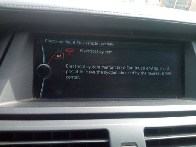

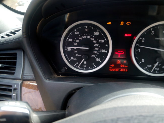

Once driving system malfunction pops up on the instrument cluster.
Mar 11, 2019 at 4:14 PM
JAKAUTOWORLD
That's what pop up and after scanning it shows P15fe code.
Mar 11, 2019 at 4:17 PM

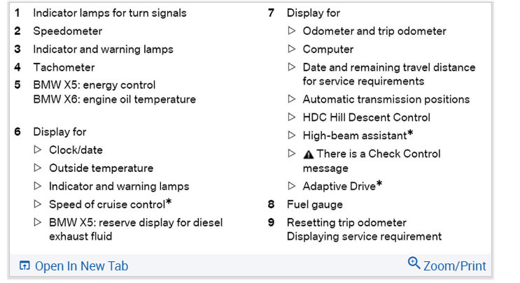

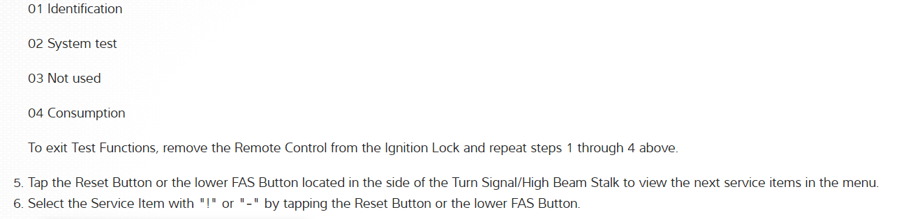

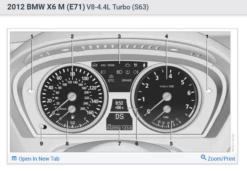

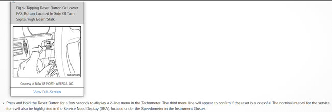

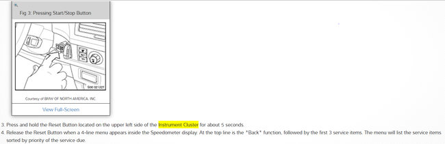

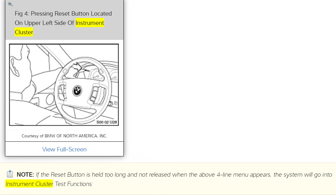

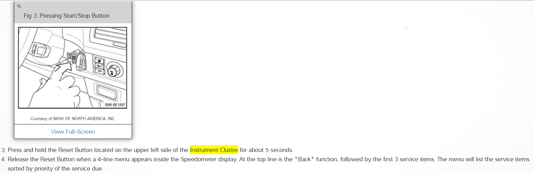

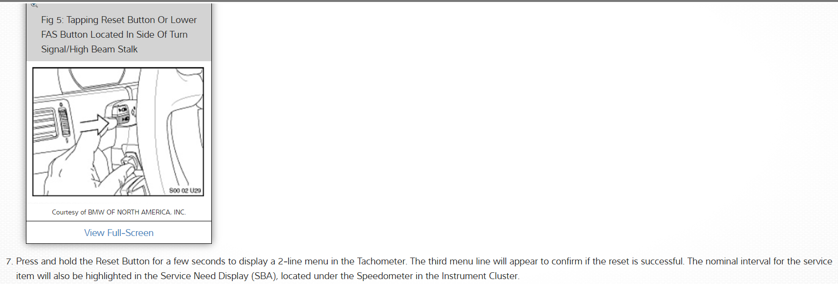

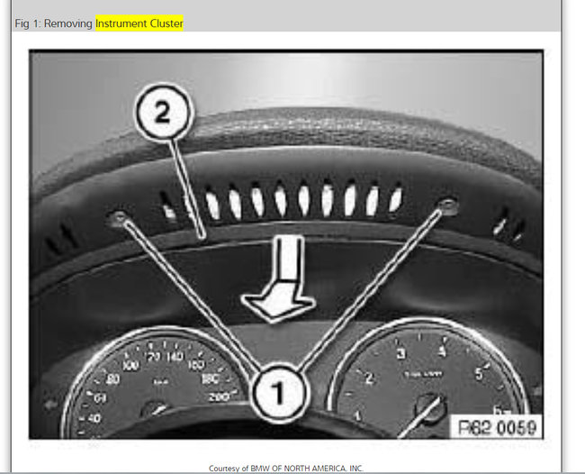

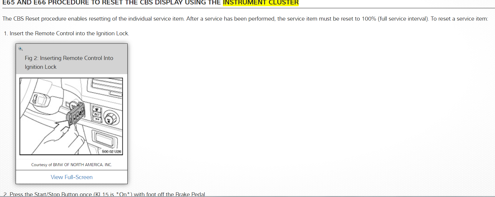

The P15fe code is for the instrument cluster memory has failed. I would remove the cluster and have it rebuilt. there are many places online you can send it into. Here are diagrams to help you remove the cluster and a video showing the job being done on a different car, the process is the same. Check out the instructions and diagrams below.
https://youtu.be/_HEC44xENxw
Mar 13, 2019 at 9:13 AM
