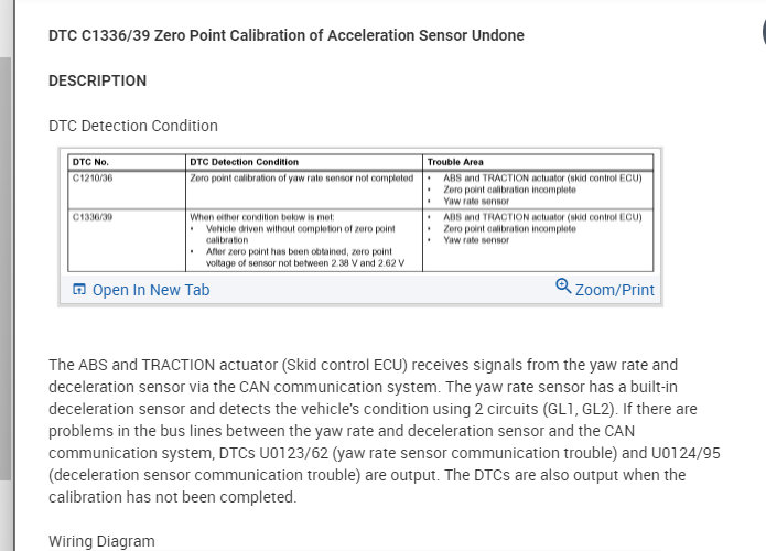

Code P1589
2007 TOYOTA RAV4
550,987 MILES • 1.9L • 4 CYL • 2WD • AUTOMATIC
ANTHONY CHARLES

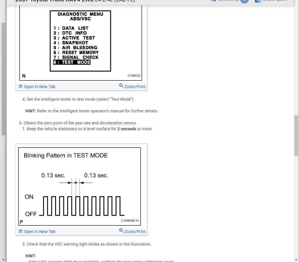

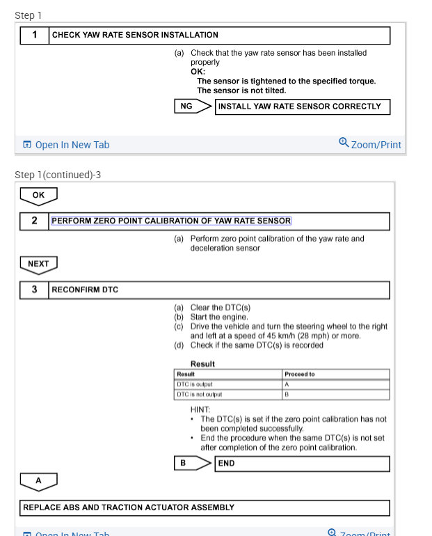

Change acceleration pedal, throttle body, clear code and as the car rolls the check engine light pops up. I would like to know what's next please,
Mar 4, 2022 at 2:46 AM

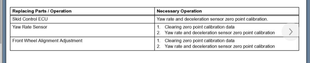

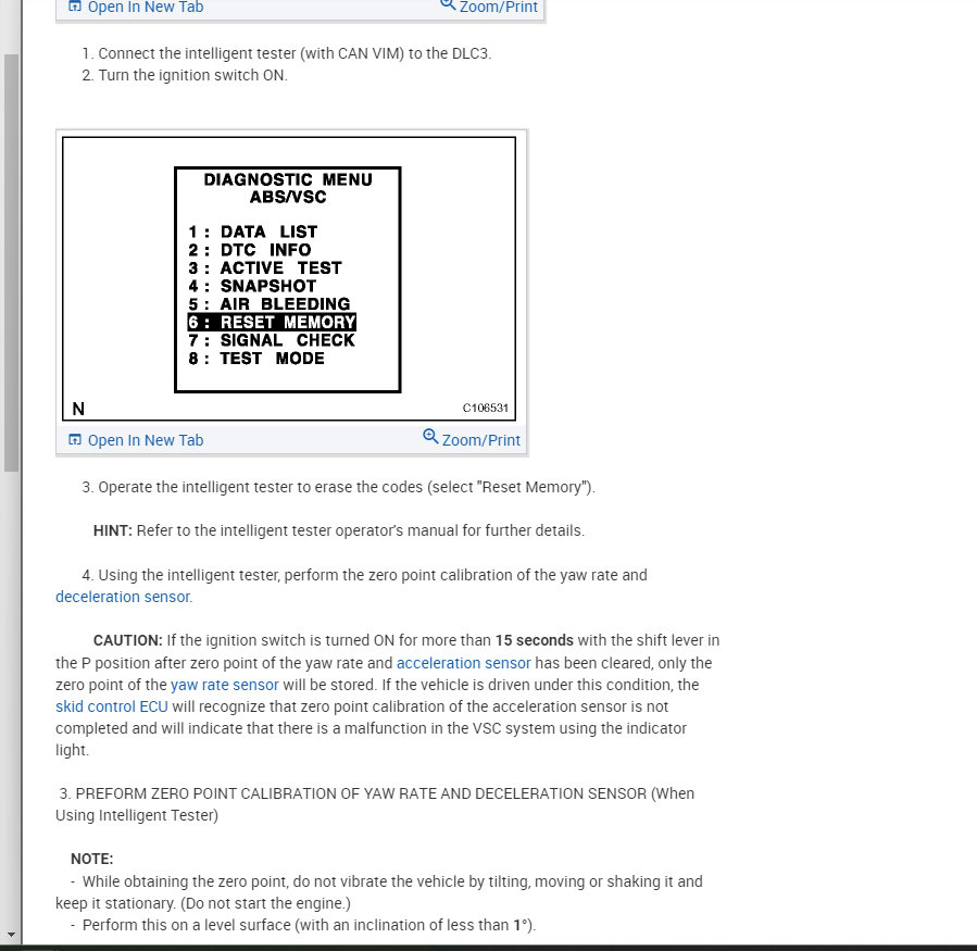

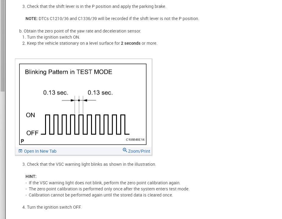

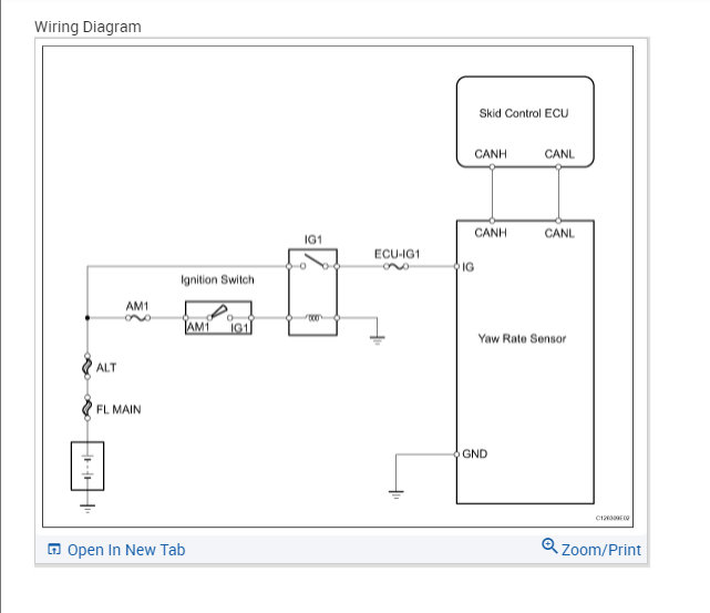

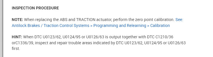

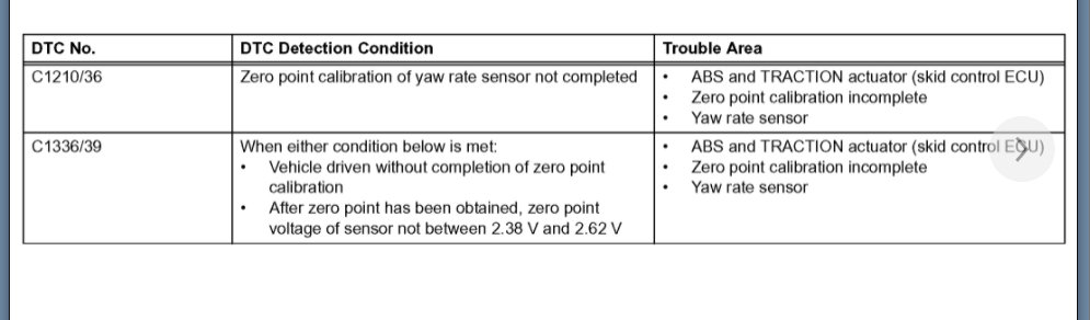

This code is actually not for your specific vehicle, but this is a common issue when using a generic code reader.

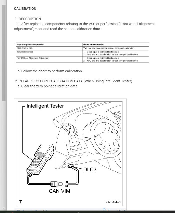

However, this code is for the acceleration sensor learning value. This is different than the accelerator pedal position sensor.

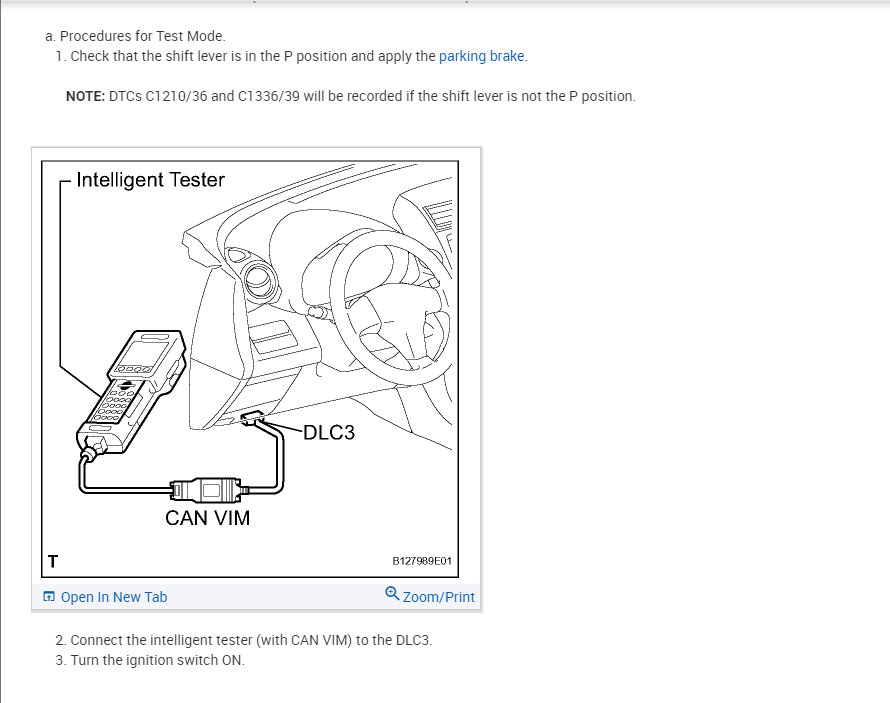

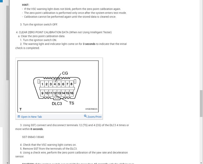

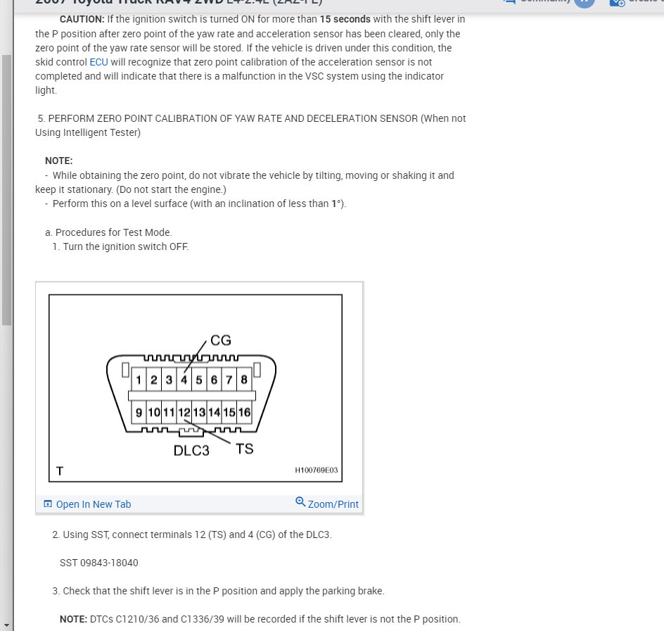

I am attaching the info for this issue, but you may be able to perform what is called zero-point calibration and get the code to not reset.
However, there is likely an issue that we will need to figure out so let's start with running through all this info below and see what turns up.
Let me know what questions you have.
Thanks
