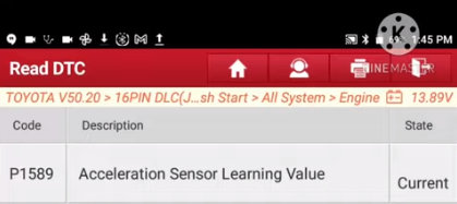

I have a 2007 Toyota Rav 4, 2.4L car giving engine trouble code P1589 "Acceleration sensor learning value".

P1589 Acceleration sensor learning value.

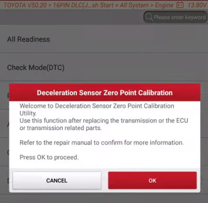

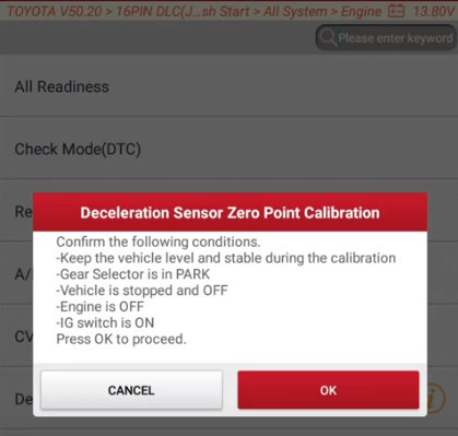

It relates to the multi axis acceleration sensor. This error occurs during deceleration testing, when the vehicle is almost at a stop - but the acceleration sensor in the vehicle doesn't register that deceleration correctly.
You will have to use a suitable scan tool to carry out a 0 point learning procedure.
See images below.
A video showing how to.
