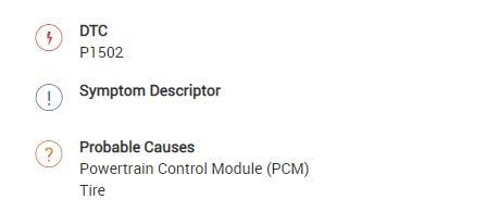

I keep getting a p1502 code, I've changed all wheel speed and vehicle speed sensors. i'm at a loss. checked a little for broken wires. Feels like transmission is having hard time deciding when to shift uphill between 45-55. Really jerks the truck.

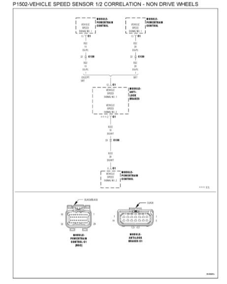

P1502-VEHICLE SPEED SENSOR 1/2 CORRELATION - NON DRIVE WHEELS
P1502 - Vehicle Speed Sensor 1/2 Correlation - Non Drive Wheels
WHEN MONITORED
Ignition on and vehicle moving. Cruise is learned and customer is trying to use the Cruise.
SET CONDITION
The PCM recognizes rear wheel speed is greater than front wheel speed.
POSSIBLE CAUSES
Vehicle speed signal circuits shorted to voltage
Vehicle speed signal circuits shorted to ground
Tire circumference
PCM
Always perform the Pre-Diagnostic Troubleshooting procedure before proceeding.

3. VSS SIGNAL CIRCUITS SHORTED TO VOLTAGE

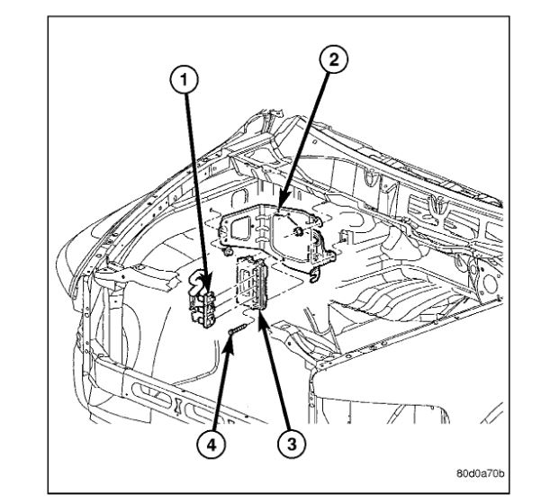

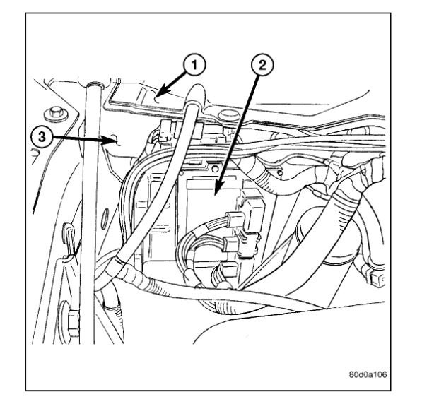

REMOVAL
The PCM (1) is located in the engine compartment attached to the dash panel (3).
To avoid possible voltage spike damage to the PCM, ignition key must be off, and negative battery cable must be disconnected before unplugging PCM connectors.
1. Disconnect negative battery cable at battery.
2. Remove cover over electrical connectors. Cover snaps onto PCM.
3. Carefully unplug the three 32-way connectors (four 38-way connectors if equipped with NGC) from PCM (1).
4. Remove three PCM mounting bolts (3) and remove PCM from vehicle.

No lights at all, read it with my Snap On Ethos after it was jerking and that popped up, the front wheel speed stopped at 34 MPH.

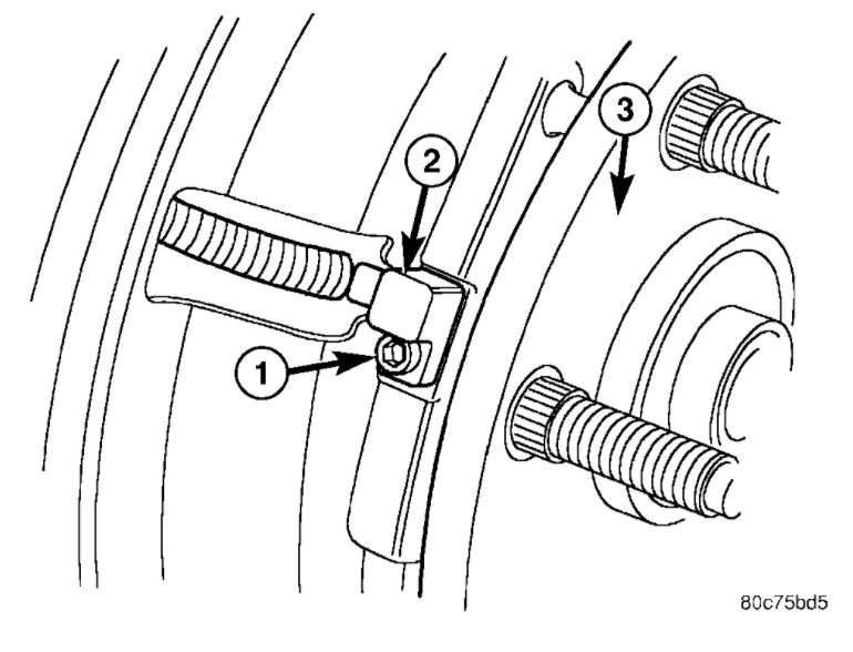

SENSOR- WHEEL SPEED-ABS-FRONT
REMOVAL
1. Remove the front rotor.
2. Remove the wheel speed sensor mounting bolt (1) from the hub (3).
3. Remove the wheel speed sensor (2) from the hub (3).
4. Remove the wiring from the clips and disconnect the electrical connector.

This year model my has one on the front driver side, located in the hub assembly, there's no other speed sensor or ABS sensor to replace.
Jan 4, 2021 at 10:12 PM
The information below for you. You should have 3 sensors.
DESCRIPTION
The ABS brake system uses 3 wheel speed sensors. A sensor is mounted to each front hub/bearings. The third sensor is mounted on top of the rear axle differential housing.
