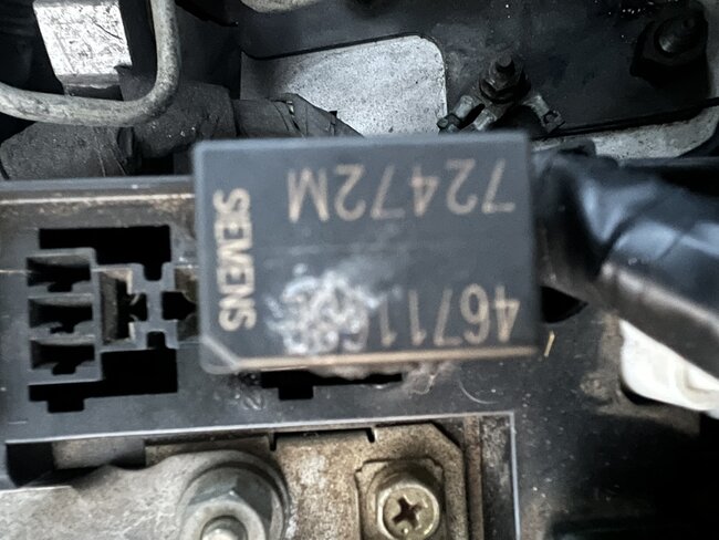

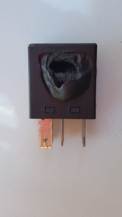

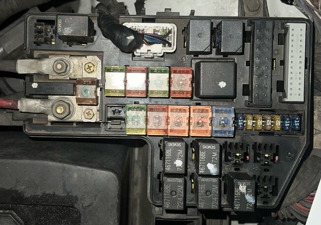

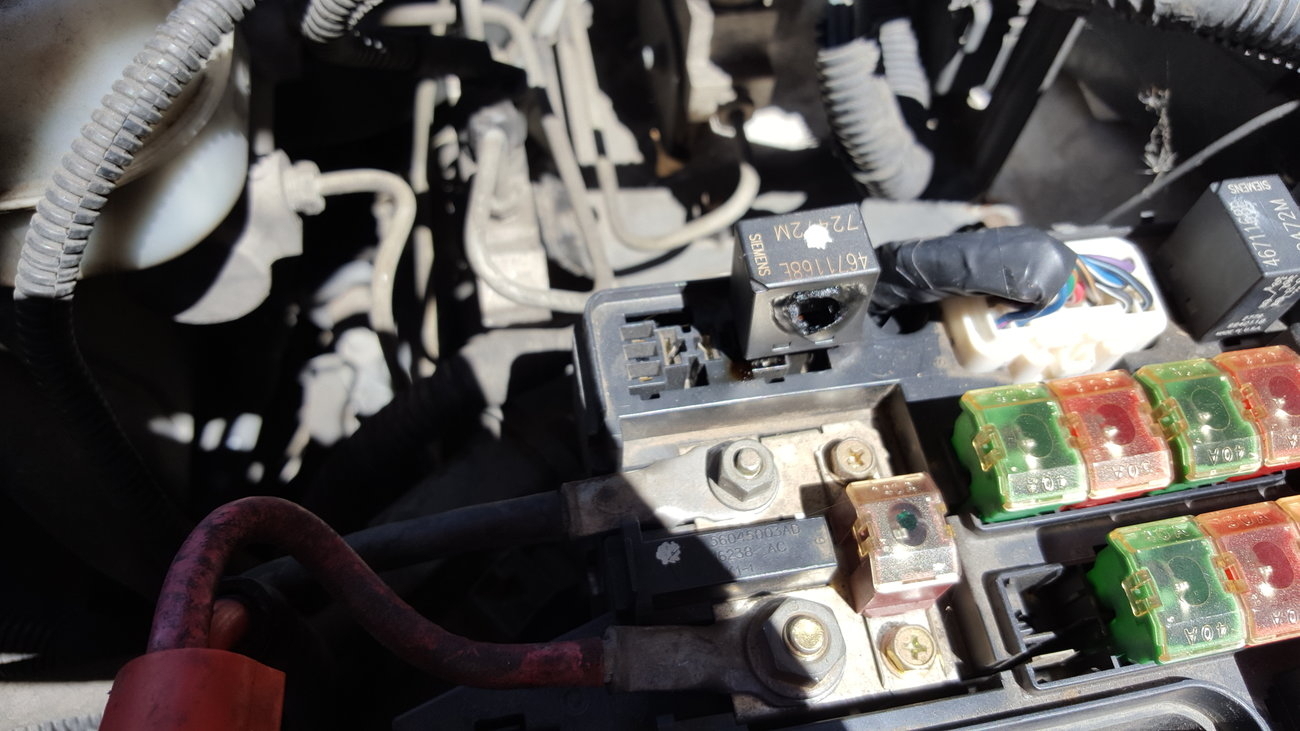

For the last 5 years I have been experiencing issues with the P1491 code. The Rad Fan Relay melts (see photos) and after replacing the relay I am only able to clear the code by replacing the PCM.
This is temporary solution was recommended by a local mechanic. (Replacing the PCM (Powertrain Control Module) and replacing the Rad Fan Relay.)
Unfortunately, I have now replaced the relay and PCM 4 times and this solution is getting expense. I would greatly appreciate assistance in correcting the code P1491 so that I do not have to replace the PCM and relay every year.

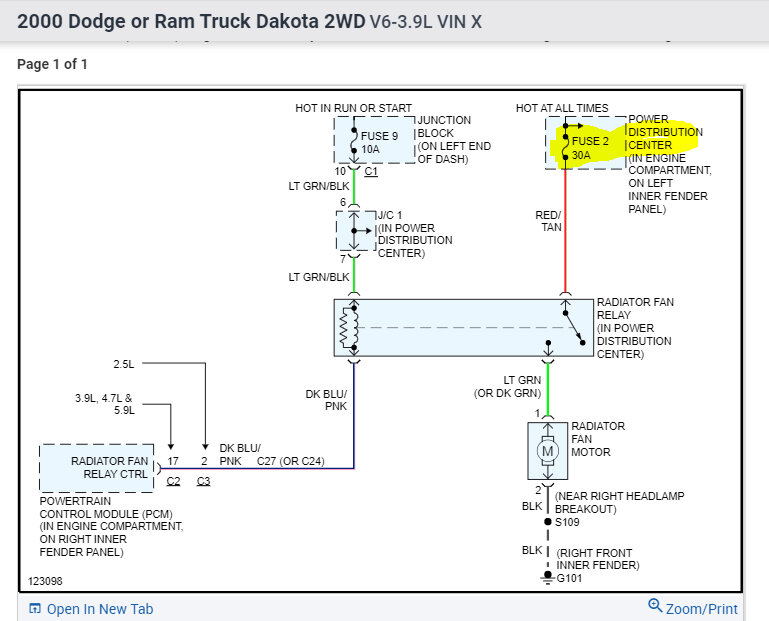

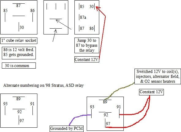

I'm not sure why replacing the PCM is being suggested. That only actuates the relay when it's needed. Actually, the PCM provides a ground path to actuate the relay. Don't waste your money. That isn't causing the issue unless the fan runs at all times.

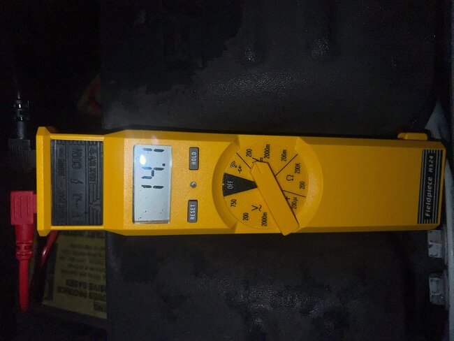

Have you ever replaced the fan motor? It may be drawing too much amperage. Also, I want you to check something for me. I want to know what the alternator output is with the engine running. All you need is a voltmeter or multimeter.
Here is a link that explains how it's done:

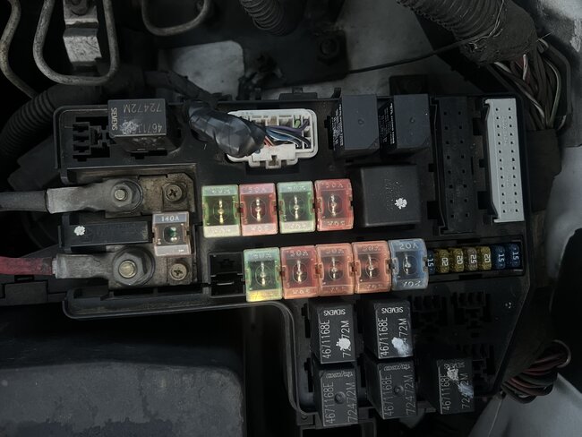

Next, I need you to check the pins in the relay box to make sure there is no evidence of a weak connection. When electric arcs or has to jump, it creates heat. Also, check the connector at the blower motor as well for evidence of it overheating.

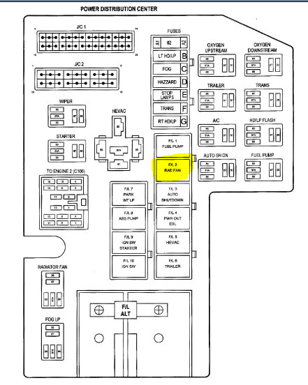

One last check, the fuse that is to power the fan motor is to be a 30-amp fuse. It is fuse 2 in the power distribution box under the hood. Make sure a heavier gauge fuse wasn't used.
I attached the wiring schematic related to the radiator cooling fan which is very basic. If I had to guess, either we have a weak connection causing heat to build or the fan motor is drawing too much power.
Let me know what you find.

I think Joe had the answer in the first reply, about the fan motor drawing too much current. It's not uncommon to see overheated terminals in high-current circuits like ignition switches, heater fan switches, and relay sockets. There's multiple causes, but in this case, with a badly overheated relay, it's more likely due to excessive arcing across the contacts. That arcing occurs when very high current is switched off.
The other thing to look for, especially when someone complains of multiple repeat failures, is the heat from poor relay contacts or poor switch contacts will migrate out and degrade the connector terminals, usually to the point it melts the surrounding plastic connector body. Likewise, that bad connection can occur between a pair of mating connector terminals, then the heat generated can migrate into the switch or relay causing those contacts to overheat and start a new failure. Both the switch or relay, and the mating terminals must be replaced at the same time, otherwise the problem will continue to recur.
I have a suspicion the original failure was caused by a tight radiator fan motor. Without going into unnecessary detail, the more a motor is loaded down, the more current it will draw. Radiator fan motors typically draw around 15 amps. That's more than the typical switching transistors inside computers like to handle, so they use a relay instead. The Engine Computer is only supplying a tiny fraction of an amp to turn on the relay. After that, it has no idea how much current that relay is passing. That's why Joe also couldn't understand the need to replace the computer. Given the really excessive heat generated inside the relay, it's almost certain the contacts arced so many times, they welded themselves together. It's the stuck relay that kept the fan running, not the computer keeping the relay turned on. Terminals arced together like that do not create a nice solid connection, so more heat is generated, as happened here.
I see you did replace the fan motor already. Was that a new one or a used one from a salvage yard? If it was a used one, it might also have tight bearings, but more than likely, the cause of the repeat failures was never addressed, that being the terminals in the relay socket. As badly as that first relay was overheated, it's a good bet the terminals in the socket are blackened or discolored. If you see that, I would address that the same way I do ignition switch connectors. You only need to look at the two terminals for the high-current switched side of the relay. Those will be the two fatter wires in the socket. I also put this drawing together to show them.
You can harvest a pair of terminals with a few inches of wire at a salvage yard, or, I use a new pair of universal spade terminals. Those work better for ignition switches. The job will be easier for you if you can get the old terminals out and the new ones to plug in solidly. If not, when the plastic is badly melted, cut all of it away around those two terminals. When the terminals got hot enough to discolor, the wires are going to be hardened for about the first four inches. Solder won't adhere to that, so cut those first few inches away too. This is why you want to get a good four to five inches of wire with terminals you get from a salvage yard.
With new terminals, splice in the four inches of new wire of the same gauge, solder the splices, then seal them with heat-shrink tubing. Never use electrical tape in a vehicle as it will unravel into a gooey mess on a hot day. Crimp the universal spade terminals to the new wires, but solder them too for the best connection. If the relay box is still okay, plug those original-style terminals into the socket and the repair is done. If the plastic had to be cut away, and / or you're using universal replacement terminals, those will have to be plugged into the relay individually. Consider squeezing them first so they make a really solid contact. For a relay, you might need to make that six or seven inches of new wire so they can be pushed up through the socket. That leaves you something to grab onto when plugging them in separately. Then push the relay into the socket so the other two terminals can plug in.
