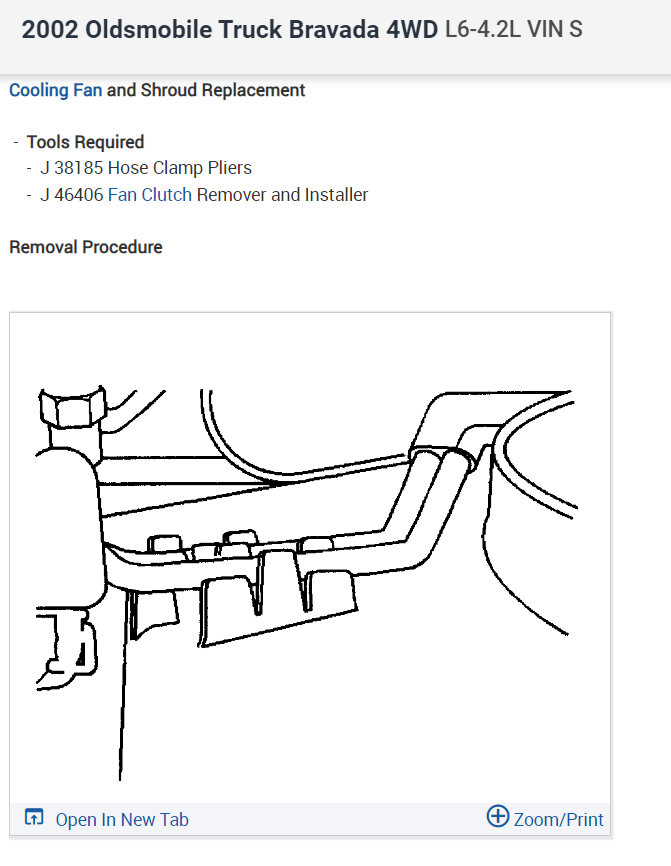

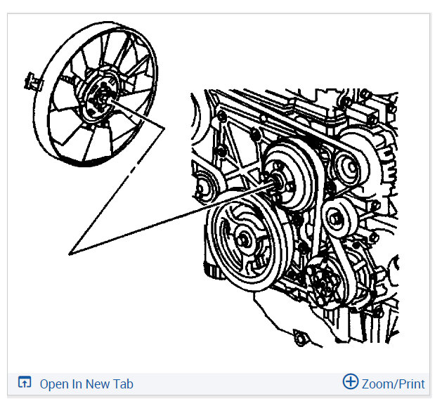

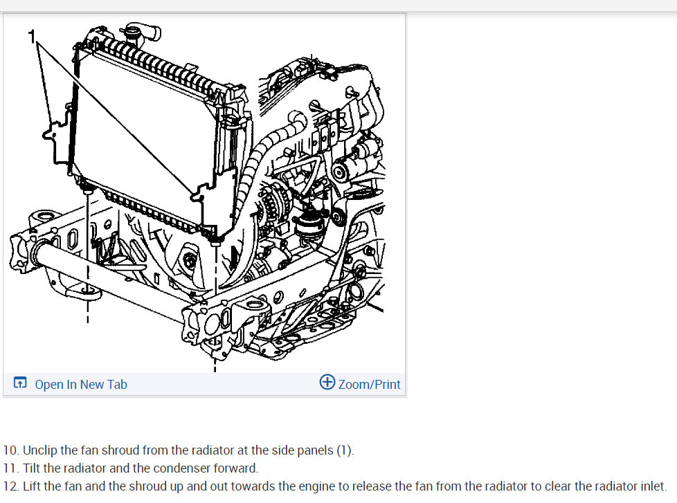

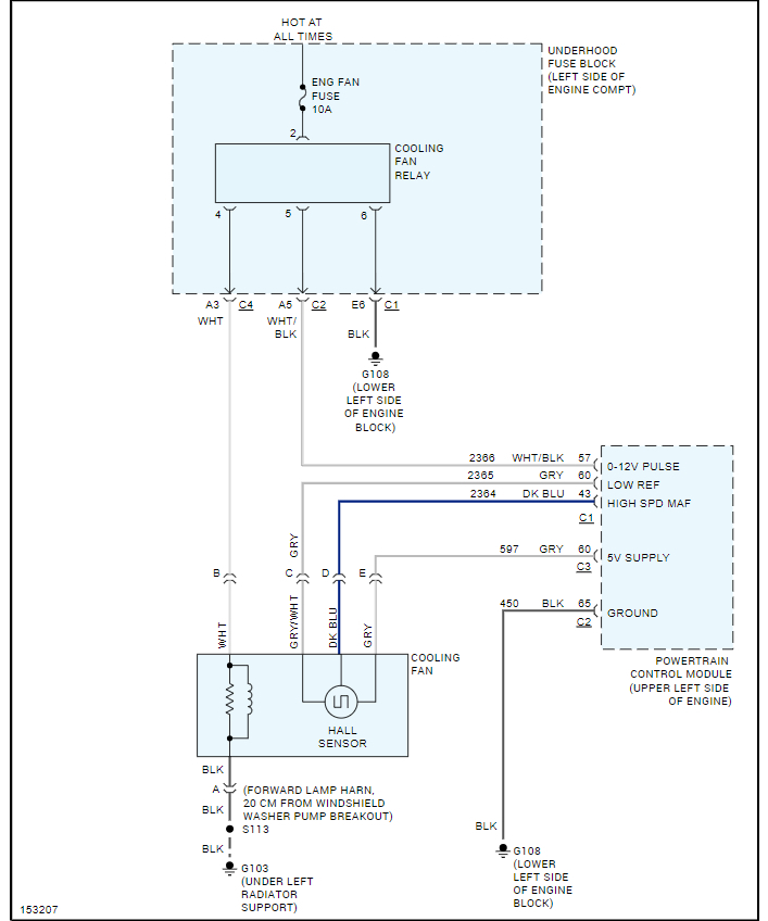

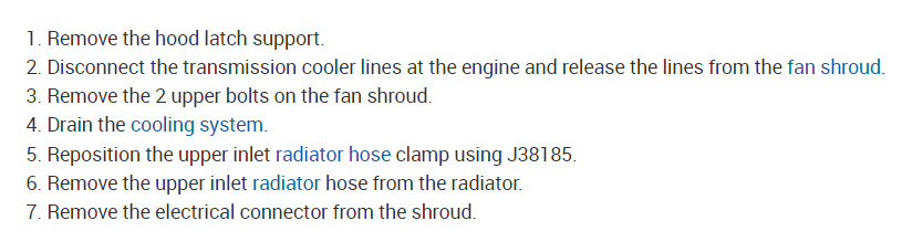

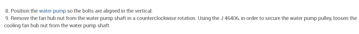

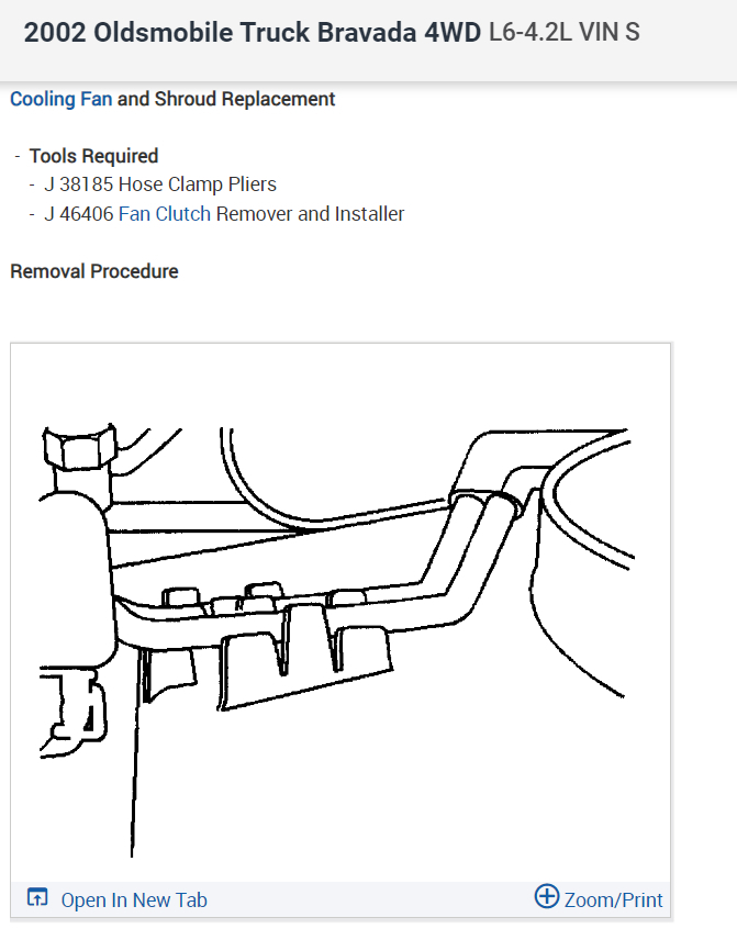

The P1484 error code for a 2002 Oldsmobile Bravada indicates a problem with the Cooling Fan Speed Sensor Circuit. What happens is the cooling fan hall effects sensor goes out and gives you the code, the easiest way to fix it is to replace the cooling fan module. Here are the directions in the images below. Here are the cooling fan wiring diagrams so you can see how the system works. Clear the codes once you are done with the repair. Check out the images (below). Please let us know what happens.

Can't this be done without draining the radiator? If the fan is working, what damage can be done by driving it?
Jul 1, 2024 at 11:41 PM
  • 55,433 POSTS
It looks like the radiator fluid (coolant) will need to be drained yes, If the engine is not overheating then you should be okay except for the check engine light and the P1484 error code.
