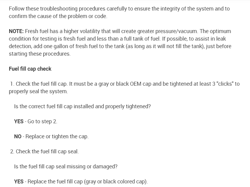

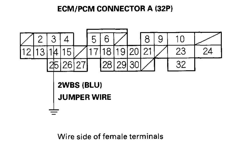

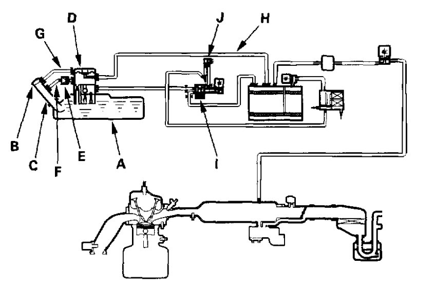

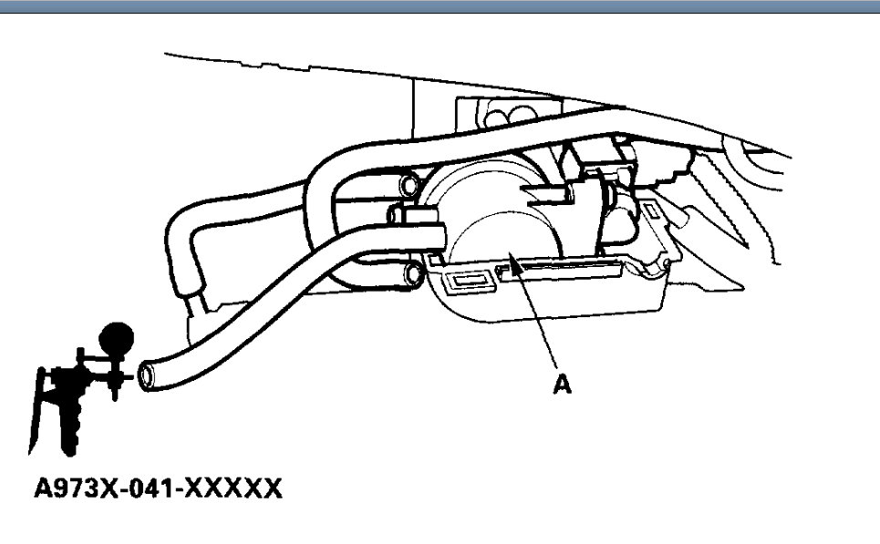

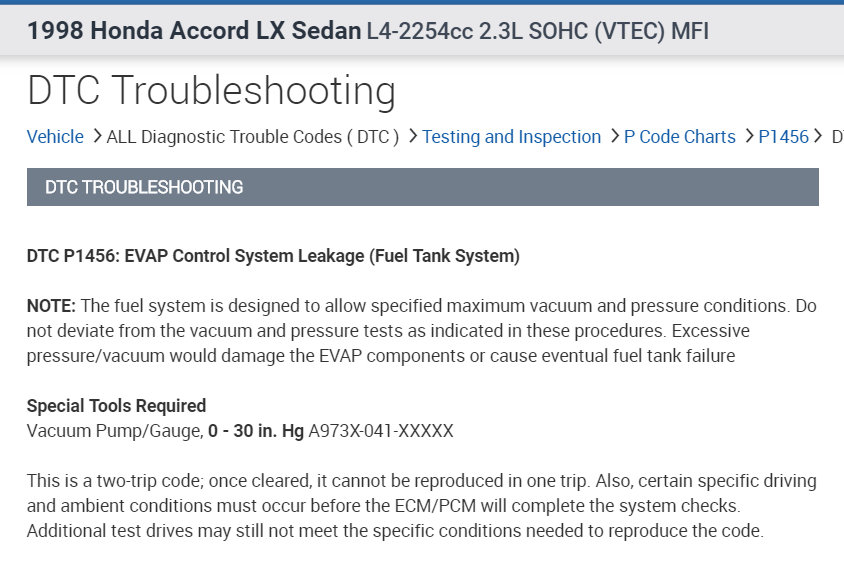

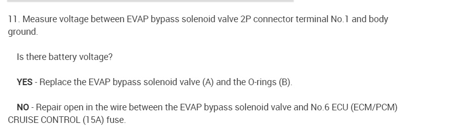

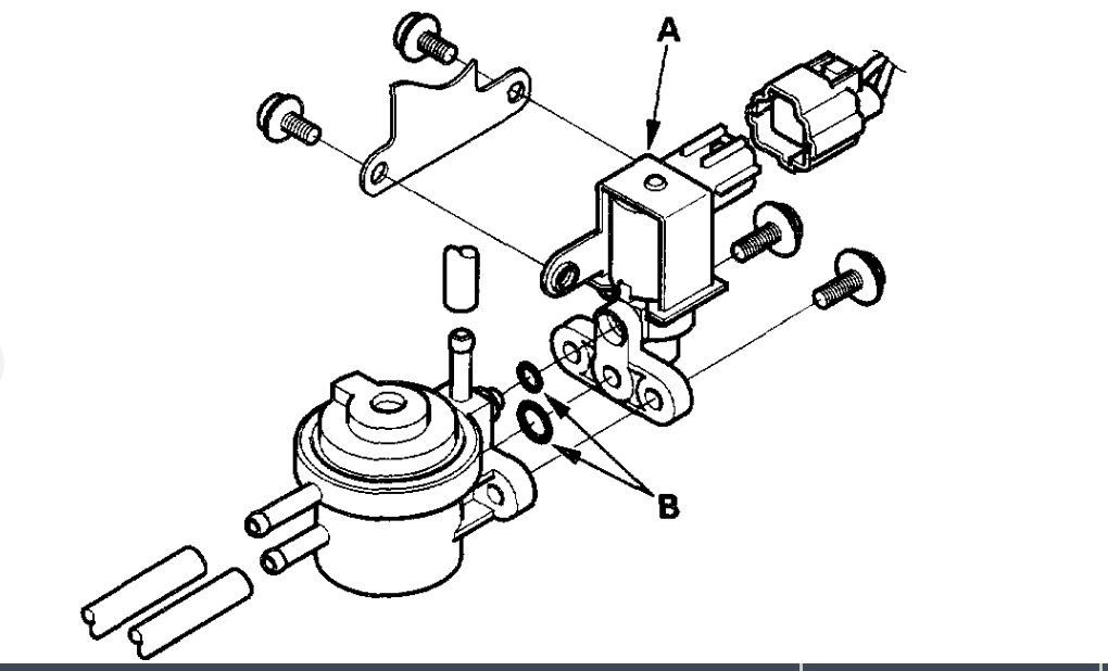

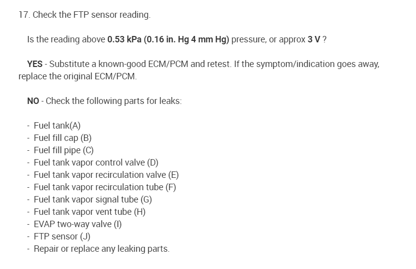

i have code p 1456 on my car. i have replaced two hoses , gas cap , and vapor canister. the code will not disappear . I have literally checked every tube, hose, solenoid , two-way valve , filler tube , gs tank connection , fuel filter , nothing is wrong . I did smell gas fumes , until I repaired the three items I mentioned . what else could it be? I need a smog and wont pass without fixing this. trying to avoid paying for a smoke EVAP test .
May 15, 2019 at 8:38 PM
SCGRANTURISMO
  • 4,897 POSTS

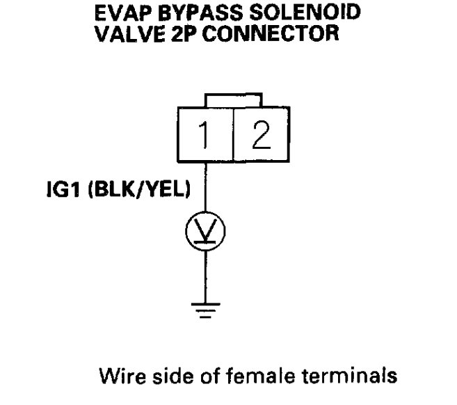

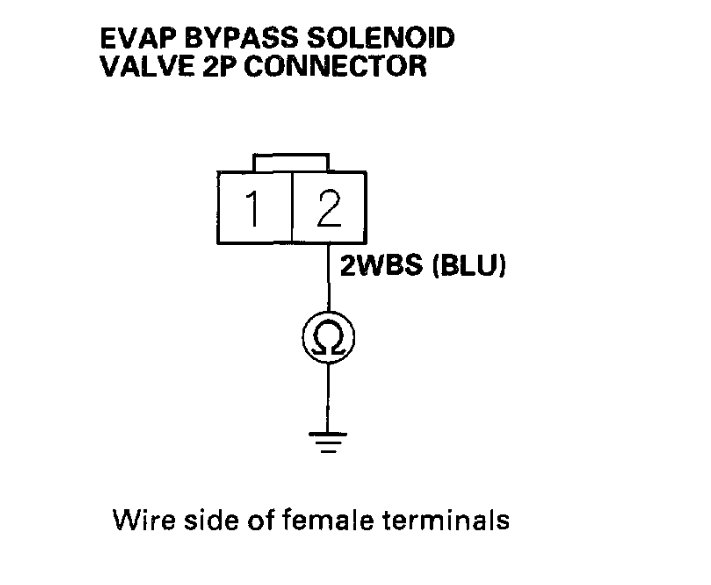

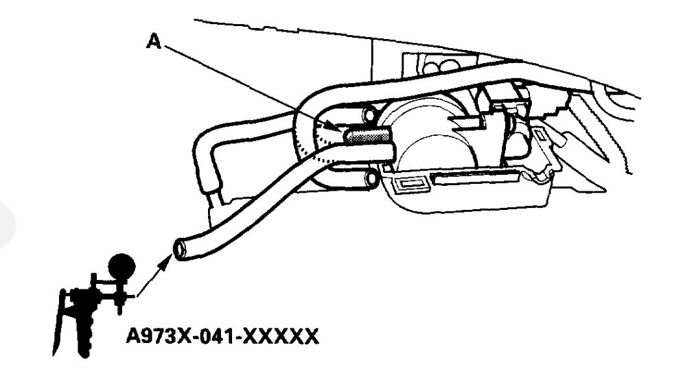

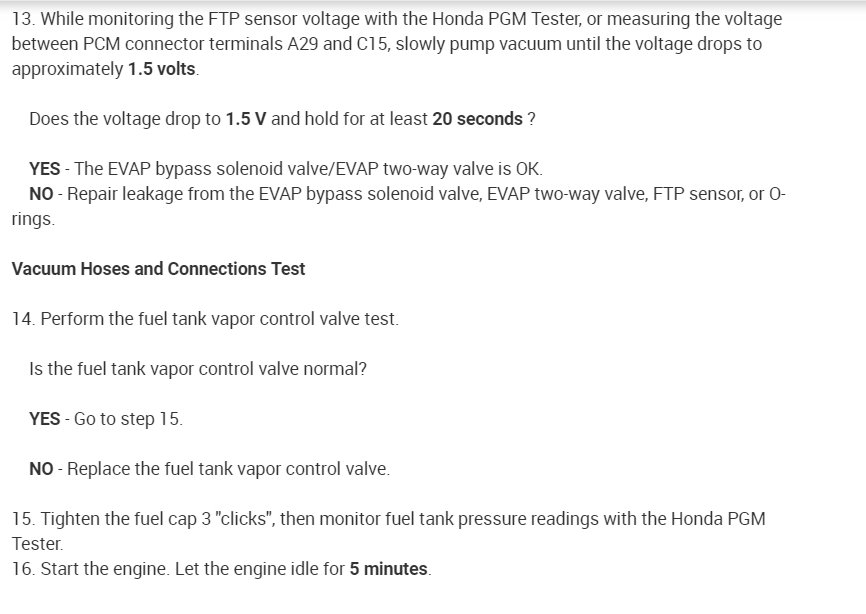

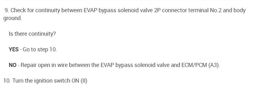

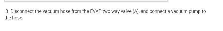

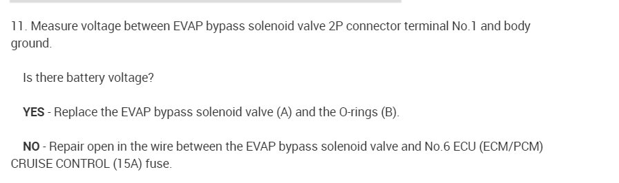

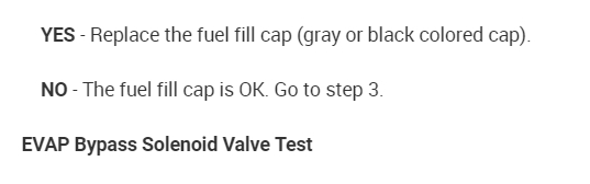

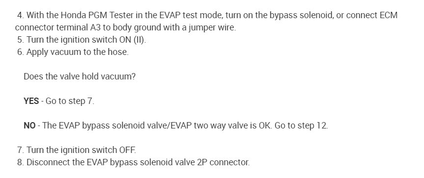

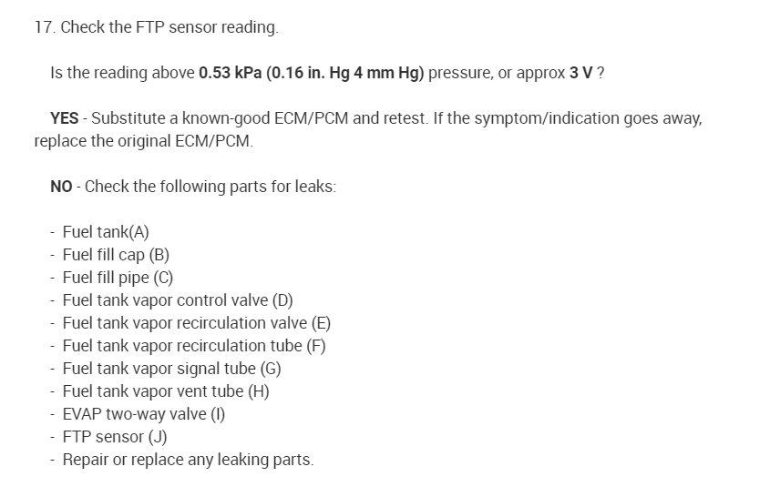

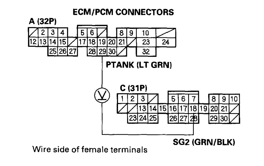

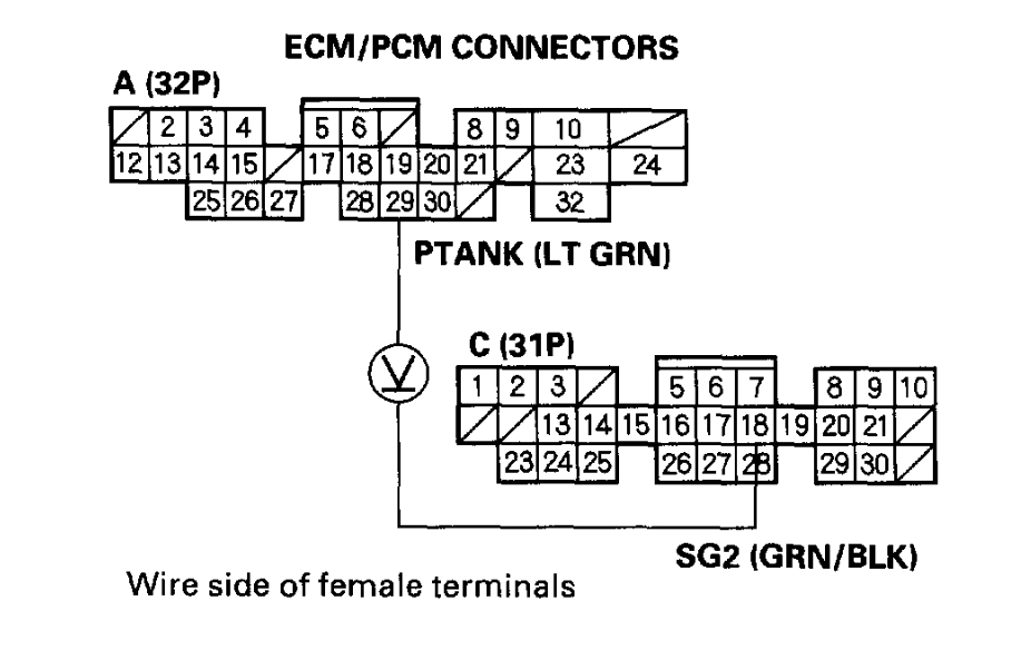

I have included for you in the diagrams down below the factory diagnostic troubleshooting guide for Direct Trouble Code (DTC) P1456. Please go through the guide and get back to us with what you are able to find out.
Thanks,
Alex
