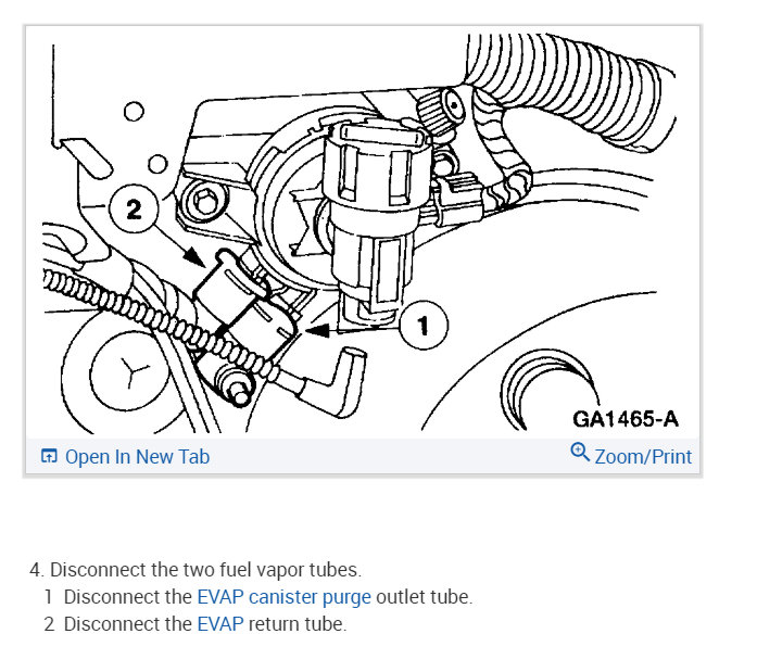

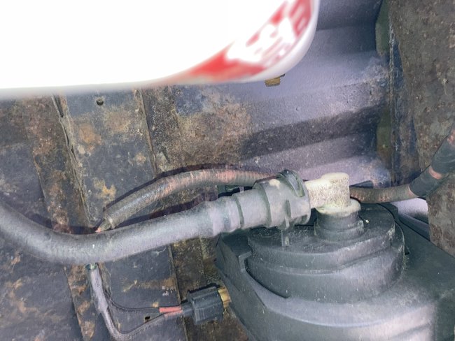

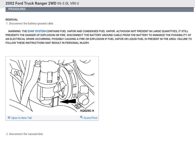

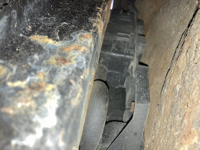

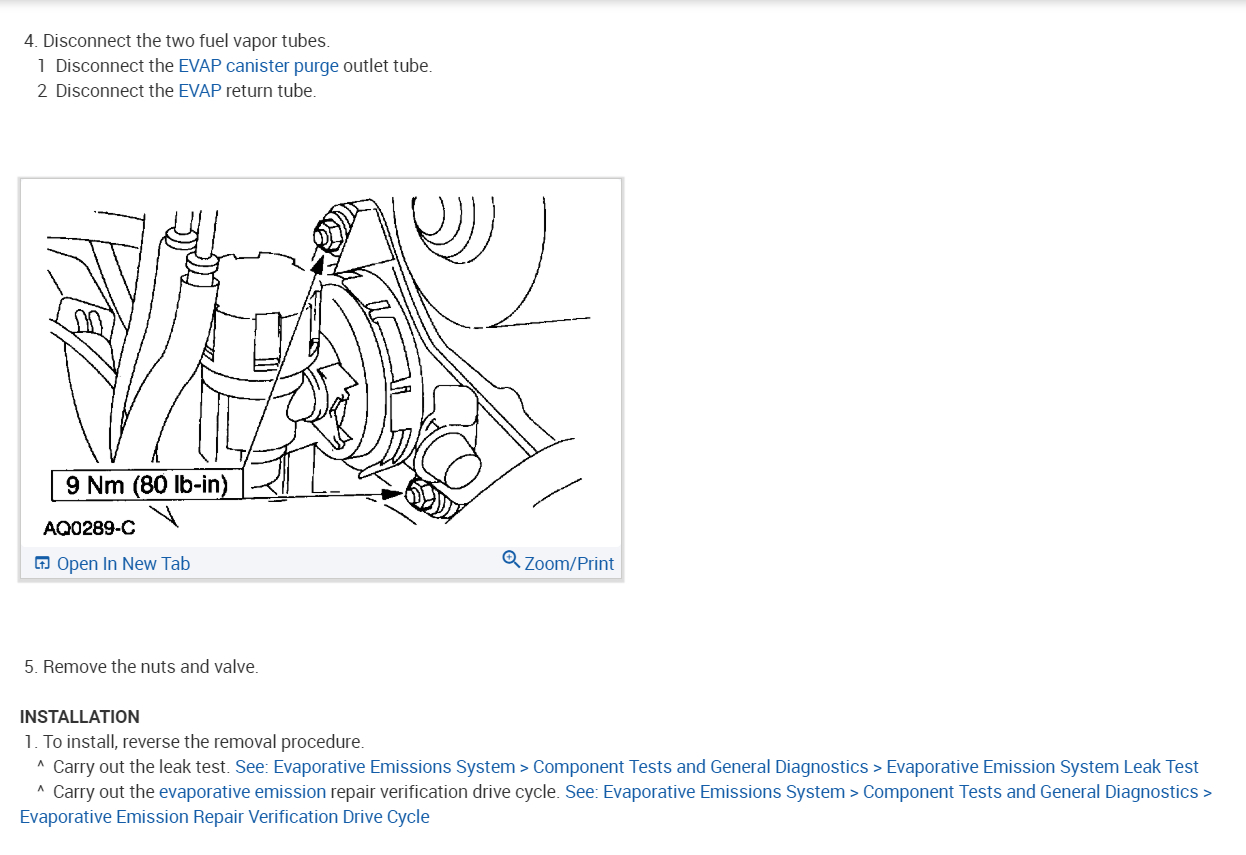

Can’t find the canister vent solenoid on my truck. Can someone help?
Jun 6, 2020 at 11:51 PM
AL514
  • 5,654 POSTS
Hello, if I remember correctly I believe the canister vent valve is up by the brake booster it's a terrible location and the wires are subject to extreme conditions, especially up north. Make sure to inspect the wires extremely well.
Jun 7, 2020 at 2:21 AM
JEREMY/70
  • 5 POSTS
Thank you for your help. This is the only thing I see above the spare set up. Is it close to the gas tank or connected to a line I can follow?
Jun 7, 2020 at 3:41 AM
JEREMY/70
  • 5 POSTS
I just found it. Thank you very much for your help.
Jun 7, 2020 at 4:24 AM
AL514
  • 5,654 POSTS
Okay, you can use a regular test light to check the power and ground back there. But do a visual inspection of the wires first I'm sure you'll find a little break in it somewhere where it's corroded inside.
Jun 7, 2020 at 9:46 AM
JEREMY/70
  • 5 POSTS
That was the problem. The wires were broke at the clip. Just needed s new clip.
Jun 7, 2020 at 7:08 PM
AL514
  • 5,654 POSTS
Great to hear, nice easy cheap fix, the manufacturer really should put more insulation around those or reposition them or something. Those wires always take a beating. But glad to hear you found the problem without too much headache.
Jun 8, 2020 at 3:40 AM
JEREMY/70
  • 5 POSTS
