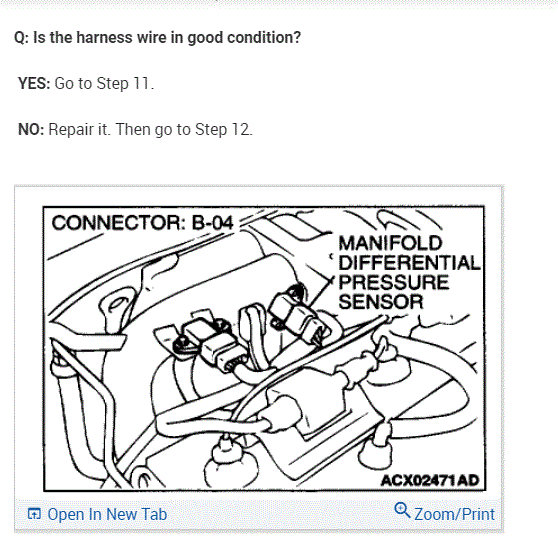

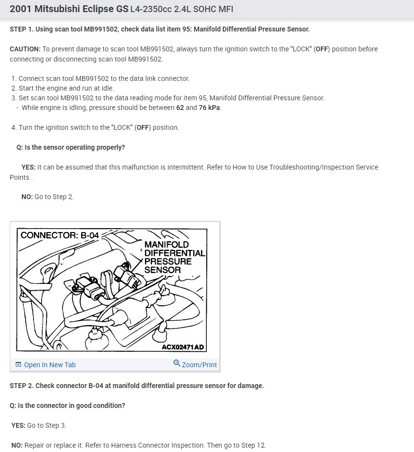

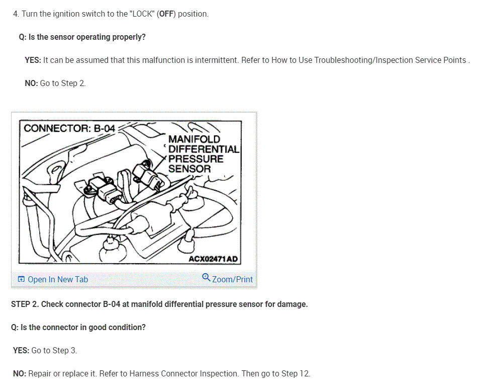

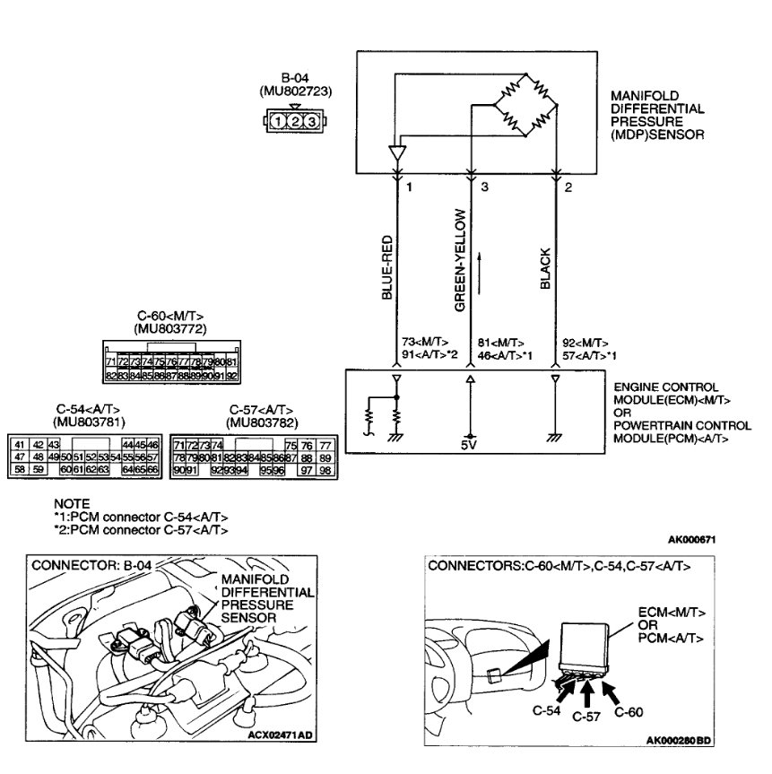

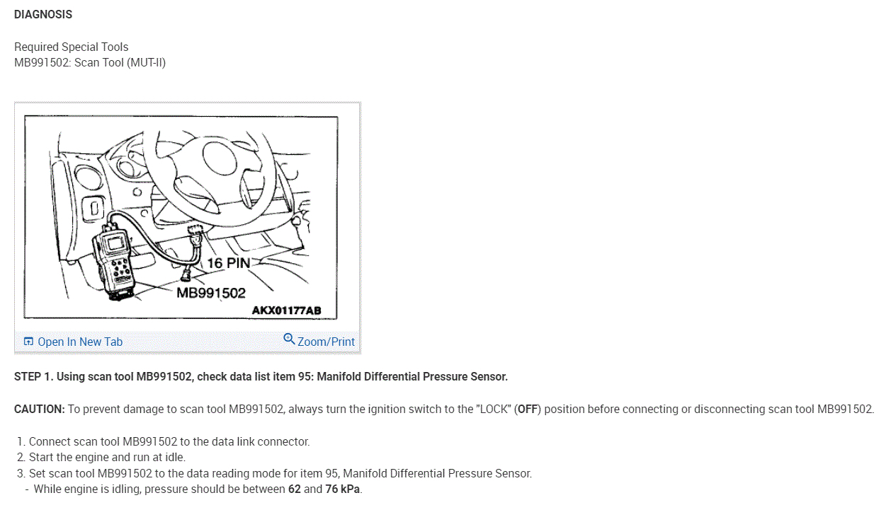

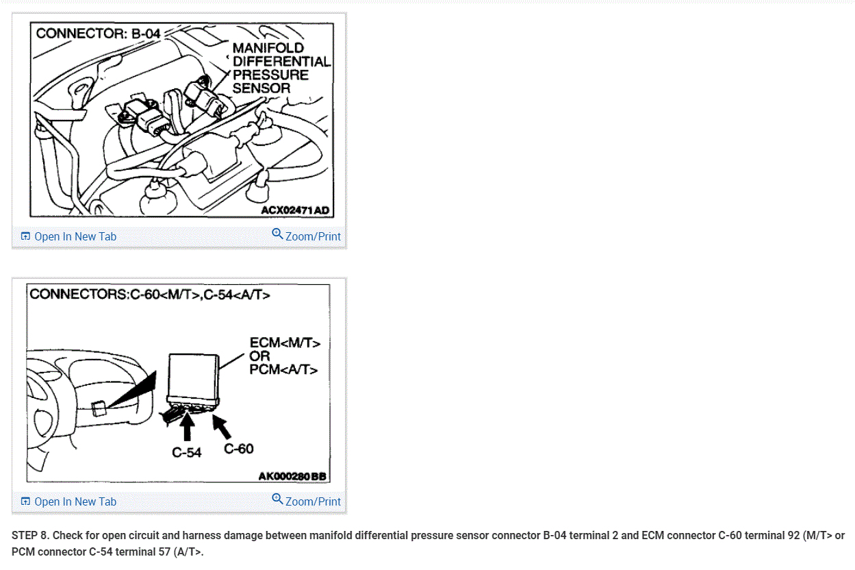

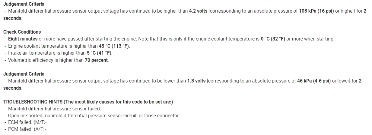

I just got the P1400 code today. This is a manufacturer specific code and from digging around it's for the Manifold Differential Pressure sensor. Is this the same thing as the Manifold Absolute Pressure sensor? How could I test this with my ELM327 Bluetooth OBD2 scan tool? From reading online it can be the sensor itself, EGR valve related, or an MDP circuitry short. I can't find much info about potential symptoms caused by this issue.
May 16, 2022 at 6:08 PM
SQM
  • 6,383 POSTS

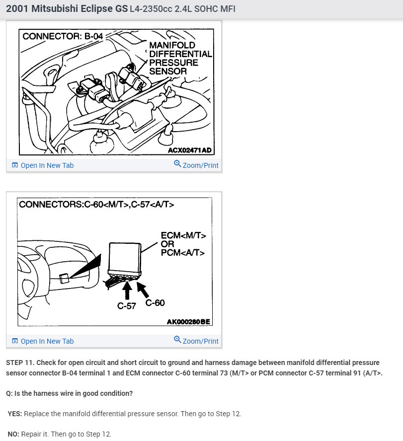

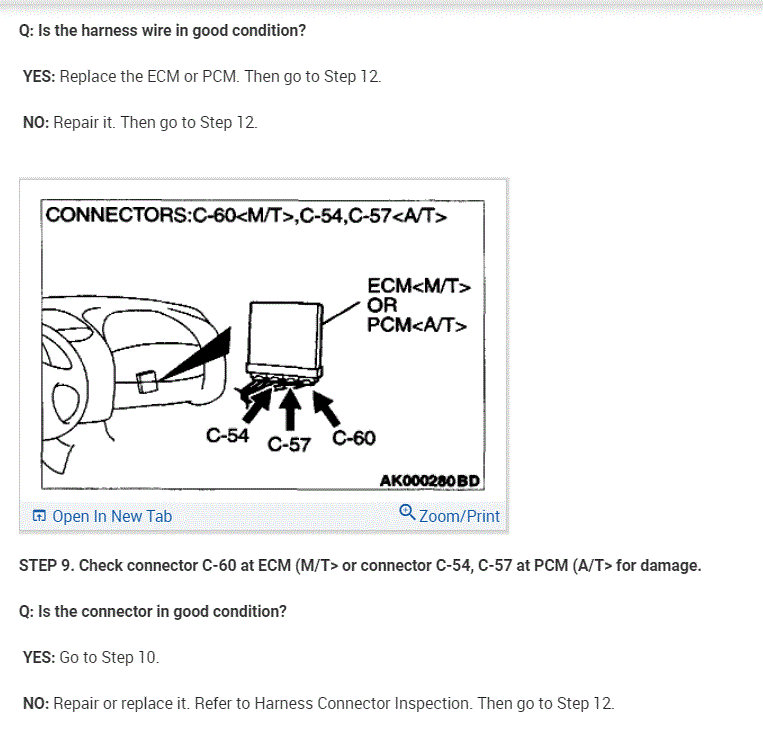

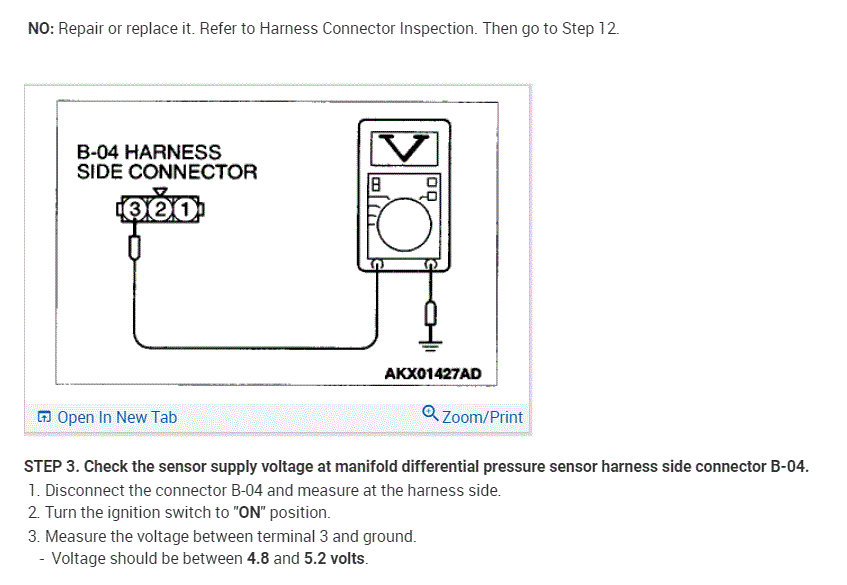

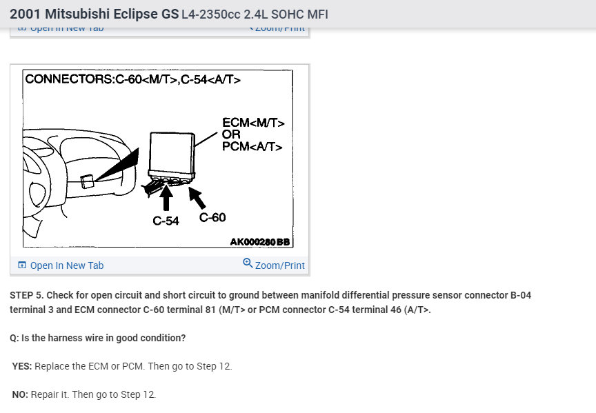

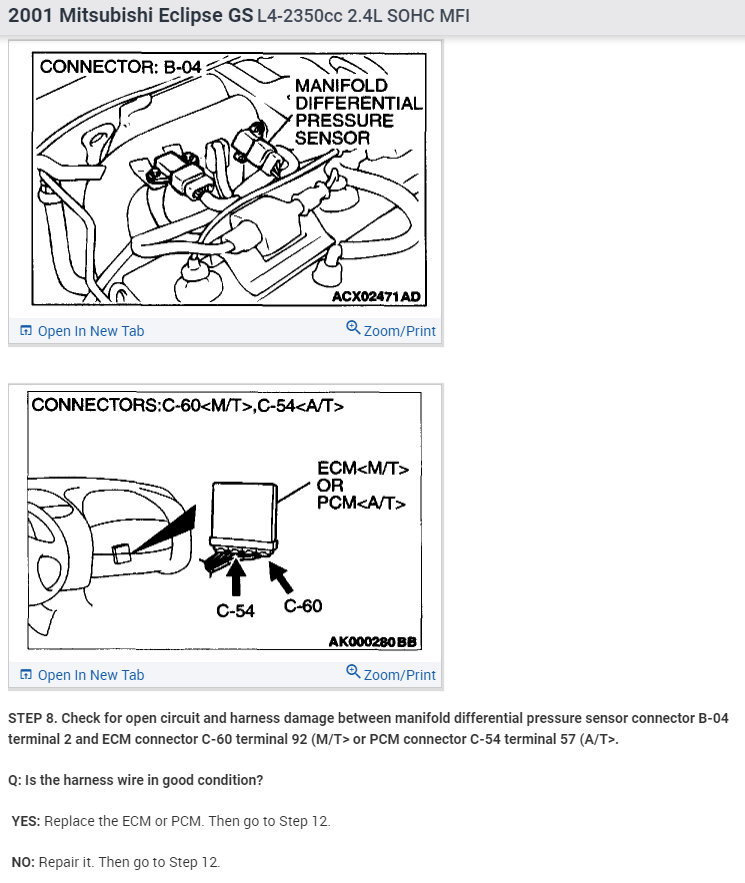

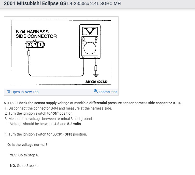

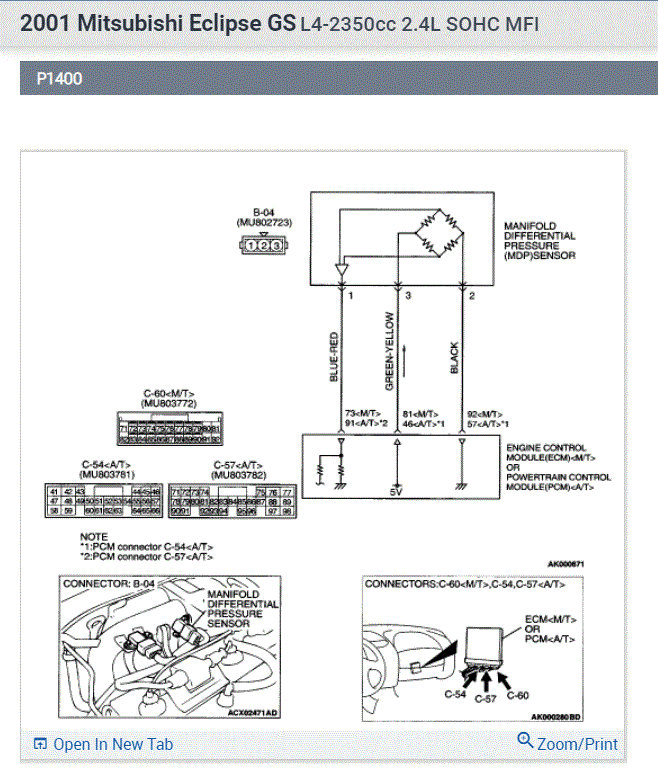

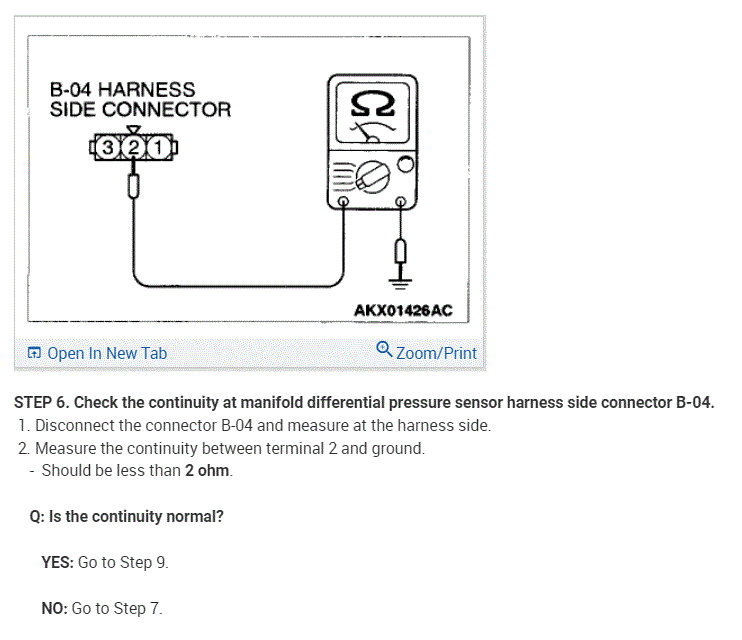

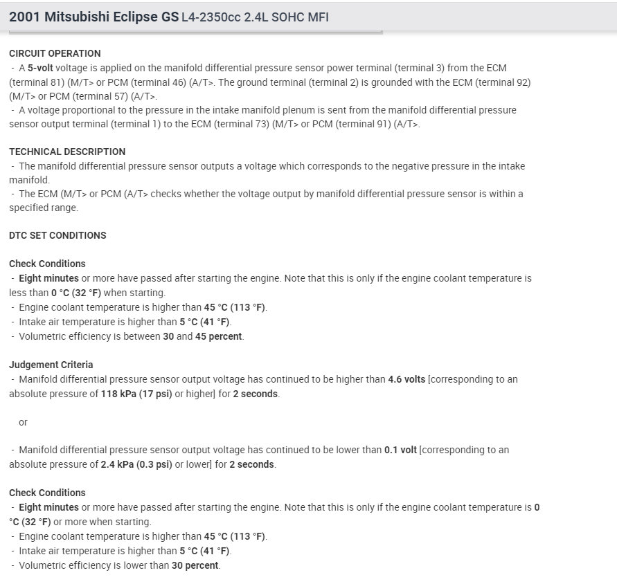

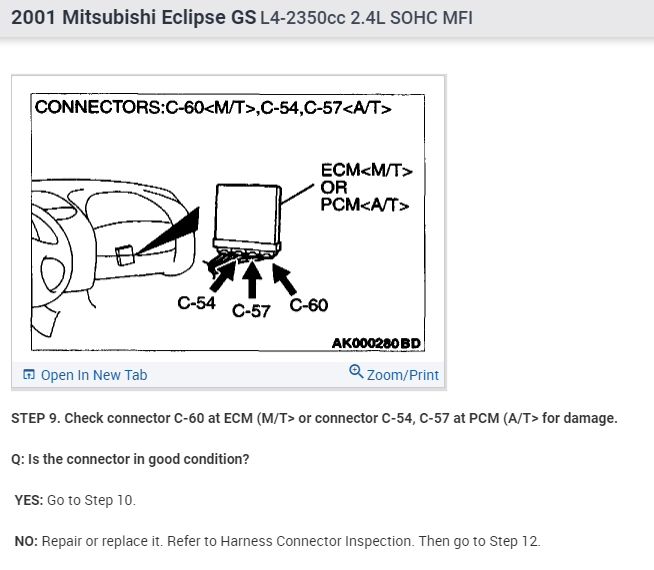

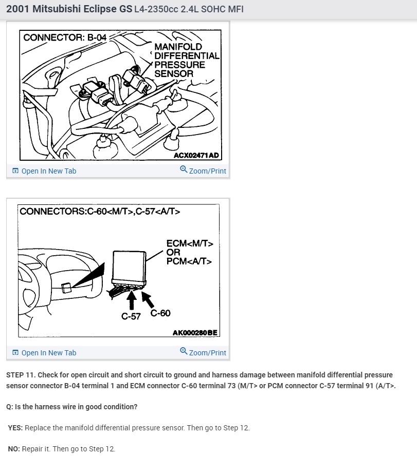

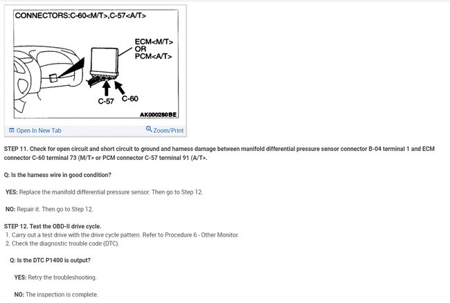

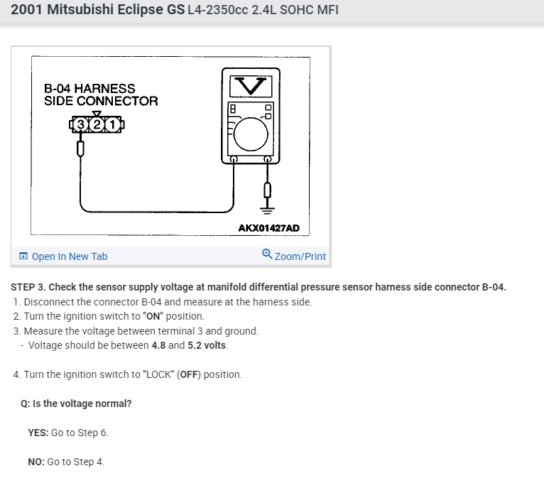

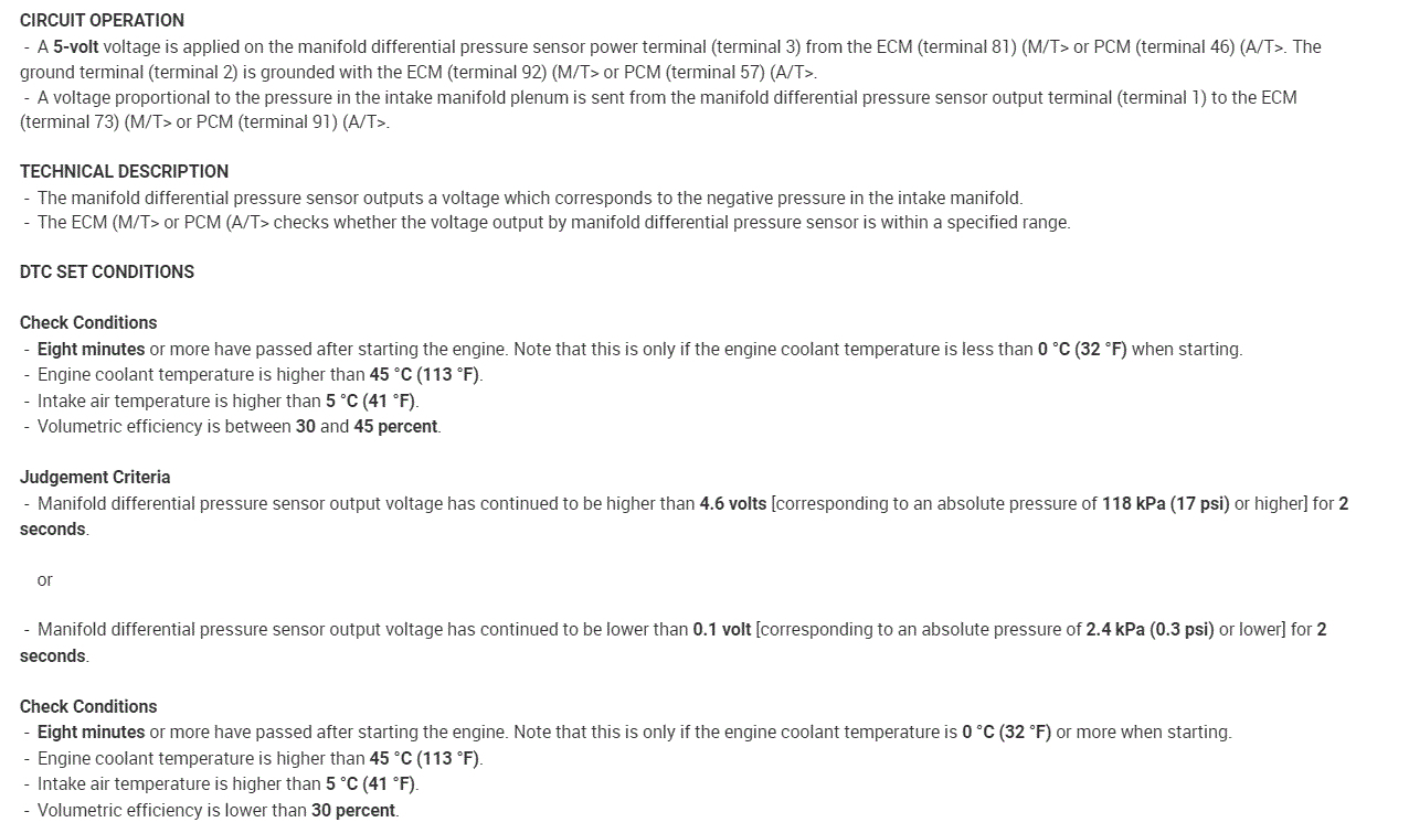

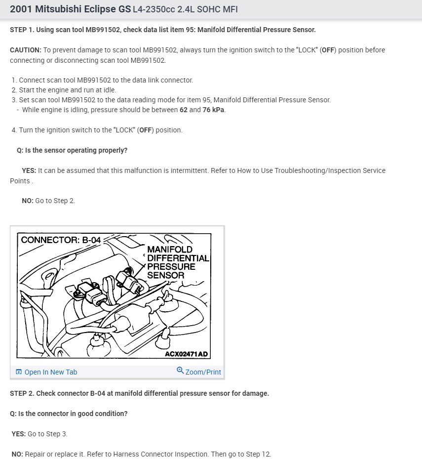

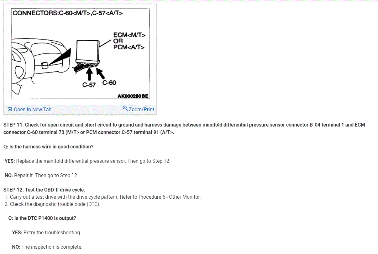

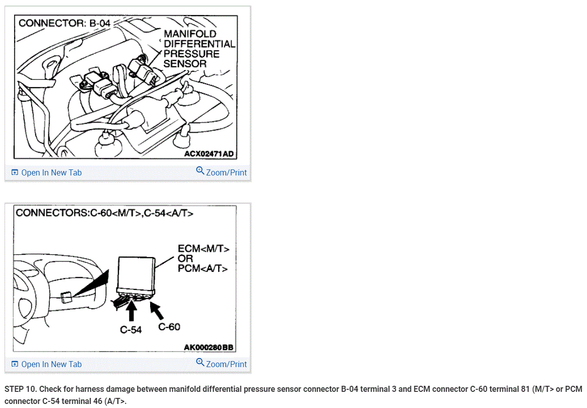

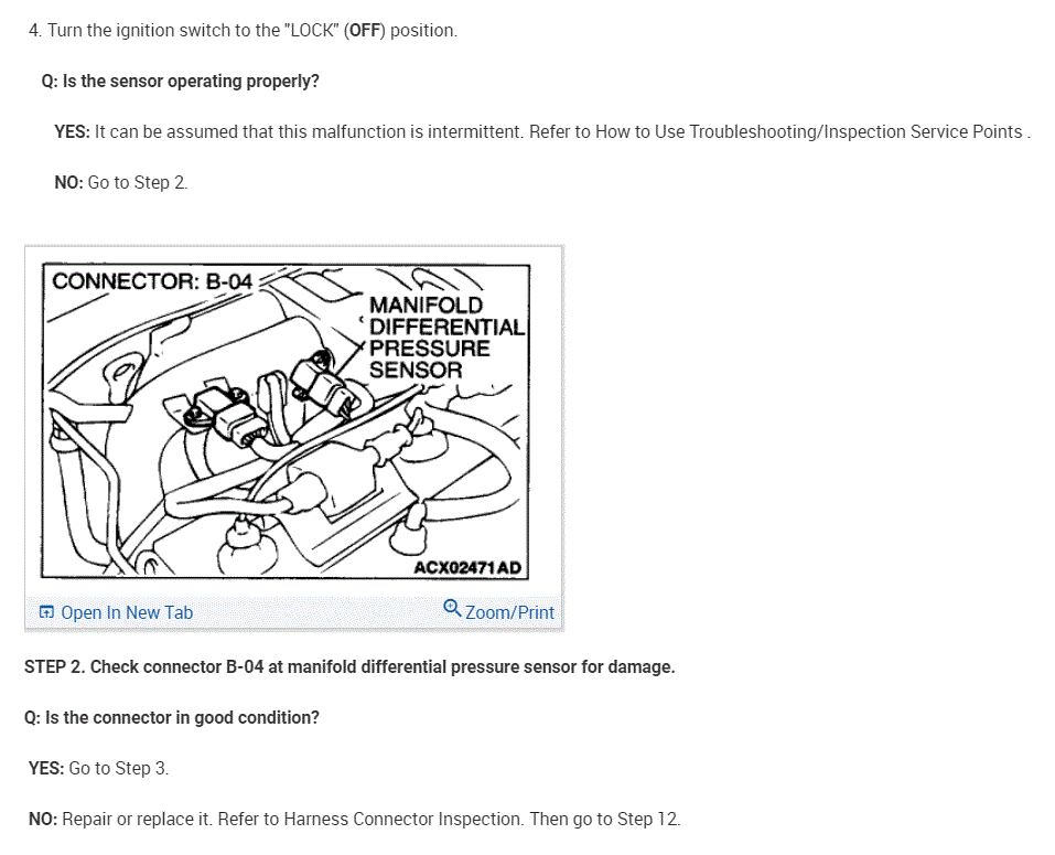

Yes, the manifold differential pressure and manifold absolute pressure is the same component for this vehicle.

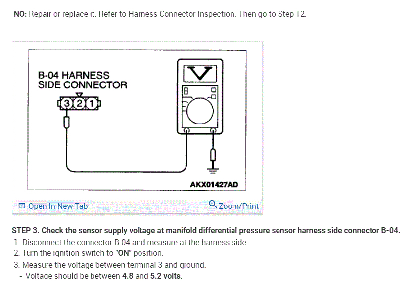

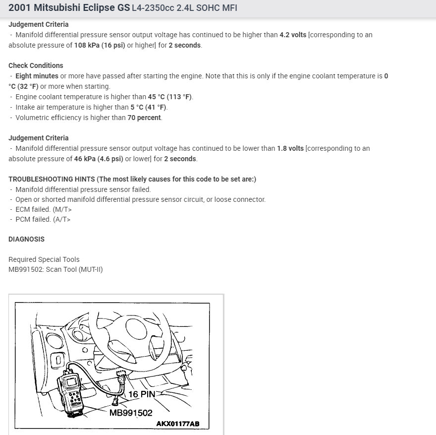

As you know there are a number of reasons why this code will get triggered. The best course of action would be to take a look at different possibilities.

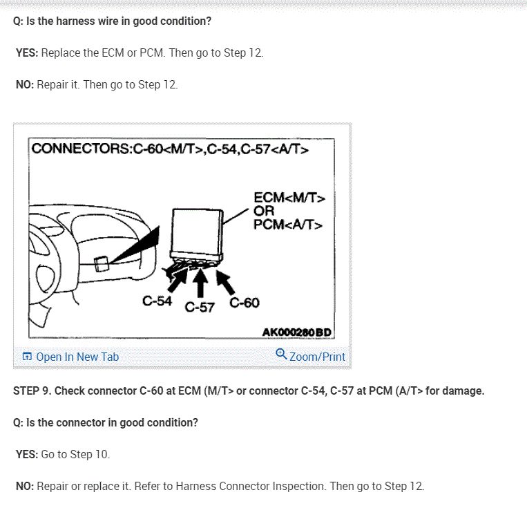

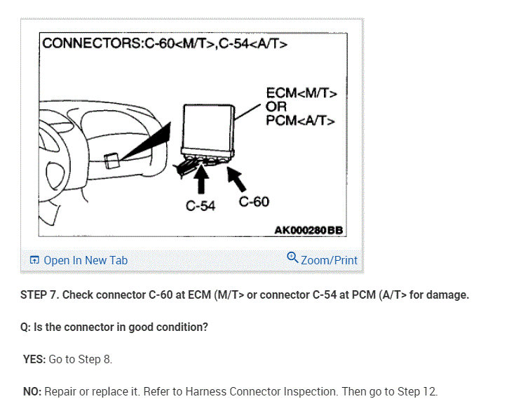

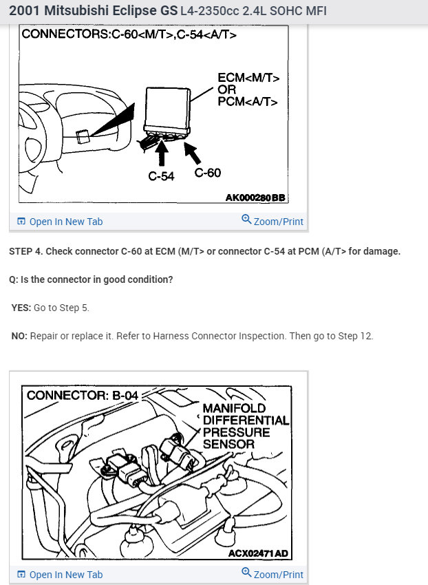

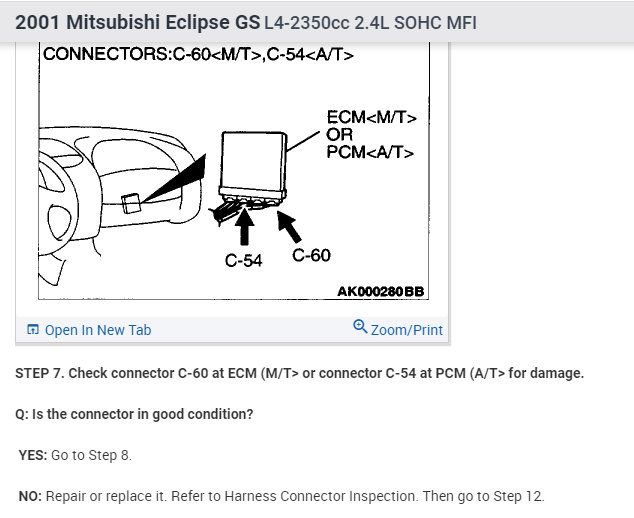

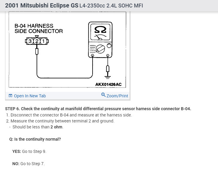

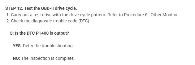

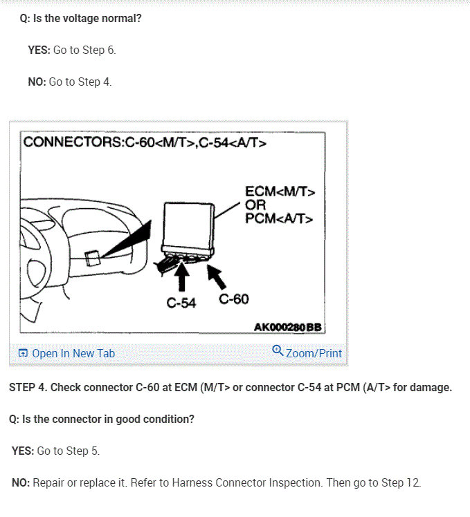

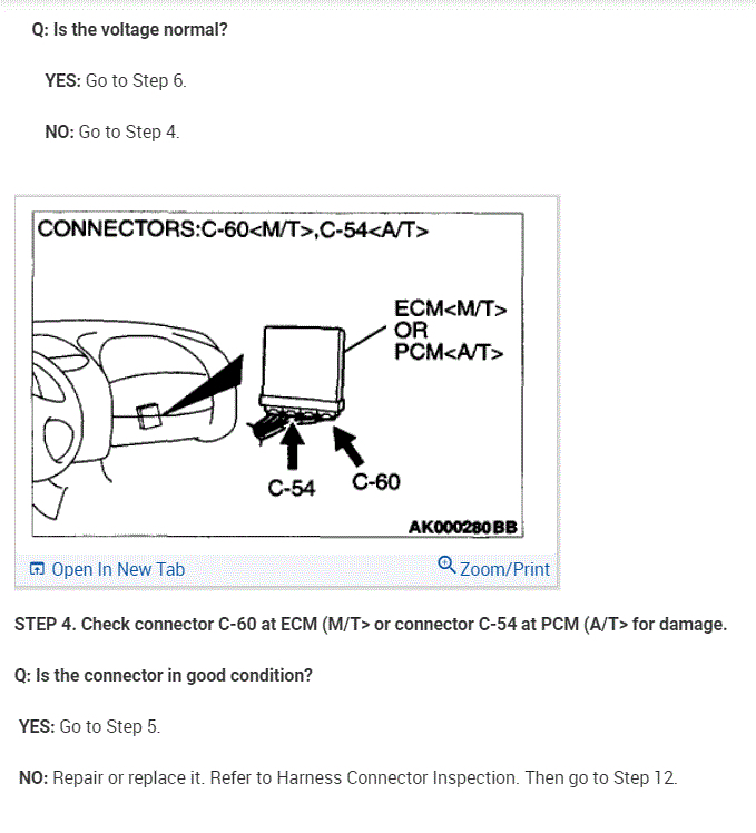

I have attached the troubleshooting steps for the code P1400 below.
Follow those steps as it can help you determine the issue.
Let me know what you find or if you have any questions.

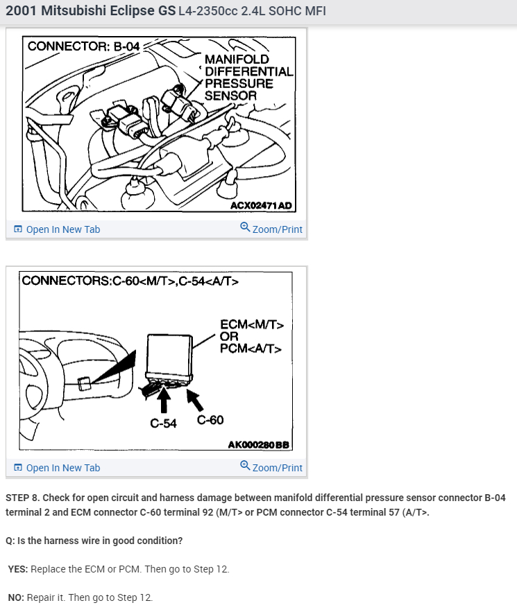

They are two different things. The MAP sensor provides a reading based on 0 pressure. On the other hand, the differential pressure sensor measures pressures at two different points in a system.
A differential pressure sensor is commonly used on a turbocharged engine. In this case, it isn't.
If you look below, I provided the directions/diagnostics for the code you have. Take a look through it and let me know if it helps or if you have questions.

My apologies for the slow reply to this. This turned out to simply be a broken clip on the connector for the MDP sensor. So this was simply a hacky fix using a few zip ties to lock the MDP sensor in place. I've had to do this with several sensors at this point as the plastic in the connectors has gotten stiff and brittle and has broken in many cases. Thanks for all the helpful information on MDP sensor diagnosis.
