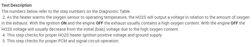

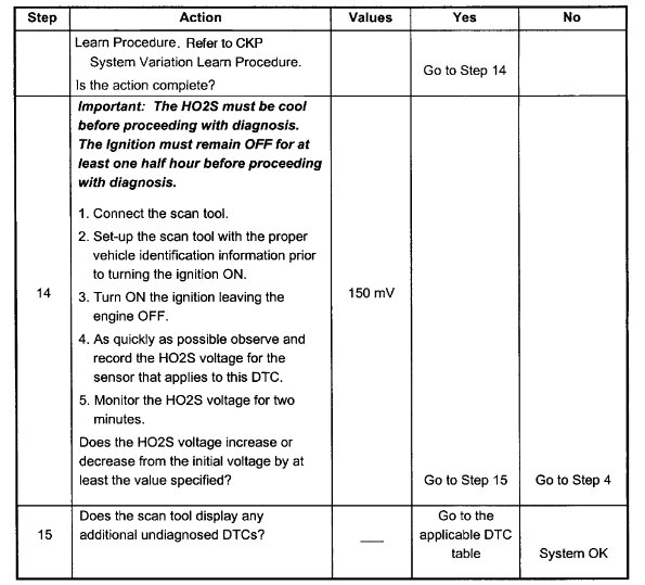

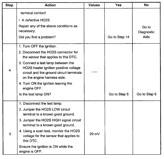

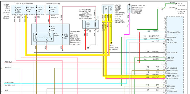

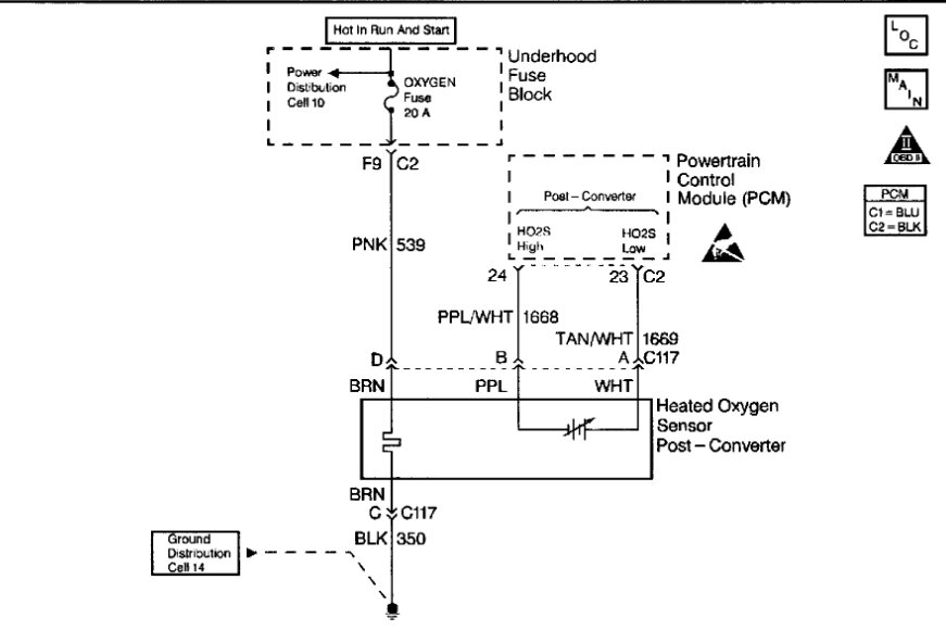

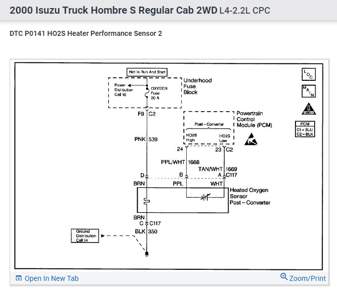

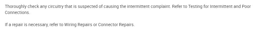

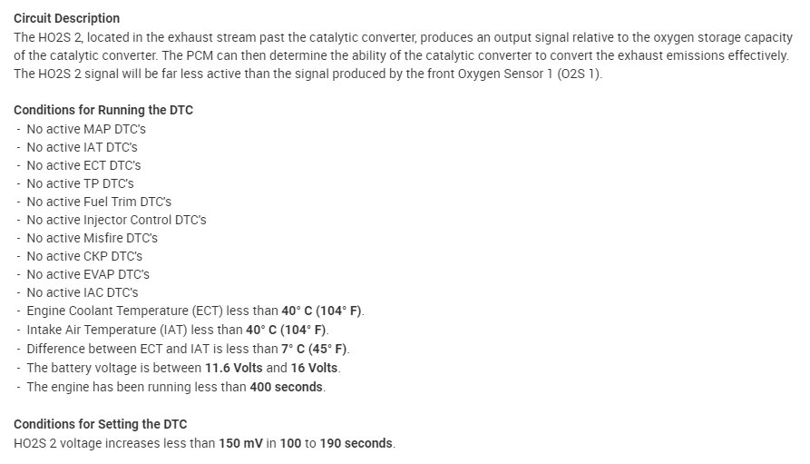

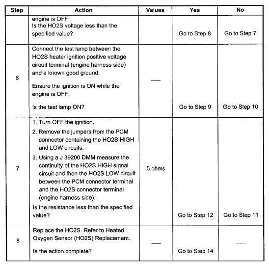

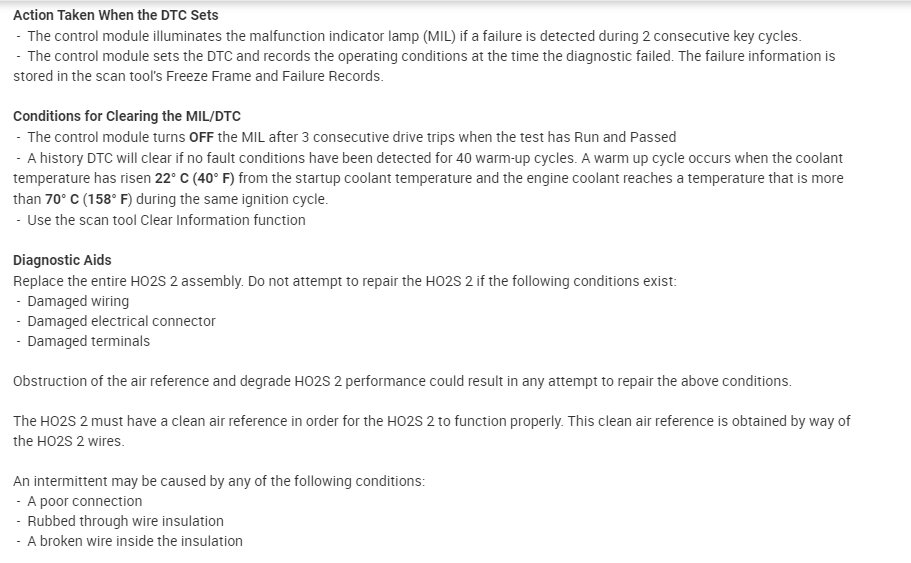

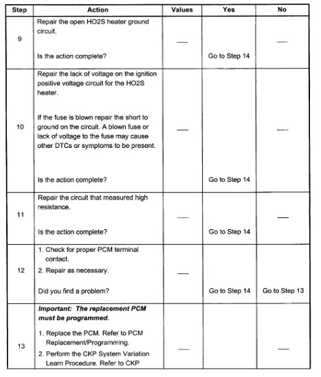

There should be four wires going to the sensor. One is ground, one is power for the heater, and the other two go to the PCM signal.
Keep in mind, sensor two will not be as active as sensor one, but you should be seeing voltage changes.
I attached a schematic below and the diagnostics for P0141. Po140 is similar. Go through them and let me know if it helps.
I have a feeling you have a broken wire under the insulation.
