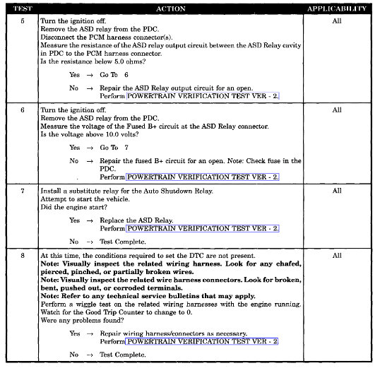

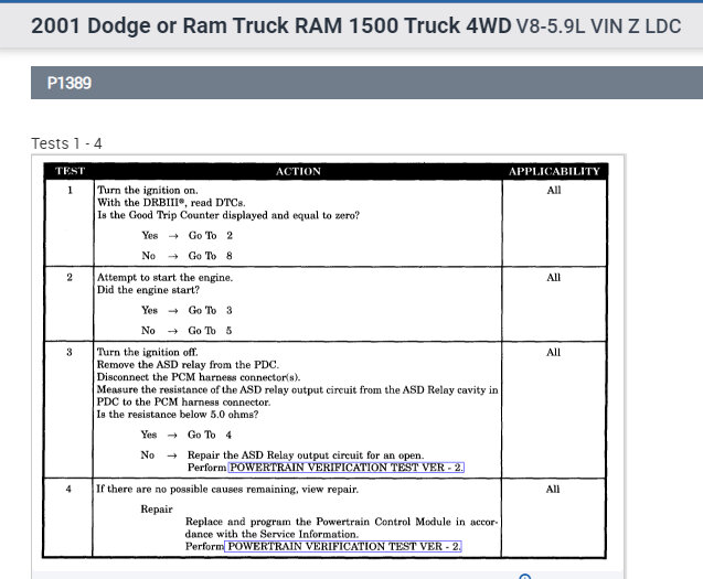

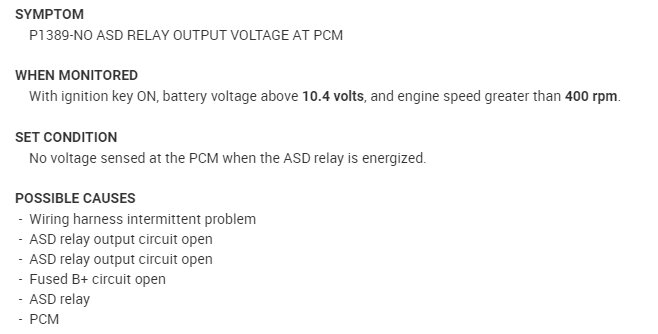

The code indicates there is no power to the PCM from the ASD. It sounds like you have already done a thorough inspection. However, I attached the diagnostics below. See if you have completed everything.
Additionally, if you have voltage to the PCM from the ASD, check the connector pins for damage or corrosion. If there is none, chances are the PCM has failed.
Let me know what you find.

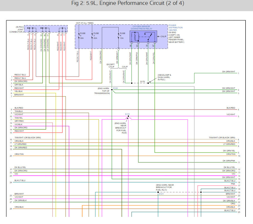

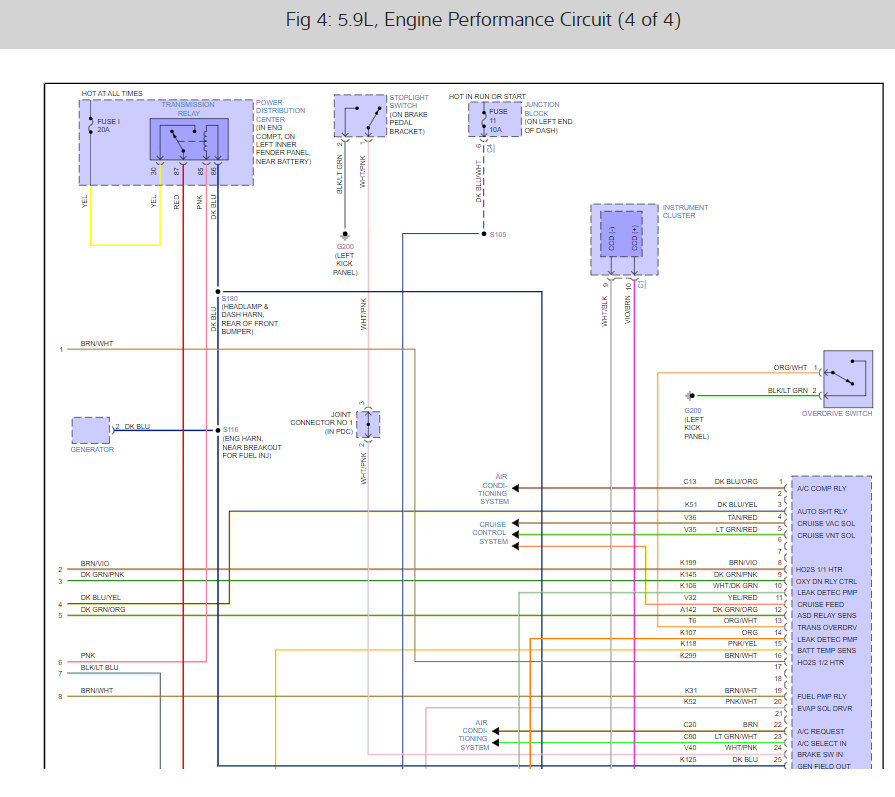

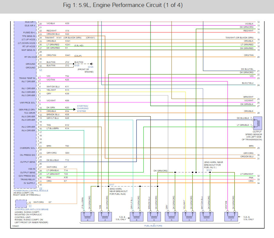

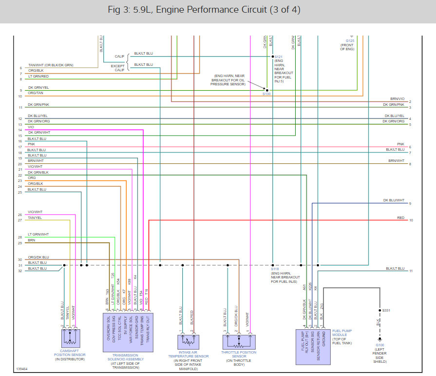

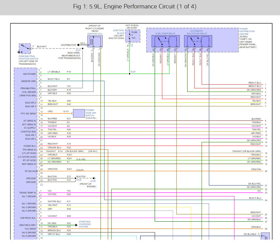

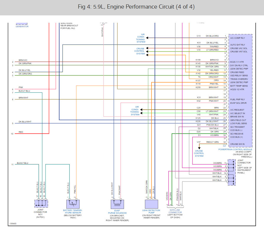

I would start by checking fuse #6 and Fuse "K" for power in the fuse panel under the hood. Even though the fuse is good there may be no power which feeds the ASD.
Here is a guide to help:

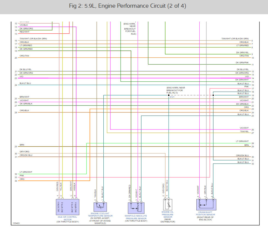

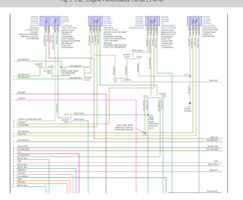

I have included the engine wiring diagrams as well so you can see how the system works

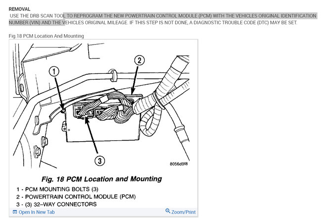

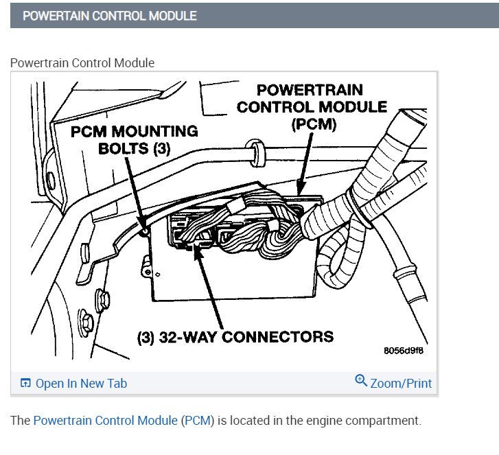

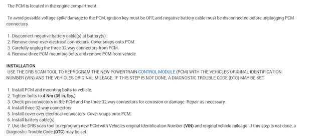

This post may help you as well. I have also included how to change the PCM out in case you need it.
https://www.2carpros.com/questions/i-have-a-question-about-a-code-i-got-from-a-code
Check out the images (below). Please let us know what you find. We are interested to see what it is.

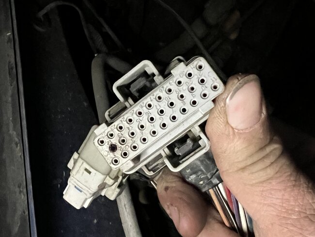

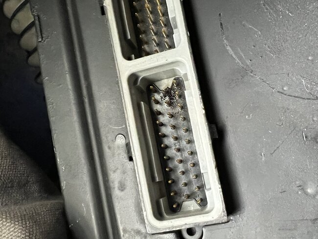

After many weeks of waiting, I finally received a refurbished PCM. Plug it in and it fires up! Great! Until I notice I have a new code that was not there prior (P1495 Leak Detection Pump Solenoid Circuit) and my Overdrive Off light is stuck on. So that’s not good. Extra not good after trying to start it for a second time after only running it for about 2 minutes it would only crank. So, I went back to the junkyard and just took a PCM out of a random truck I found (it was not for the same year, I only got it for testing purposes). Plug in the junkyard PCM just for yucks and then it fires up every time and runs great. No gauges work on the dash and shows “no bus” but that was to be expected. It runs perfectly fine though. Confused as I was, I plugged in the refurbished PCM that I got and only cranked once more. Take off the plugs at the PCM and see that pin 12 (data line for ASD relay) has been burnt and melted only with the refurbished PCM installed. So now obviously that must be fixed but could the PCM have caused that? Because I checked over the wiring prior and to my knowledge no wires are shorted or have excessive resistance. (The refurbished PCM was supposed to come already programmed to my VIN, so it said.)

I would contact the place that provided the refurbished PCM. If I had to guess, I would say there was an internal short within the PCM that caused the wiring to overheat.
Considering there was no issue with the used one, that is the most likely cause.

Place that I got the PCM from has been contacted and it’s going to be shipped back, inspected and a new one will be shipped to me. Last night I threw the junkyard PCM on and it still ran so definitely was a problem with the refurbished PCM. Now we just have to hurry up and wait for parts!
