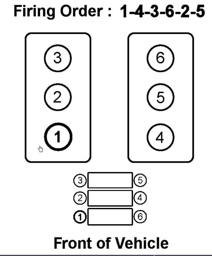

Also misfires 4, 5, 6. i m going to check the wires. is the bank 2 on the passenger or drivers side?
Aug 23, 2019 at 1:23 PM
Here is the layout. More than likely this is the sensor or the wiring so your approach is wise.
Let me know what you find. Thanks

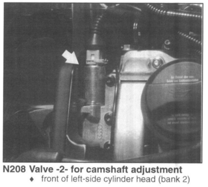

Hi, just to jump in the layout KASEKENNY1 posted would indicate bank2 is the driver side. Also with the code you have I would be looking at a faulty oil control valve. See image below.
Very common problem with all manufacturers timing and misfire codes on one bank. Just verify you have proper oil level. If okay the reasons the valves go bad is lack of maintenance.
