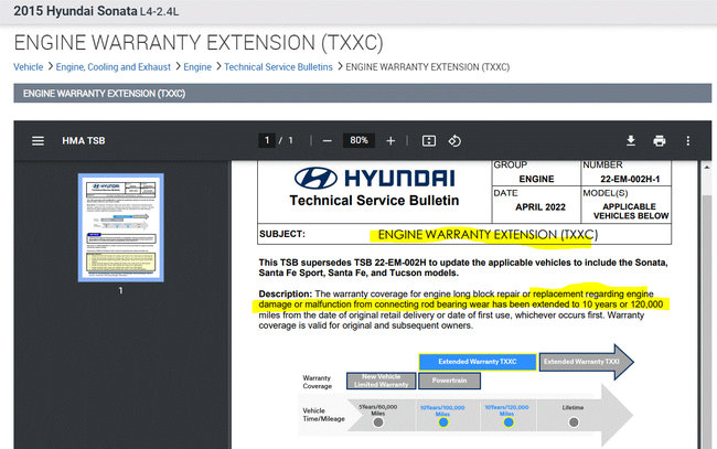

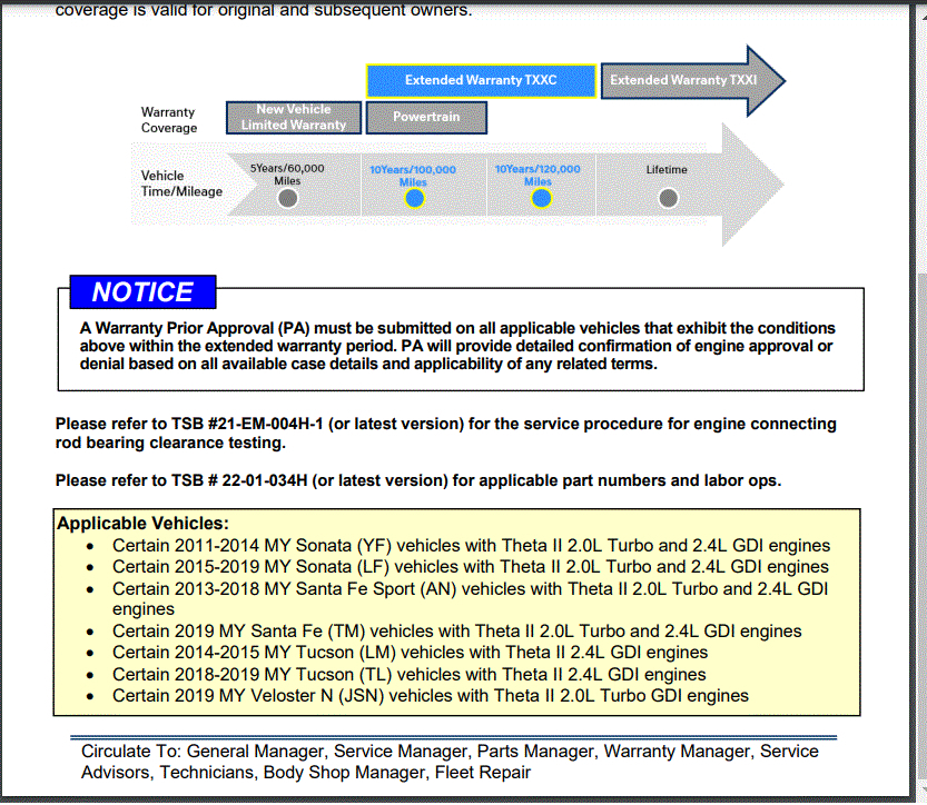

If you are unable to turn the engine at the crankshaft pulley, it is likely seized. I have a feeling the knock you heard was a rod bearing.
Hyundai extended the powertrain warranty for rod bearing issues. It was 10 years or 120K miles. See pics 1 and 2 below.
These things are starting to show up just out of the warranty extension. I just replied to another person with a 2013. He has a hole in the side of the block from the connecting rod coming apart. He is out of warranty by 5K.
Even though this one is further out, I would contact Hyundai and see if they will help. Even if they don't replace the engine, they may pay for part of it.
It's worth a try.
