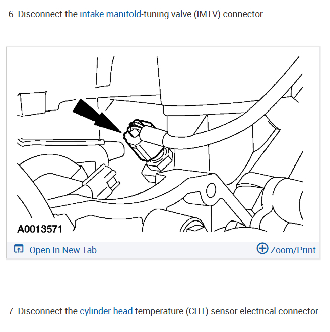

Code P1289, where is the cylinder head temperature sensor located?
2000 FORD E-SERIES VAN
250,000 MILES • 5.4L • V8 • AUTOMATIC
SAMUELK

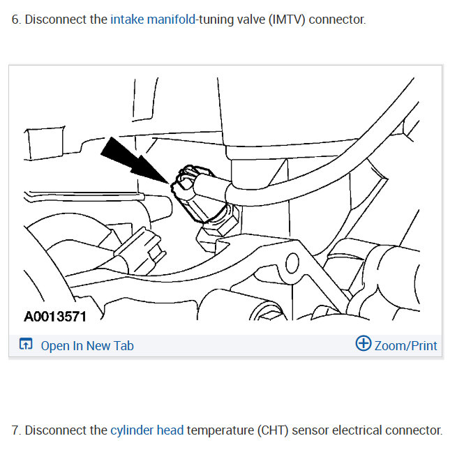

I cannot find the location of the cylinder head temperature sensor.
The vehicle starts and runs for about 10 minutes and shuts offand then it won't start again.
Feb 12, 2025 at 12:20 PM
  • 55,402 POSTS

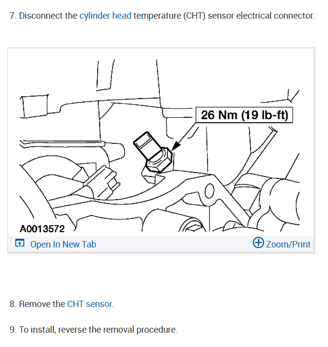

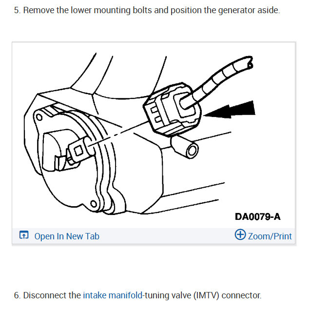

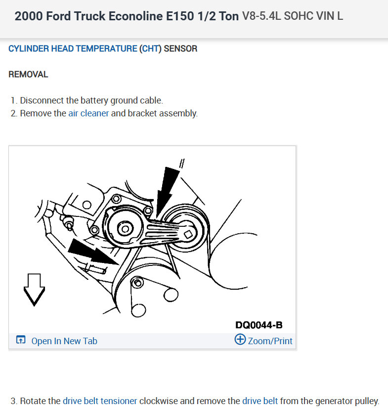

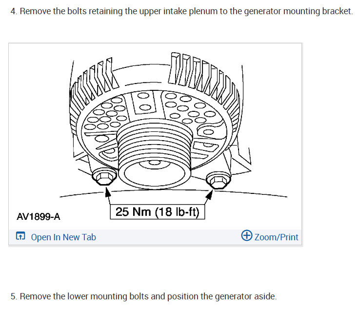

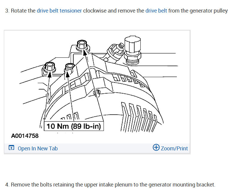

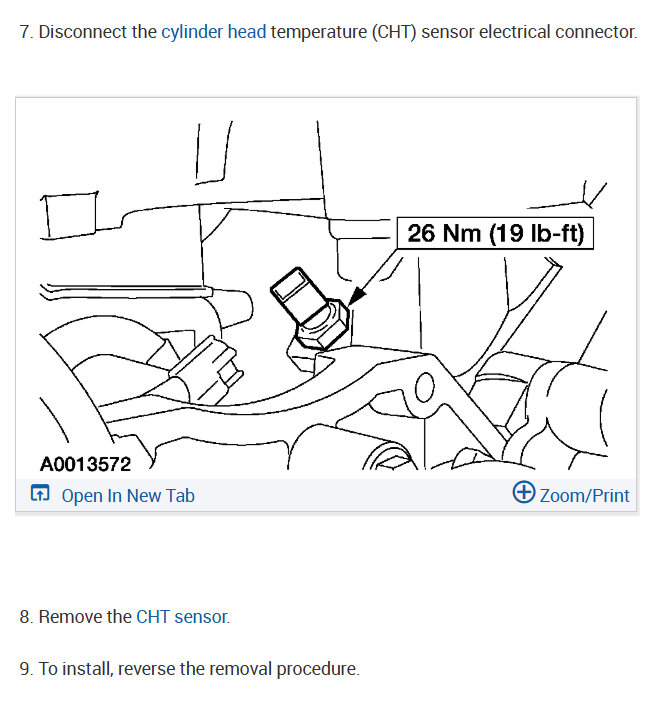

Yes, a shorted engine temperature sensor can cause this issue. Here is the location of the sensor so you can swap it out, also check the electrical connector because they can become damaged. It looks like you will need to remove the alternator so disconnect the battery first. Also, do not over tighten the sensor because it can damage it. Clear the codes once the job is complete. Check out the images (below). Let us know how it goes.
