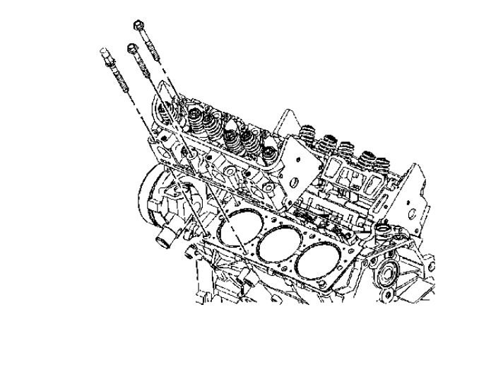

Code p1258, it goes in the overheat protect mode. cCar does not seem to be overheating, but it shuts the cylinders down. Blowing back through the coolant overflow. No heat.
Dec 6, 2018 at 12:04 AM
Good morning,
The engine is overheating and yes, the PCM does shut down groups of cylinders trying to cool the engine.
https://www.2carpros.com/articles/symptoms-of-an-overheating-engine
The fact that you have coolant pushing back in the overflow tells me you may have damaged a head gasket from the overheating.
I suggest having the cylinder leak down test performed to verify a failed head gasket. If it shows a failed gasket, that is the result of overheating not the cause.
