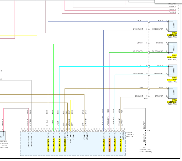

After replacing intake and valve cover gaskets the car starts up rough and I get this code and a cylinder 3 misfire code. Not sure what I did wrong as it was a straight forward repair. Any tips on tracking this down?
Feb 23, 2023 at 2:03 PM
  • 110,194 POSTS
First, check to make sure there isn't an engine vacuum leak. It would be odd for a leak to affect only one cylinder, but the intake gasket may be leaking for cylinder three. Follow the directions in this link and let me know what you find:
Next, if there are no leaks, confirm the coil pack and fuel injection wiring are properly connected and none of the pins in them were bent or damaged. Also, make sure the injector isn't leaking.
If that checks good, check to see if there is an ignition spark to cylinder three's spark plug.
Here is a link that explains how to check:
https://www.2carpros.com/articles/how-to-check-for-ignition-spark
Start with these things and let me know what you find. Chances are it is a simple mistake. Also, let me know if that is the only code present.

Yes, it would be weird considering the intake gaskets are new. I have it apart again, and everything was connected as it should be, but is there a pin-out for the harness going to the injectors? Maybe I can probe it to check for a short, and go to the junkyard and get one. The code P124A says the circuit shorted to main control, whatever that means.

I am questioning if the number 3 injector is the issue.
As far as the wiring, I attached the fuel injector circuit schematic below for your review.
Let me know what you find.
See pic below.

Well, p124a says it's a positive circuit shorted to the control. Well, that's what happened. I pulled the harness and saw the two wires had broken insulation and were touching. Fixed it up with some electrical tape and we're good to go. How silly!
