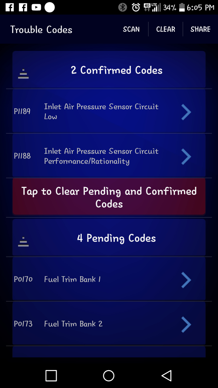

After replacing CCV I am receiving these codes and rough idle at start up.
Jun 17, 2018 at 4:29 PM
  • 54,832 POSTS
Please clear all codes and with the scanner still connected turn the key to the on position without cranking the engine over to see what comes up. Does the engine run?

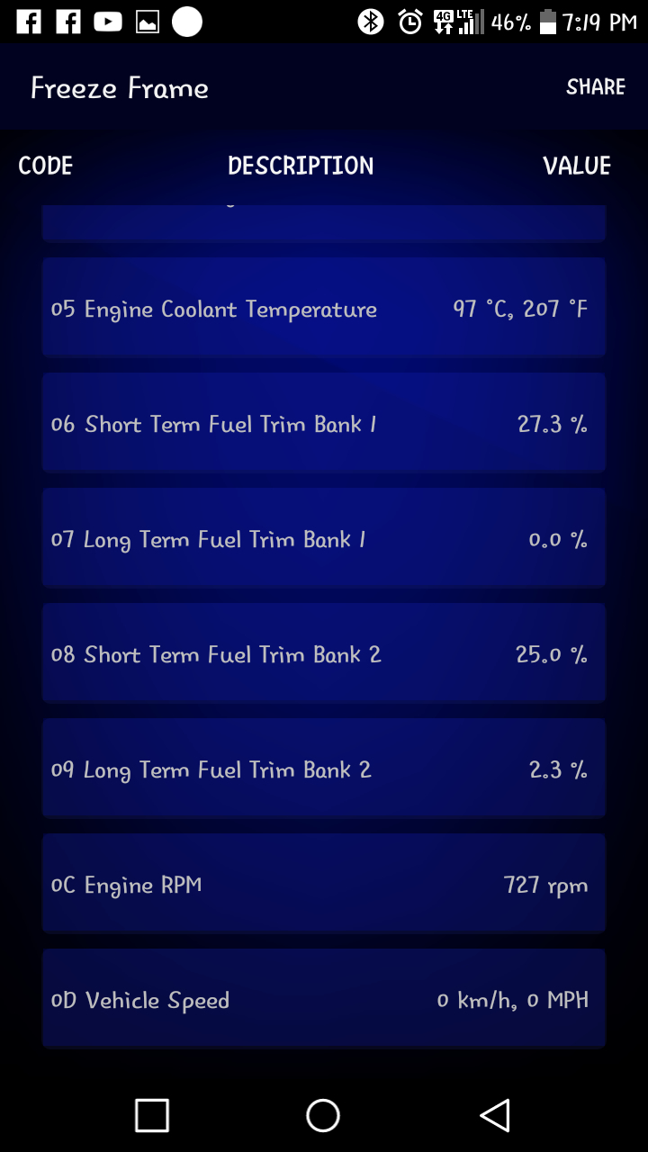

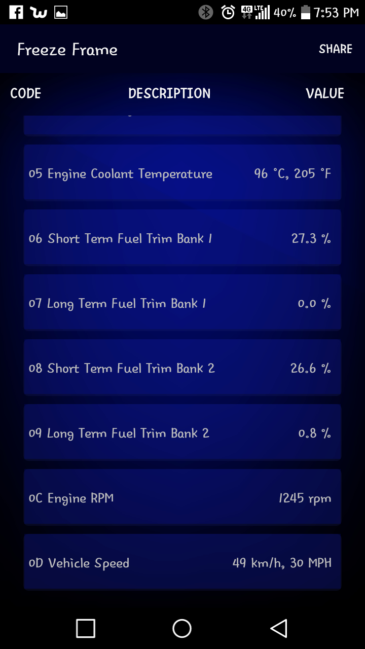

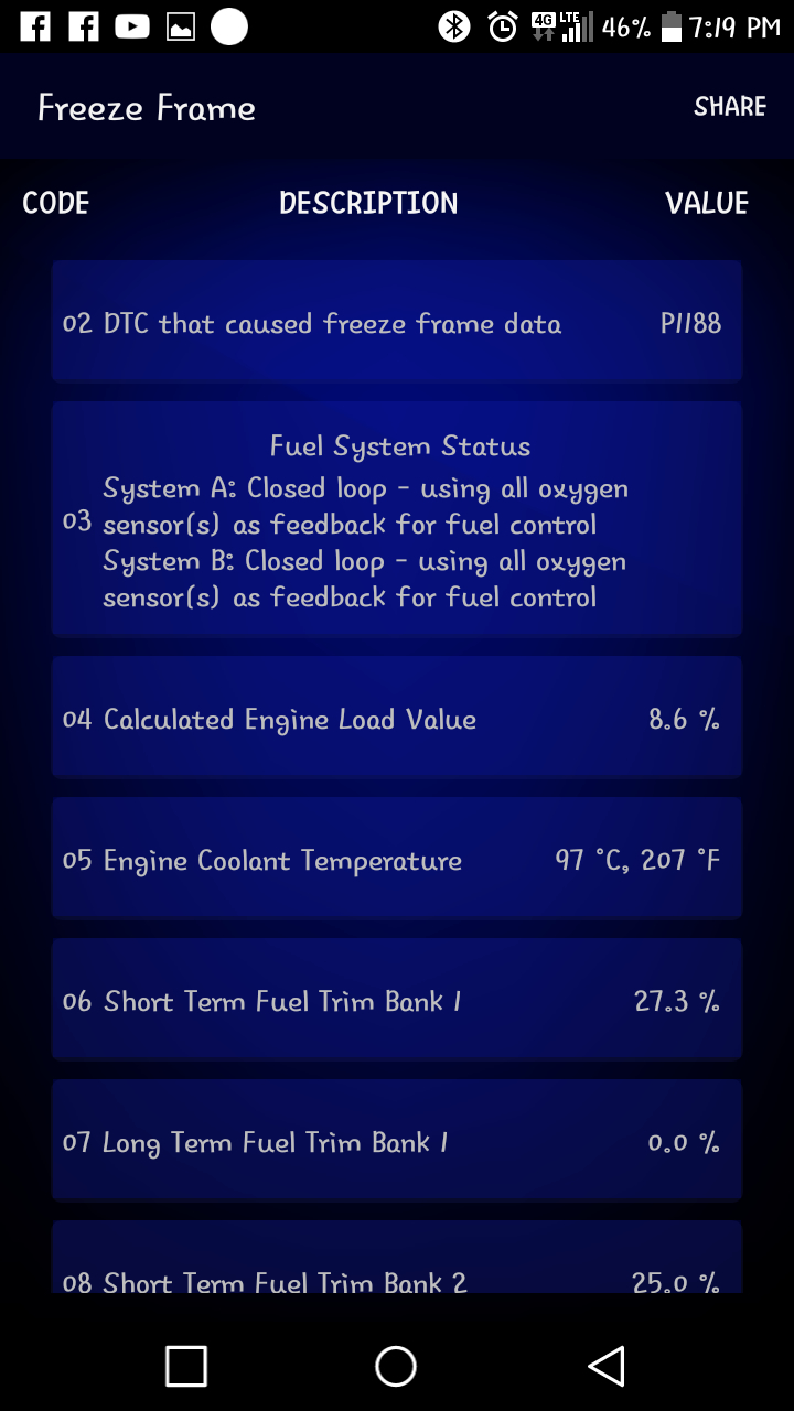

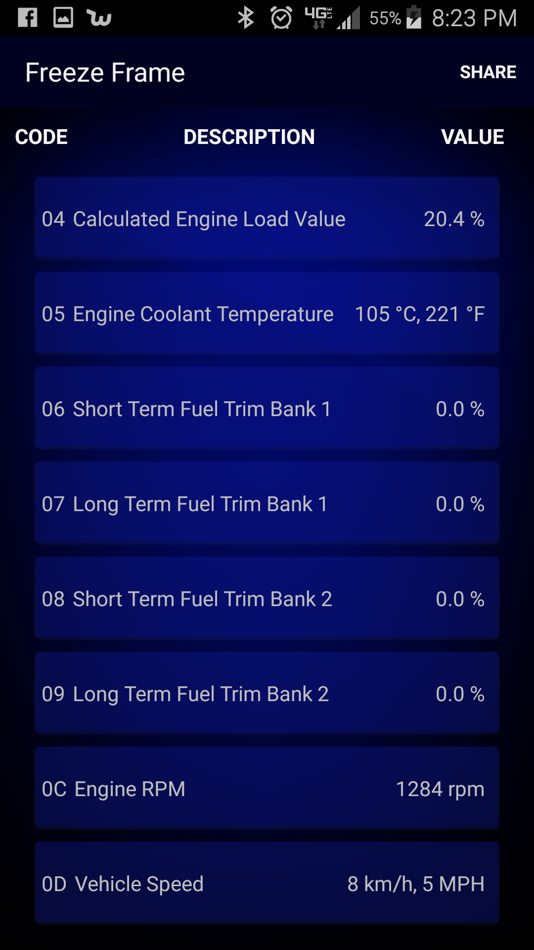

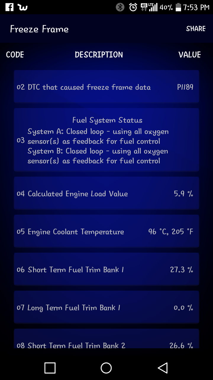

I got it back running cleared the codes and it came back. Here are recent freeze frames.
Jun 20, 2018 at 5:12 PM
ZELLDOG93
  • 111 POSTS
It has got bad lag causing traction to activate and rough start up idle and poor idle when stopped.
Jun 20, 2018 at 5:14 PM
  • 54,832 POSTS
By these numbers is looks like the MAF is having an issue which can be caused by a MAF sensor problem or a partially clogged catalytic converter. Here are two guides to help us see what the problem is:

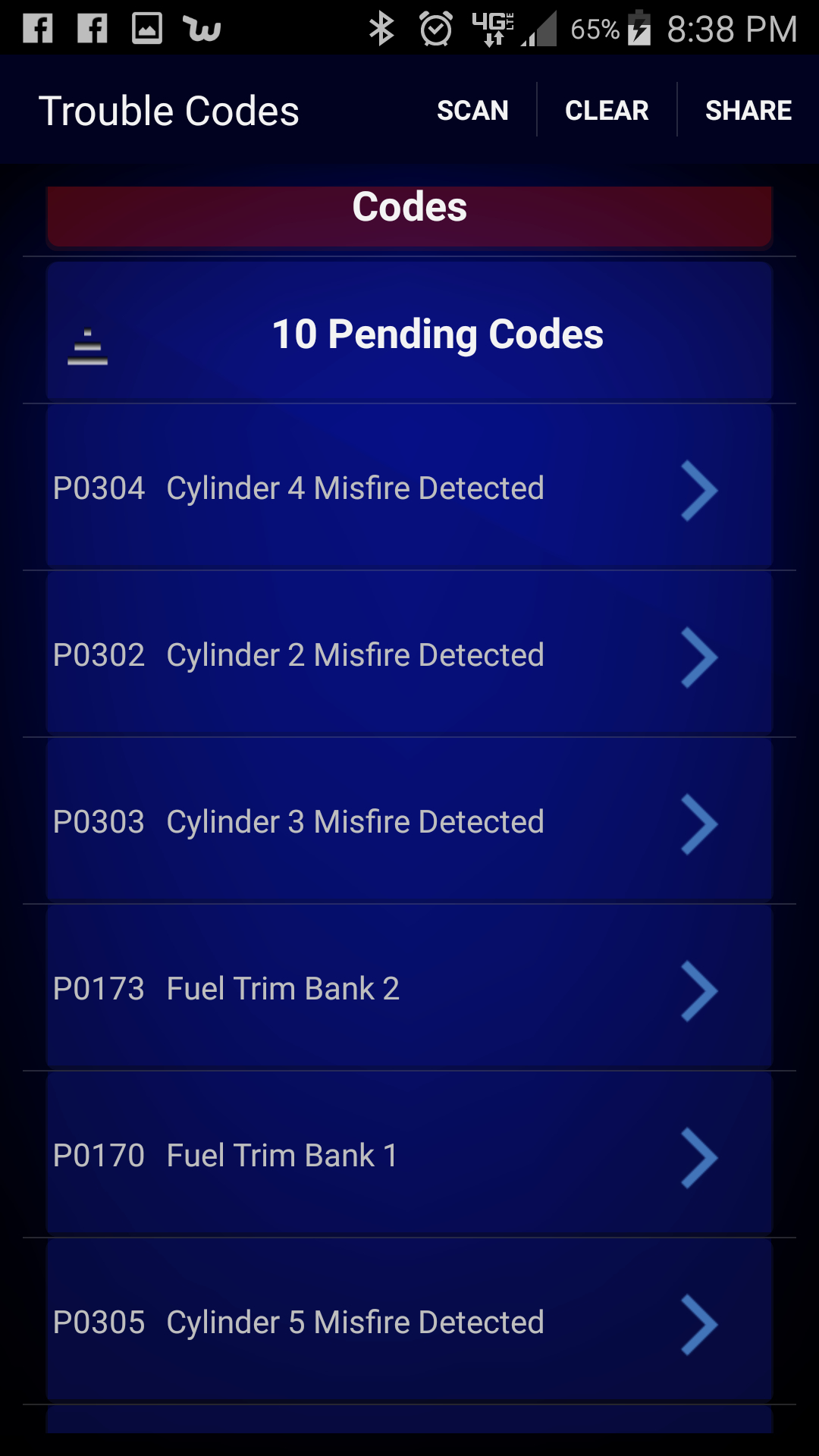

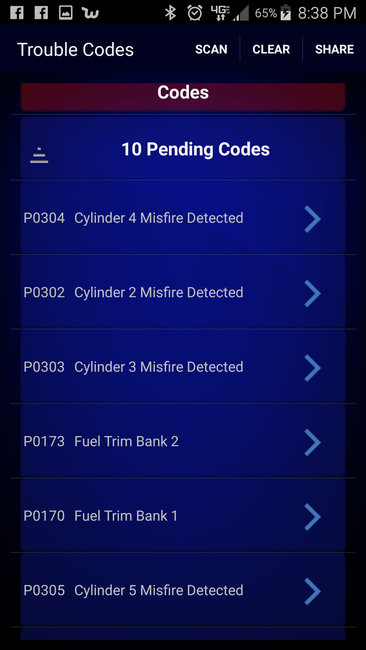

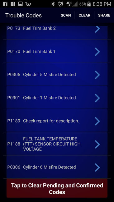

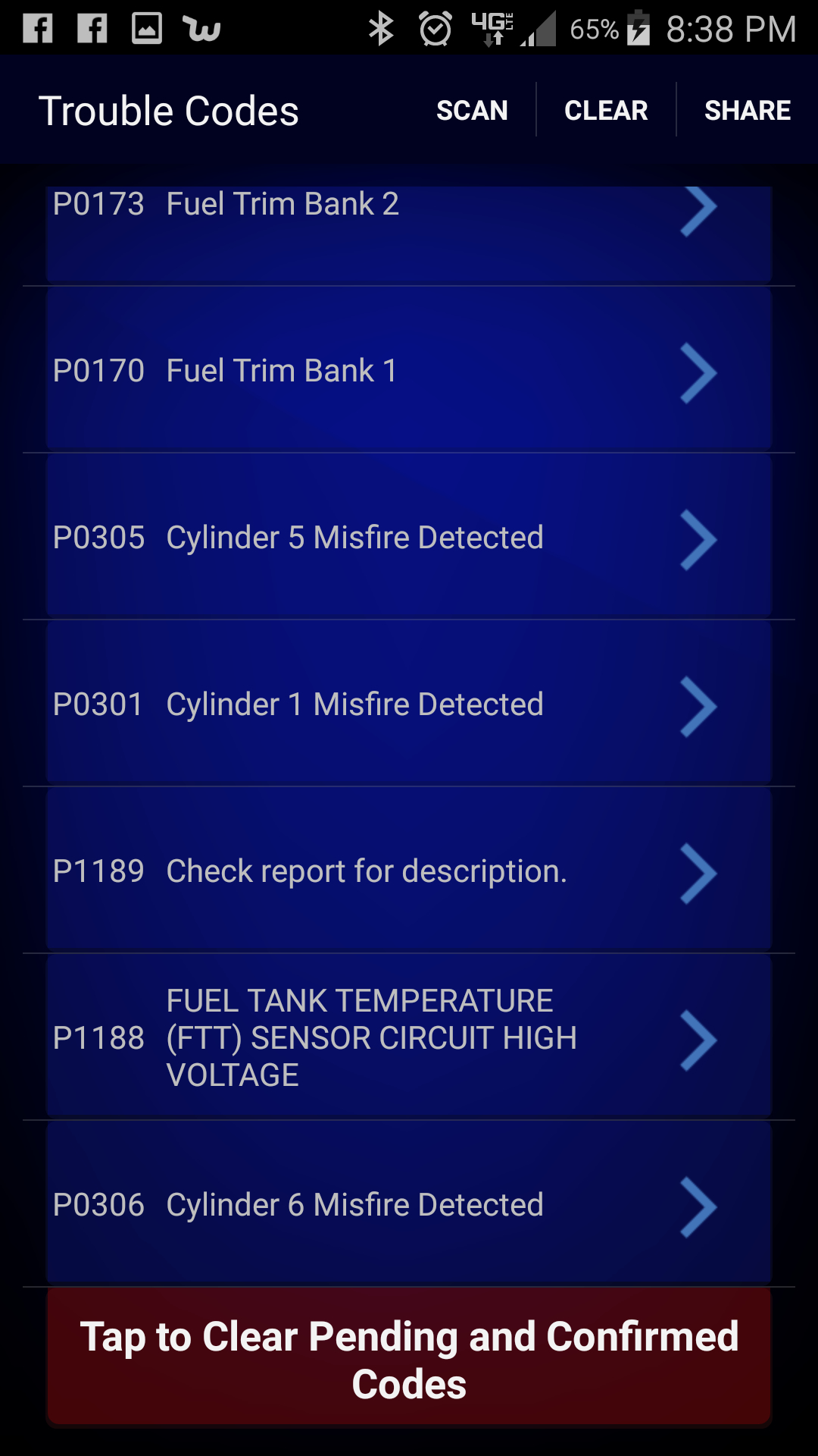

Sorry, I just saw this. I am more concerned with the check engine light. I got a new MAF and installed in no light, but I am getting this now:
Jun 25, 2018 at 5:38 PM
ZELLDOG93
  • 111 POSTS
These misfires appear when at idle.
Jun 25, 2018 at 5:39 PM
  • 54,832 POSTS
How does the engine seem to run? If okay I would say the computer is having an issue. Please remove the PCM and look for water damage. If you clear the codes and then just turn the key on without starting the engine do any codes come up?

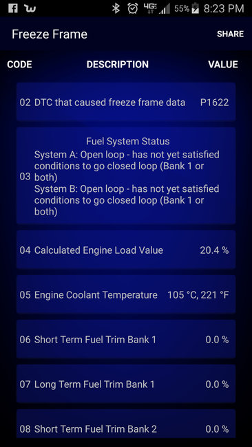

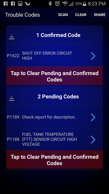

The first code to pend is p1622.
Jun 27, 2018 at 3:56 AM
  • 54,832 POSTS
This code is for the thermostat sticking open which can cause some issues. Can you please remove it to see if it is stuck open?

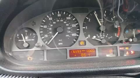

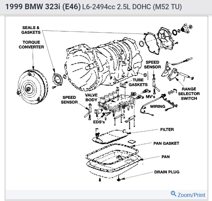

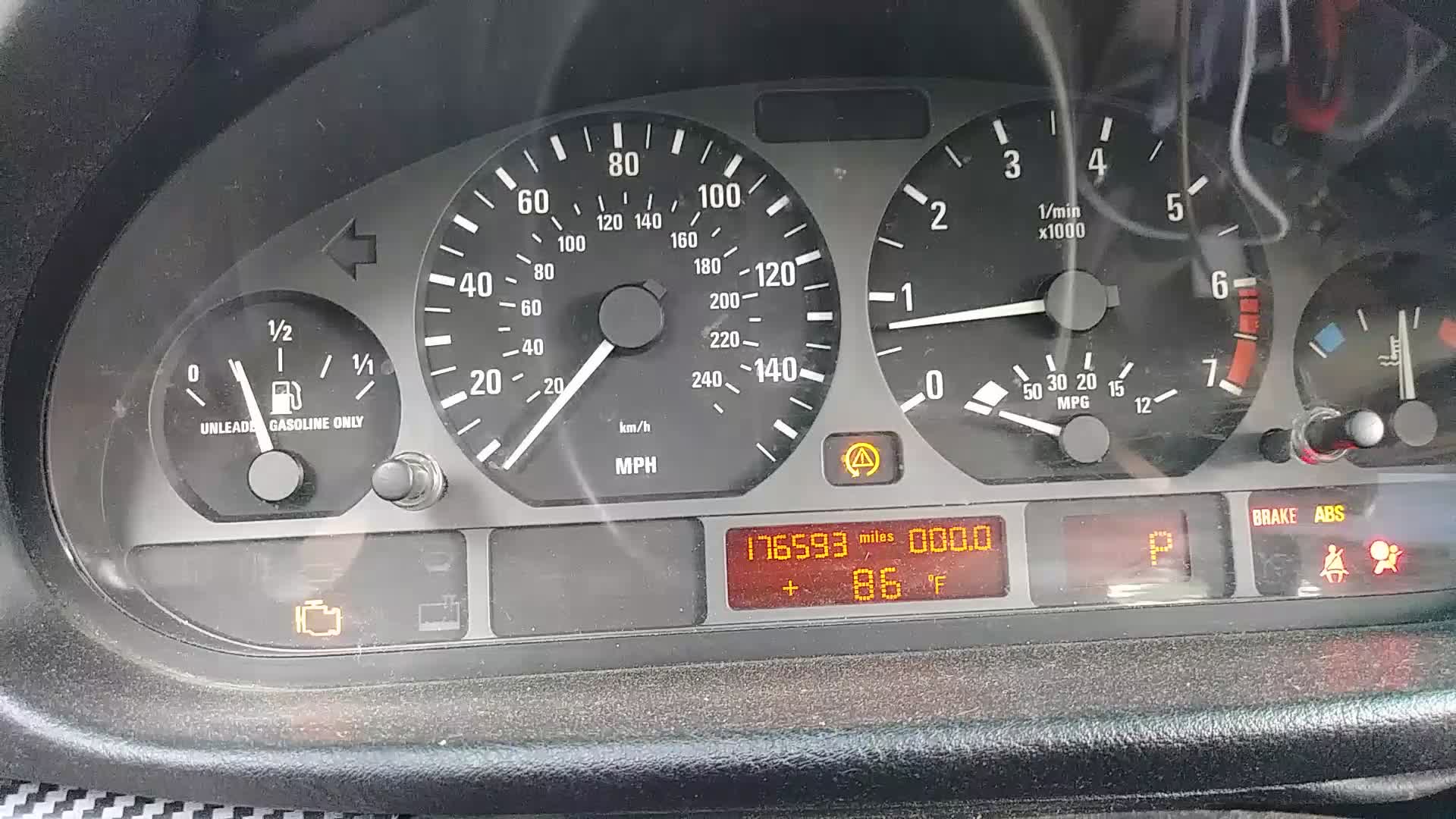

Let me know if you need more my speedometer is currently inop 7.
Jul 16, 2018 at 7:59 PM
  • 54,832 POSTS

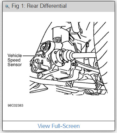

If the speedometer is not working that would indicate the vehicle speed sensor is not working. Here is its location so you can swap it out.
It sounds like the engine is running good from what I could hear.
Check the plug maybe it got bumped in the repair somehow.
Check out the diagrams (below). Please let us know what you find.
Jul 17, 2018 at 11:33 AM

So I went to replace the speed sensor that supposed to be on the differential and I cannot seem to find any harnesses or anything that looks like the sensor has be deleted. Is is possible the speedometer is read through right rear ABS?
Jul 22, 2018 at 1:18 PM
  • 54,832 POSTS
I found more information that they put them to two places. Here is the one that is in the transmission. Check out the diagrams (below). Please let us know what happens.

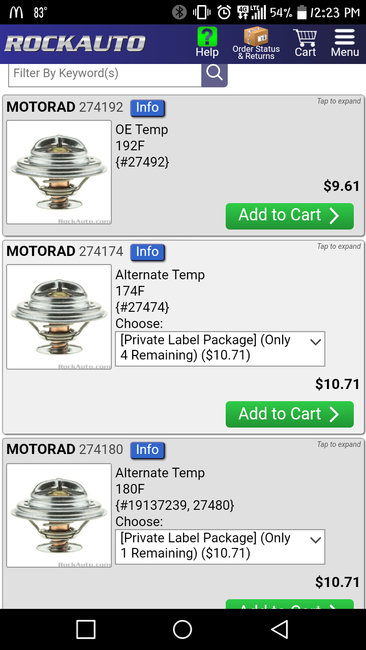

I am going to be getting an order ready. What would be best temperature wise to install for the thermostat?
Jul 27, 2018 at 9:24 AM
  • 54,832 POSTS
I would go for the 192, because the computer needs to see heat to go into closed loop sooner.

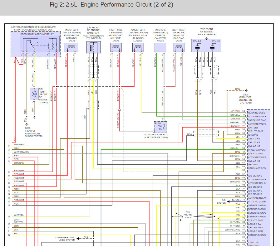

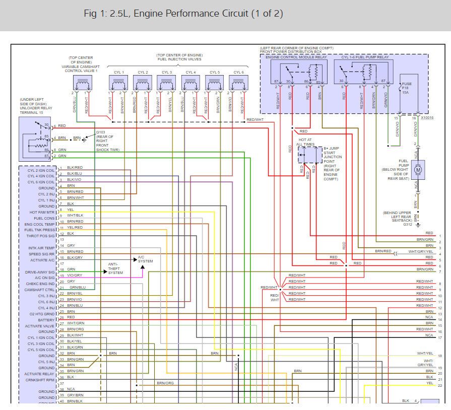

Okay thank you. I noticed it is running around 226. Also getting a code p1622. So I am thinking I have a wiring issue as well.
Jul 28, 2018 at 12:20 PM
  • 54,832 POSTS

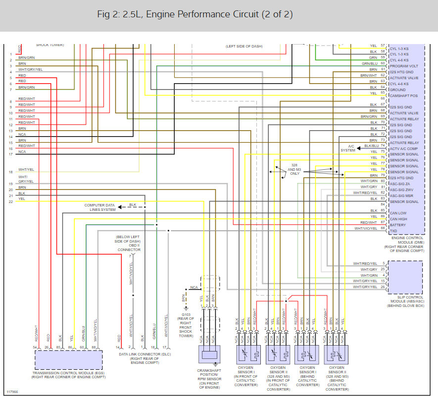

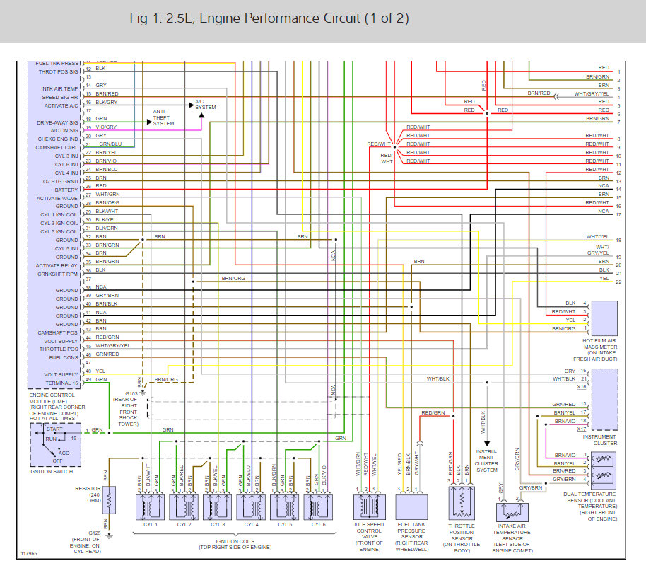

It does sounds like a wiring issue. here is a guide to help you test the wiring and the engine wiring diagrams please make sure the wiring is going to the correct sensor because BMW does not use dedicated connectors:
Here are the engine wiring diagrams below.
