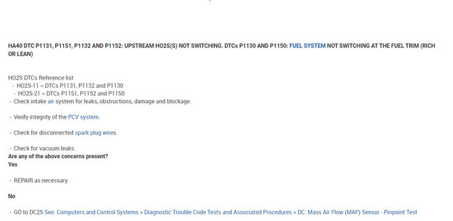

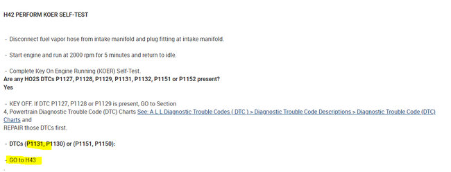

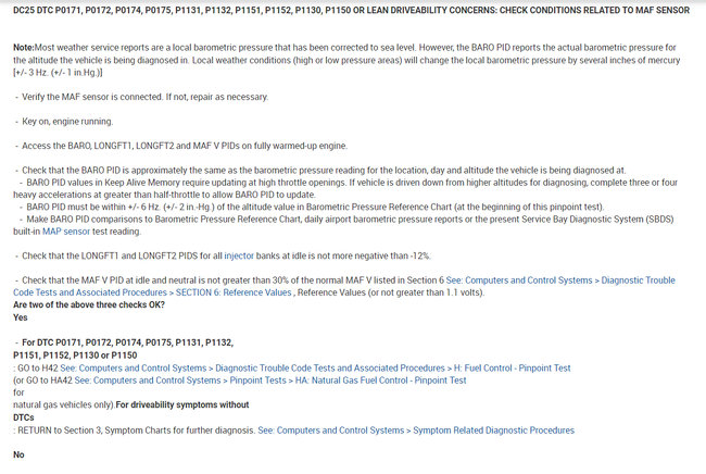

Good to hear from you. I hope everything is okay now. As far as the issue, I found info on the code in a different manual. The only concern is it jumps all over the place as far as diagnostics based on if other codes are found.
If you look below, I attached an example of what I'm referring to. Look at the end of the check and note it says go to a different test based on different variables.
Are you expecting to get a scanner soon?

Wow! i have never seen anything like that before. I had no idea that kind of test could be performed on a vehicle. The page in the middle that you are providing is very helpful but i don't know of anybody smart of enough to perform that test on my van, lol. And i can't reach it to perform it myself etc. Also too since the last time i wrote you guys the check engine light went back off again. Something isn't right. but i sure need to find out what. And far as the scanner goes. I plan on ordering it as soon as possible / hopefully before something else pops up. I will let you know as soon as it arrives. Surely this scanner will pen point something. Also, if someone doesn't mind could someone please tell me how many o2 sensors does a 2000 Ford e150 v6 4.2l van suppose to have. a friend of mind says it has 4 but i thought it only has 2.

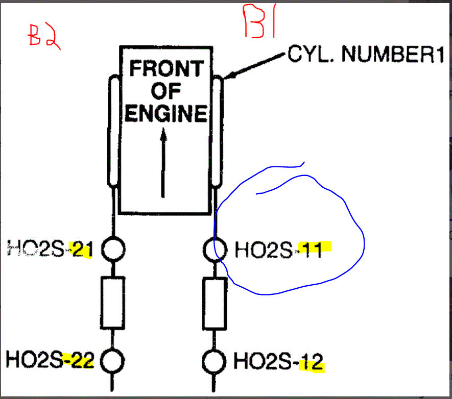

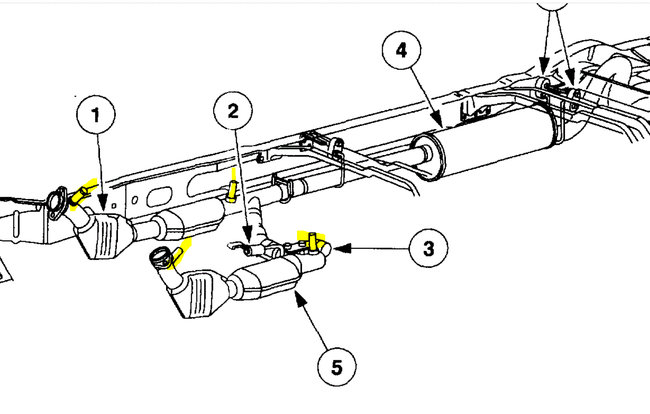

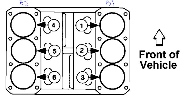

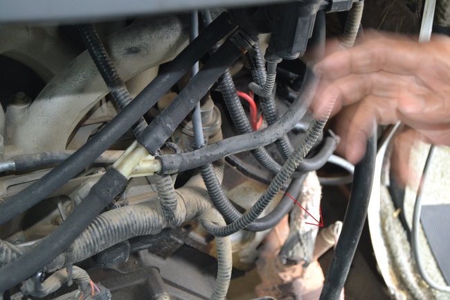

It should have four. I attached two pics below. The first is a pic of the exhaust system. I highlighted four places to check.
If they are there, then look at pic 2. It identifies the sensors positioning. I placed a B1 and B2 on the page. That stands for bank 1 and bank 2.
Now, there are two sensors for each bank. They are identified as
HO2 11 and HO2 12 and HO2 21 and HO2 22. The first number identifies the bank (engine side), and the second number is which sensor, the first or second from the engine.
To determine which one needs to be replaced, you need to know if it is bank 1 or 2 (handwritten) and then if it is sensor 1 or 2. For example, bank 1 sensor 1 would be the one I circled in blue.

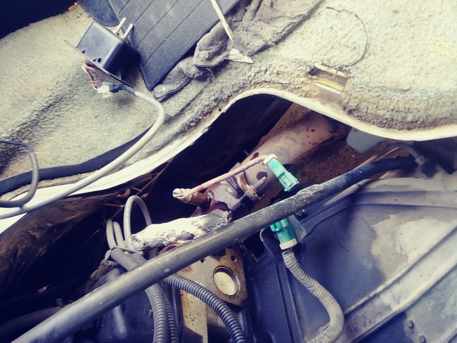

Hello there. First i must say i love how you did your diagram. It was easy to follow. But i do have a question. in picture 2. the one you drew the blue circle around. Say for example if i was sitting in my van behind the steering wheel facing the front of my van the sensor labeled HO2S-11 would be on the passenger side of the van, correct? If so i have always thought that the driver's side of the van is where bank 1 was located. Also, by the way someone hooked a very low budget scanner to my van and the error code they come up with was the same p1131, but it also said it was upstream 02 sensor Bank 1. And if that is located in the where i think that is located in the photo i am going to try and upload on here. That sensor looks as though it has never been changed ever!! But the one in your diagram that says HO2S-21 has been replace. I will up load the photo. In the picture where you see my hand is lol the little red arrow points to the o2 sensor (on the passenger side of the van if you are sitting in it). that looks like it has never been changed ever. HO2S-22 and HO2-12 I can't see them at all of course etc. And in the picture that doesn't include my hand in it. you can see that one has been replaced. because it looks new and everything etc.
Oct 20, 2021 at 5:33 PM
  • 110,251 POSTS

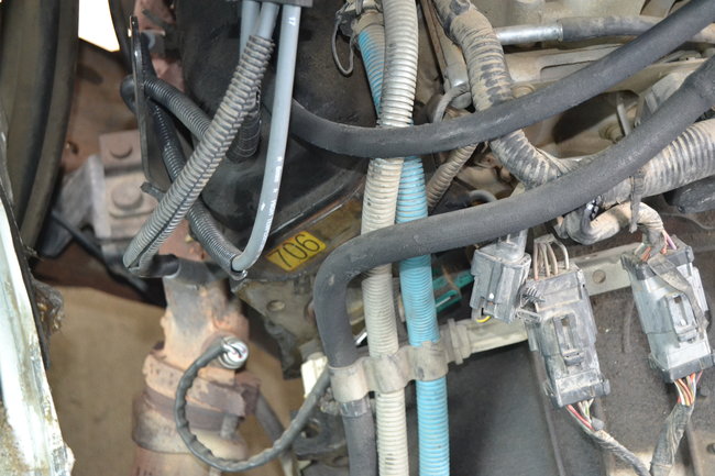

Yes, the passenger's side of the vehicle is where bank 1 is located. Bank 1 contains cylinder 1. If you look below, there is a pic that shows cylinder locations. I placed a B1 and B2 to identify banks.
As far as the "upstream" sensor, that is correct. Sensor 1 is always upstream from the catalytic converter. Downstream will be after the converter.
If the pic with your hand in it is the left side of the engine, and I think it is, that is bank 1 sensor 1 that you say looks new. If it is, we need to get our hands on a live data scanner so we can determine if the sensor is good.

Hello there. well, no, the picture with my hand in it shows that it hasn't been touched. It's very old, it looks as though that thing has been there since the van was made, lol. Anyway, i am glad you brought up the scanner thing. Some said they may help me get a scanner and i was wanting to ask is this one right here a step up from the one you picked? https://tinyurl.com/3nj9f6y3 just asking is because i have never bought a scanner before etc. I want to get the best model i can for under $200.00 etc

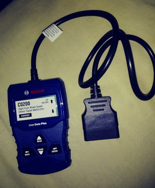

That looks like it would do a lot for you. However, I don't see anything that indicates it can read the CAN. Since this is a tool you will have for a long time, the newer the vehicle, the more you need the CAN diagnostic option. If I haven't mentioned it before, CAN stands for controller area network. This is a network made up of a few wires that attach all the modules/computers together. This type of scan tool should be able to retrieve codes from any module on the vehicle. I only mention this because as mentioned, you'll have it for a long time. As you get newer vehicles, the more likely this option will be needed or appreciated. LOL

Well i finally got my scanner. It came in finally but now, but i haven't had to use the new scanner yet because i injured myself some kind of way getting to the 02 sensor. I fractured my right knee. Not to worry guys though my knee has already been operated on and i am okay. just know we did get the old 02 sensor out and the new one is in there. Right after me and my mother finished putting the new 02 sensor in there i went to the hospital etc . So, while i was gone someone went in and erased the code p0133 that it was reading before. Or i may have erased it in my hast to get to the hospital. So, the new sensor is in there and the check engine light is off now. So, should i still read the short-term fuel trims or not? and i have a question about this scanner. It says not to have your motor running while scanning but if it's supposed to read live data how is it going to read live data if you don't have the motor running? Pictures below on the old 02 sensor on it and the new scanner. That 02 sensor has Ford written on it. now that's old.
Apr 27, 2022 at 3:53 AM
  • 110,251 POSTS
Wow! How did you hurt your knee? Also, as far as the scanner is concerned, if it isn't running, live data isn't available. I suspect it indicated to leave the engine off when checking for codes only. Most are designed that way.
If the check engine light stays off, there is no need for further testing. If it does, however, let me know the fuel trims and if the same code has returned.

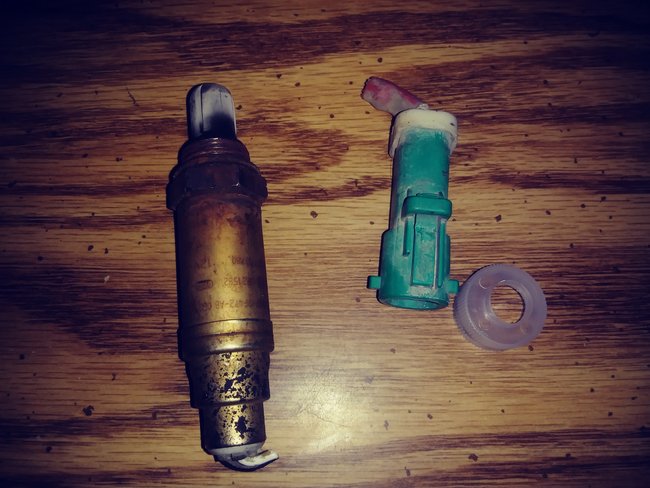

Here is how i hurt my knee: Anyway, my mother and I were working on my van. We were replacing what is called a 02 sensor. I was sitting in the driver’s seat of my van, and I noticed she was having problems loosening a bolt, so I decided to get on the floor of my van and help her out. So, I lowered my driver’s seat down as low as it could go. So, I had two choices I could get out of my driver’s seat either to my right or to my left. I went to my left going between two seats and the wheelchair lift post was there too. Now I got out of my driver’s seat, and I have no Idea what happened to my right leg. But the left leg landed on the carpet of the van with no problem. What happened to my right leg I have no idea what happened to it? It might have hit something, when you can't feel in your legs it can cause all kinds of problems if you're not careful etc.
Scanner: The manual what came with that scanner is only 15 pages. And none of the error codes follow the format P0133 etc. These have words as error messages for this scanner. But i will have to get used to it etc. Well, okay, i will let you know Joe (Guys).

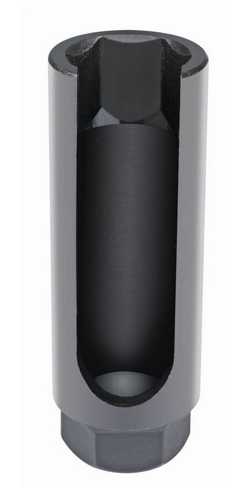

Removing the 02 sensor: Oh yeah i had to end up using one of those 02 sensor sockets to get the old 02 sensor out. I am sure you guys know all about them. Here is a picture of what the old 02 sensor looked like while still in the van. We sprayed it with wd40 and let it sit for a while. and with a 02-sensor socket eventually it came out etc. We had to cut the wire to it to get the 02 socket to work on it of course. But i am sure you guys know all about that too.

As far as the scanner is concerned, let me know if the light returns. Also, the O2 socket I have absolutely used a thousand times. They work!!!
