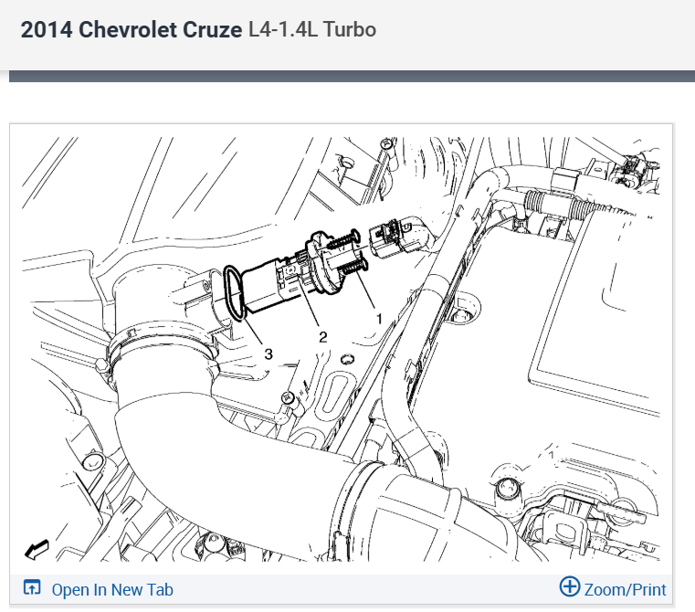

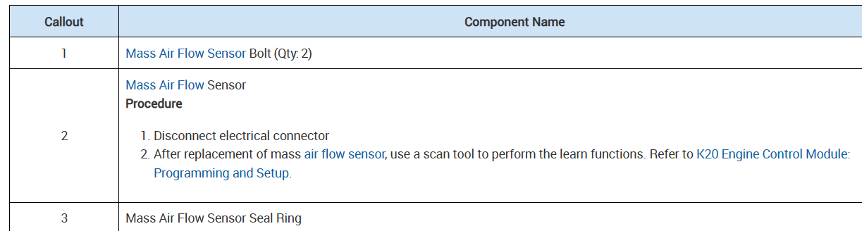

If you did not have these codes before I would replace the MAF sensor which sounds like you have a defective part. Can I ask which brand it is?
Code P1101 - Intake Air Flow System Performance
Code P0420 - Catalyst System Efficiency Below Threshold (Bank 1)
Here is the correct way to change out the sensor so we can be on the same page. Also, if the turbo is having an issue, it will cause an internal vacuum leak. FYI. Clear the codes once the repair is done and please get back to me. Check out the images (below).

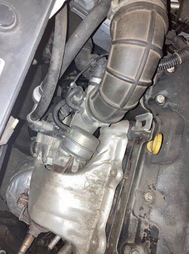

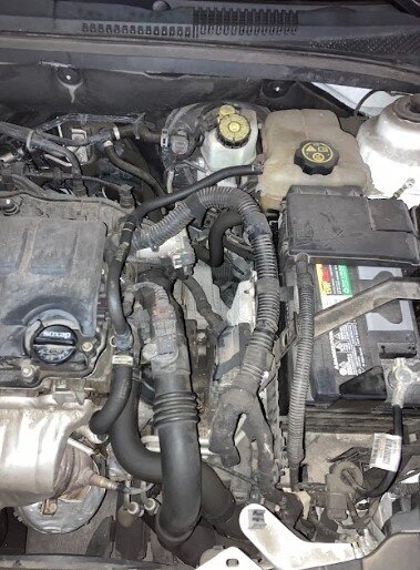

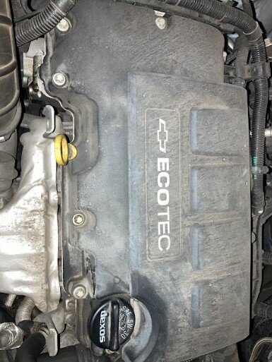

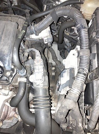

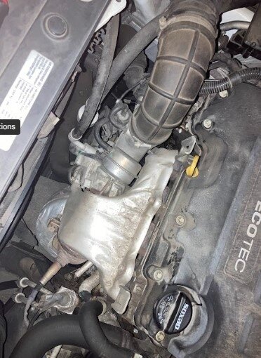

I changed air filter, MAF sensor and cleaned out the air filter compartment and doesn't seem to have fix. The engine light came on again. I'm unsure of where/how to get to the throttle body on my car and each video i seem to locate doesn't explain it very well. would you have a guide, or would you be able to tell from these pics?
Jan 15, 2025 at 3:53 AM
JBAHUN1
  • 11 POSTS
I think it's connected to the hose in the center.
Jan 15, 2025 at 4:46 AM
  • 55,433 POSTS
New air filter, MAF sensor with no leaks, I would start looking at the turbo, when they wear out, they can leak internally which can cause these codes as well, can you confirm you are still getting the same codes? Also, does the turbo seem to work good before all this started? Thanks for the images, they help.
