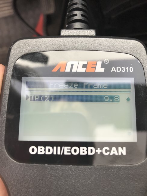

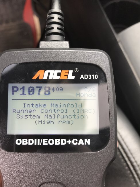

Hello again, recently my RSX has had the engine light illuminating. After using a diagnostic, I have discovered that it has stored the diagnostic code P1078.
I have tested the wiring on the IMRC except for internal resistance (Due to the awkward position of the sensor). I have visually inspected the vacuum tubing for cracks but have not discovered anything (unless there are recommendations to find hairline cracks). I could not check its ability to hold vacuum as I do not have a vacuum pump/gauge and they are rather expensive.

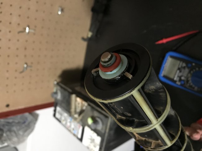

I also removed the IMRC actuator a while back, cleaned both it and its chamber, and put the valve back. I am beginning to think the valve was positioned incorrectly however, as I did not have a vacuum pump to rotate it to the correct position and rotated it by hand instead.

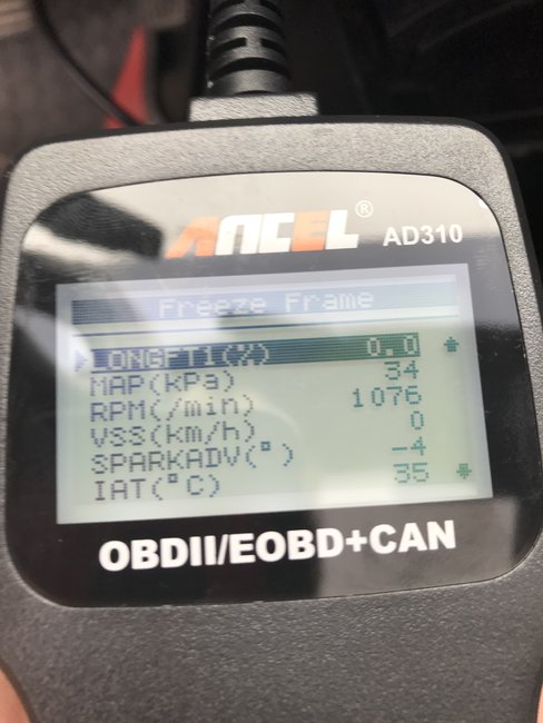

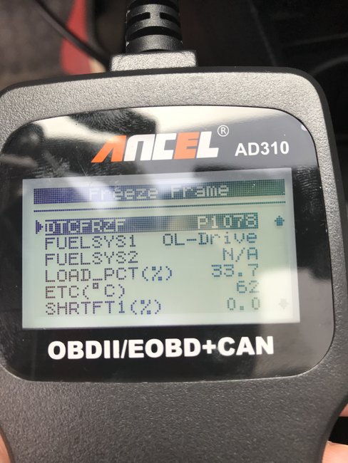

I have reset the ECM several times to see if the code returns and it normally does. On the last reset, I took the car for a drive, and waited for the DTC to return. After parking, shutting the car off and later returning and starting it, the DTC was triggered. I have attached the information below from the diagnostic if it may help to understand if the issue is a result of air flow.

Hello there, thanks for using 2CarPros. Yes, you are correct that you need to apply vacuum to the valve before installing it, once vacuum is applied (vacuum pump) there is a notch that lines up inside, you can see it while installing the valve back into the intake manifold. Hopefully this helps, the code is for the valve sticking too long and the ECM responding to it.

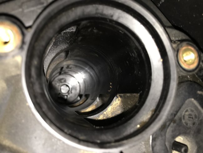

I have just finished realigning the IMRC valve. I ensured that the tiny metal square inside the manifold lined up with the channel on the end of the spool valve.

Great news, I have fixed my p1078 code. I went to a local scrapyard and found a 2004 Honda CRV. The intake manifold between these two vehicles were a perfect match, and I also grabbed the bypass solenoid and vacuum hosing. After cleaning the IMRC actuator in the new part, I discovered there were plastic pieces on the end of the rotary valve that mine was missing, likely lost by a previous owner who took it out prior to my purchase. Likewise, the vacuum hose on the bottom of the bypass solenoid had began to dry rot which made the tubing crumbly, this preventing a perfect seal. This has effectively solved my p1078 code!
