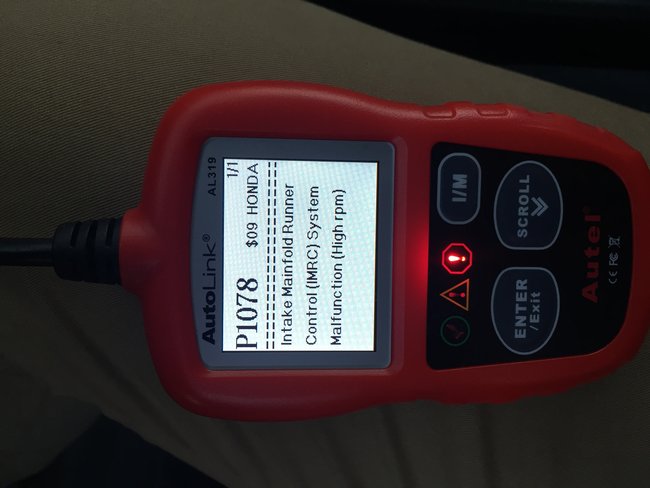

Hi, I had a check engine light with error code P1077. Mechanic did some troubleshooting and we ended up replacing the IMRC actuator assembly (Part number 17120-PPA-A01 $285.00) and the bypass control solenoid valve assembly (Part number 36163-PND-A01 $120.00). All was great for a day.
But, after about twenty five miles, I now get the P1078 code!

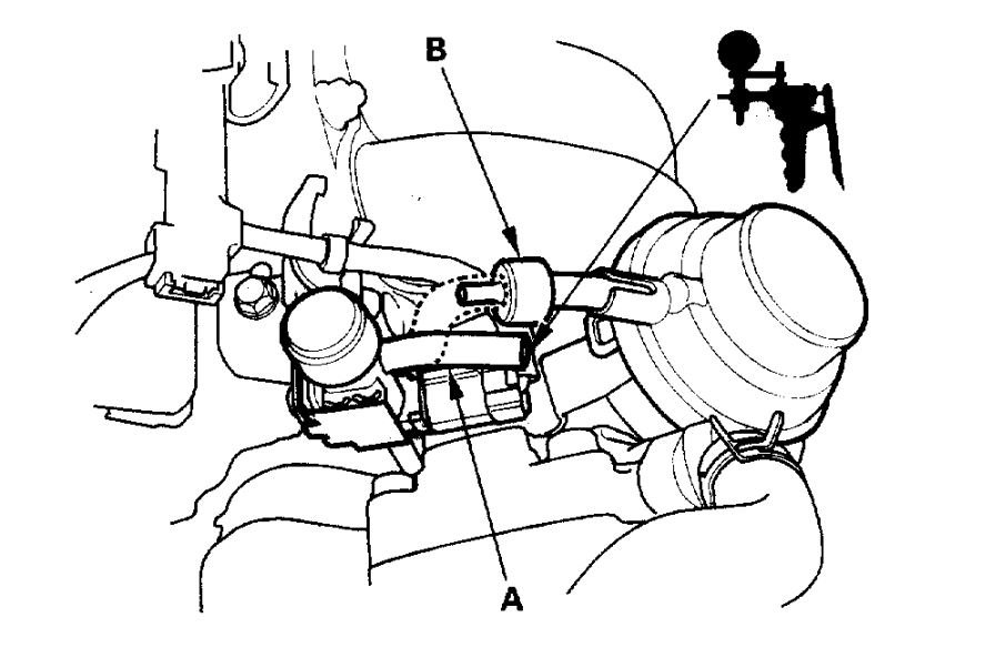

Good evening.
I attached possible failures and a flow chart for the code. When I got these codes, I replaced the intake manifold complete. The issue is usually the inside of the intake gets carbon-ed up.

5. Disconnect the vacuum hose (A) from the joint (B), and connect a vacuum pump/gauge, 0-30 in.Hg, to the hose.
6. Start the engine.
7. Measure the vacuum.
Is there vacuum?
YES - Go to step 8.
NO - Go to step 13.
