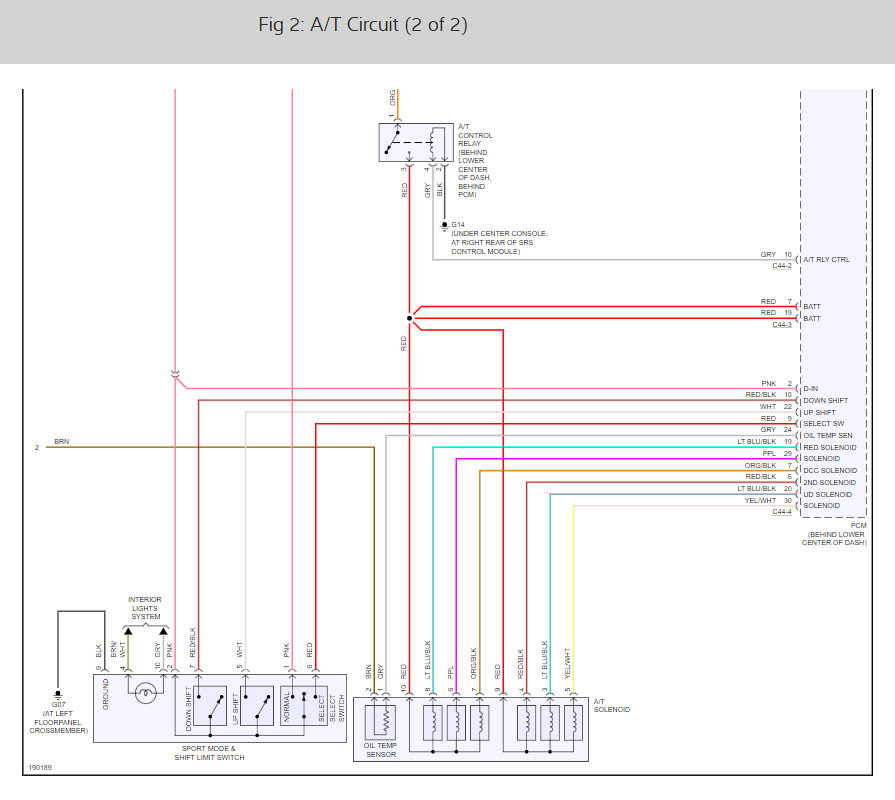

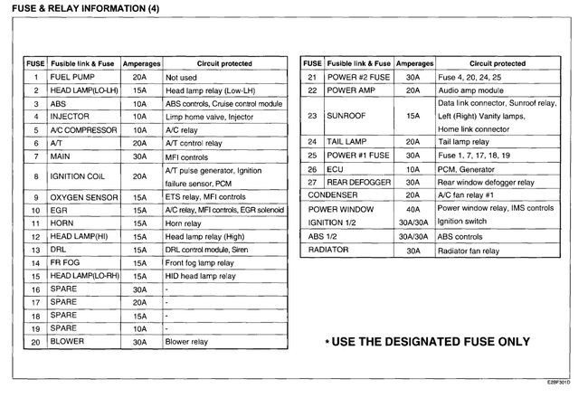

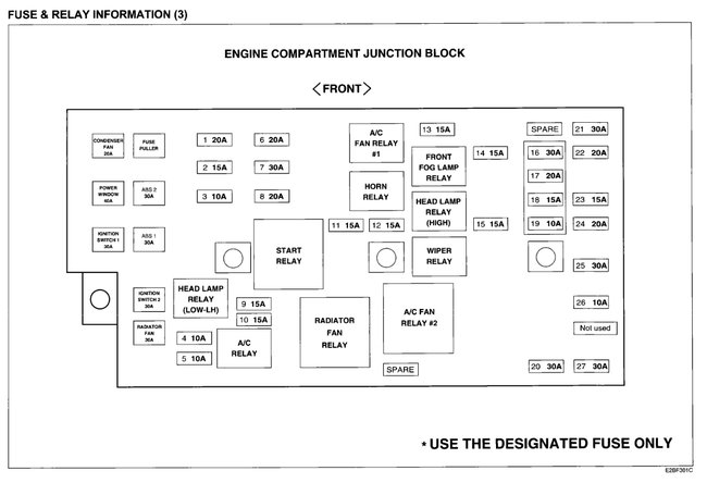

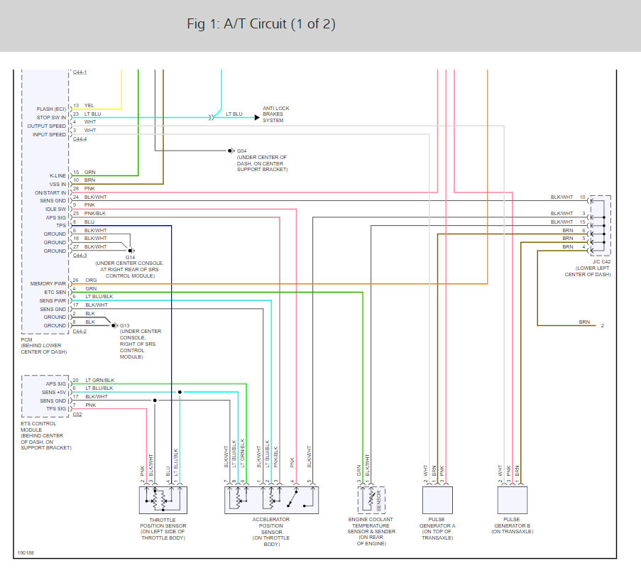

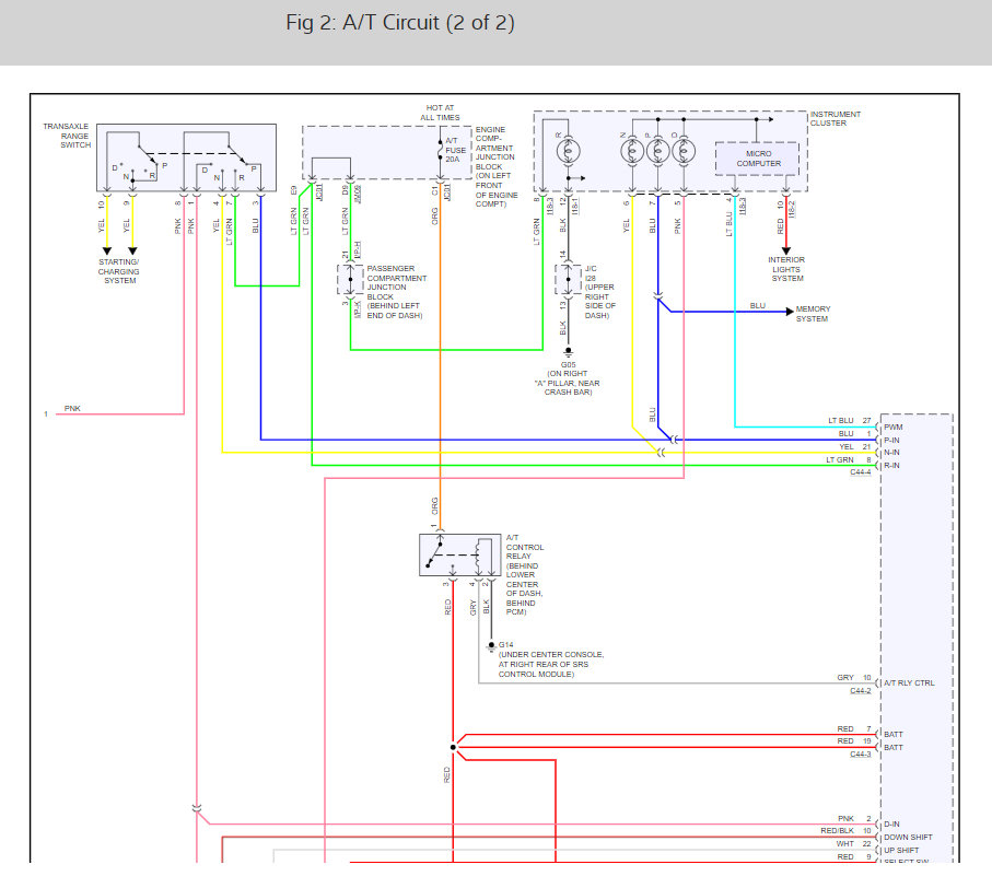

Please help Im stuck with DTC P0885. Changed AT relay code still there, checked voltage at number 1 pin on the relay connector, voltage present, checked same on number 3 keyed on..no voltage. Fuse in engine bay number 6 is good, days of scouring the internet has me spinning in circles. I am assuming my next step is verifying power at PCM but clueless as to how I approach it. any help would be appreciated. VIN KMHFU45E55A386292. Sorry I just triple checked and I was right the first time. Scanner is telling me p0885 TCM control module.

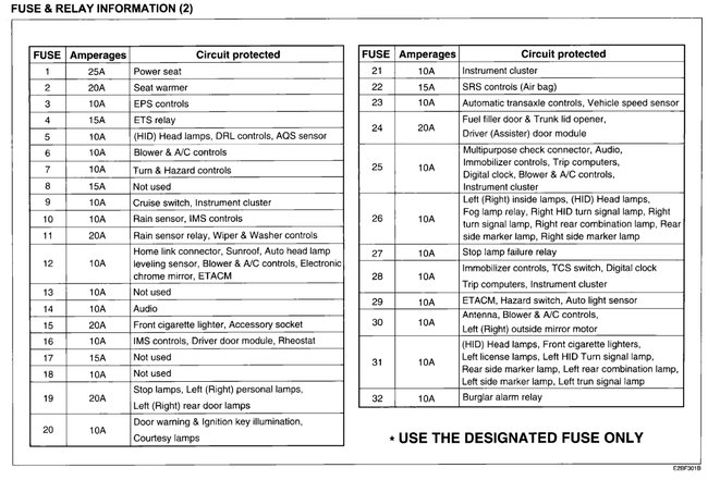

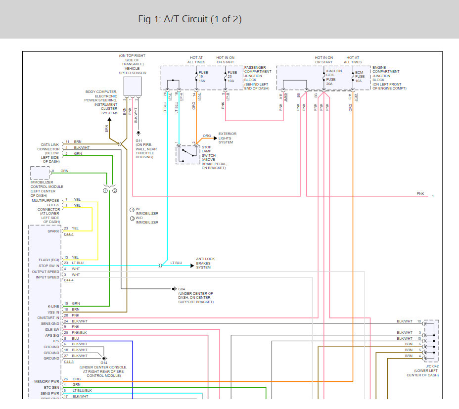

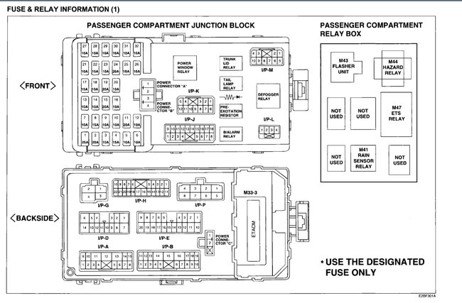

If I can jump in here, I would start by checking the fuses. here is a guide to help and the transmission wiring diagrams so you can see how it works and which fuses to check with the fuse locations as well (below). Also check the TCM relay.
and
