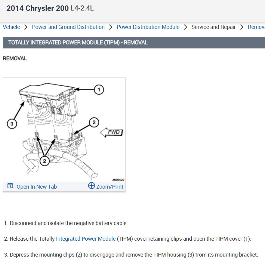

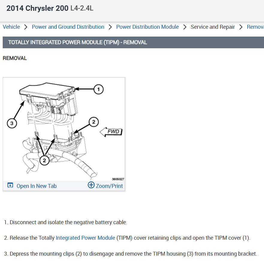

There is not a procedure that needs to be done when the battery is replaced. But you might have had a voltage spike that caused problems with the TIPM which are common to go out. Please check the fuse #33 10 amp which powers the TCM. The fuse should have power all the time which is in the fuse panel under the hood.
The P0882 error code indicates a problem with the Transmission Control Module (TCM) Power Input Signal being low.
Here is the fuse location which is inside the TIPM for clarity. Check out the images (below). Please let us know what happens.

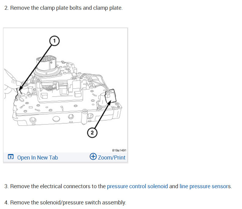

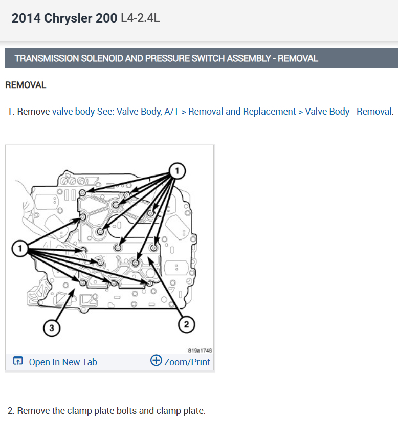

This means there is a problem with the TCM or one of the shift solenoids is shorted out. When it was working how did it shift normally? If so, I would try replacing the transmission solenoid/pressure switch assembly. Check out the images (below). Please upload pictures or videos in your response of any problems so we can see what to help you with. Clear the codes once completed.

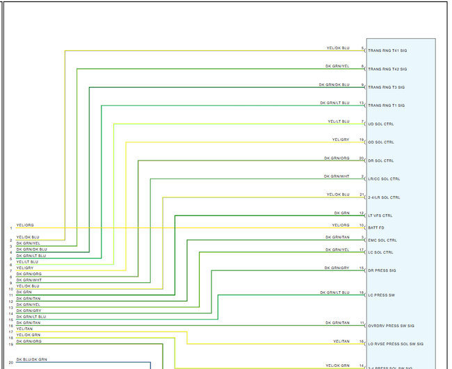

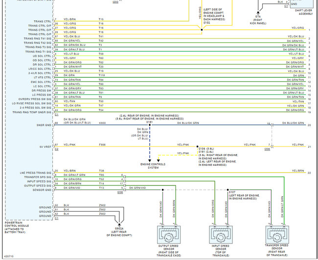

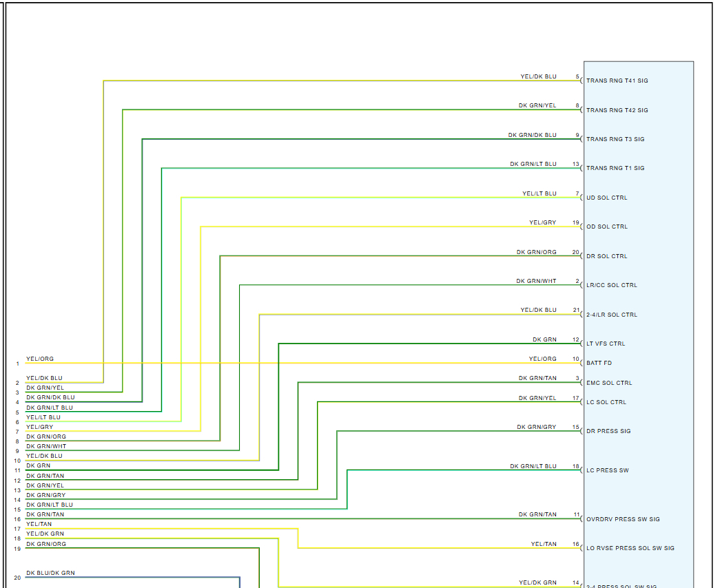

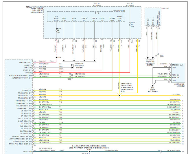

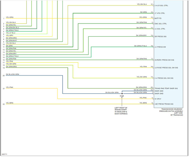

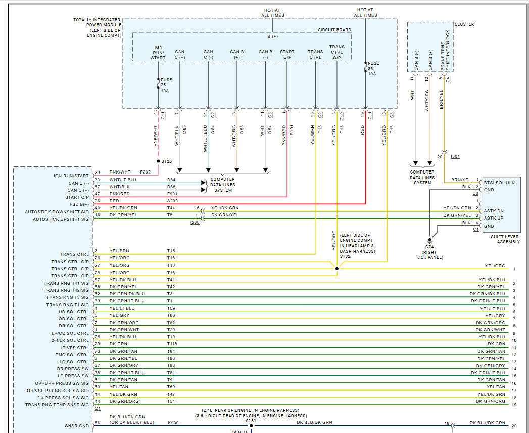

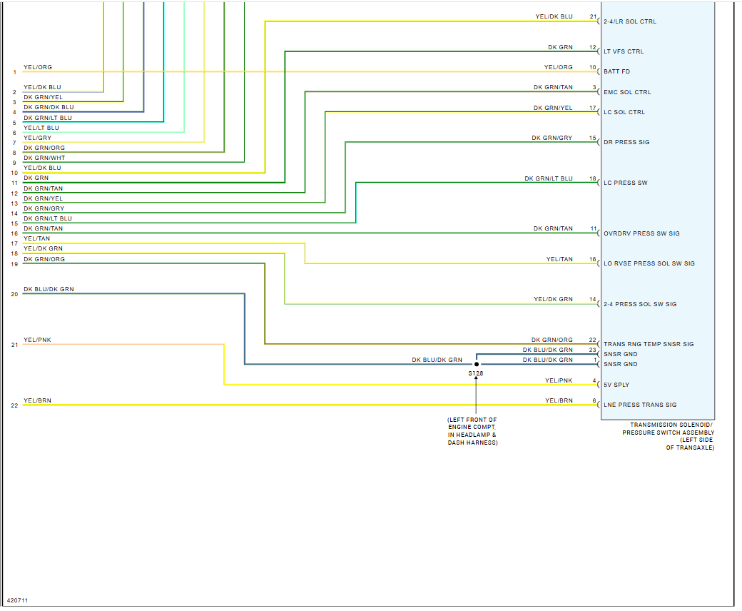

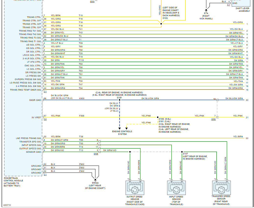

Yes, that could be, something is making it go into limp mode which causes the code. There is no TCM just a PCM, most of the time is will be the solenoid pack but it could be the TIPM is going out or a bad connection.
Here are the wiring diagrams and a guide to help you do some testing:
You might want to run a CAN scan as well to see if any codes are stored. You can get a CAN scanner (Controller Area Network) which will work on most cars from Amazon.
