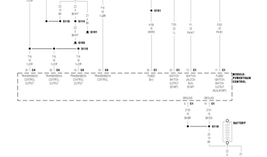

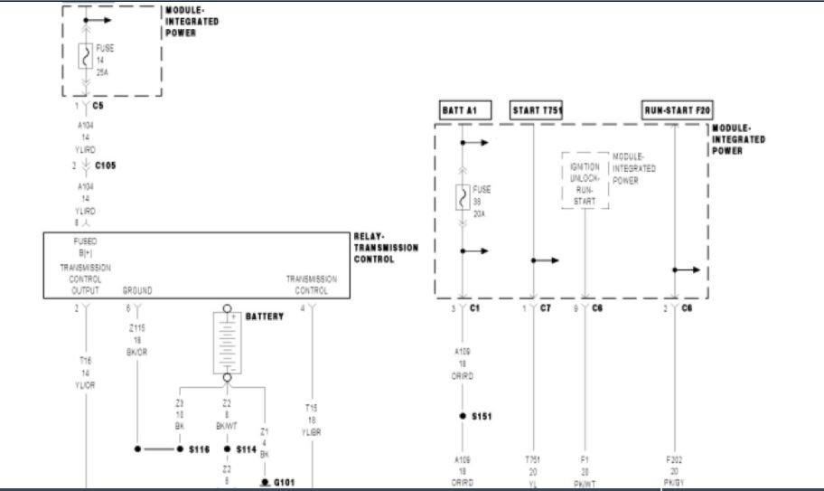

I attached a flow chart with a wiring diagram for you to check.
IN most cases, this could be the module but needs to be confirmed with the flow chart.

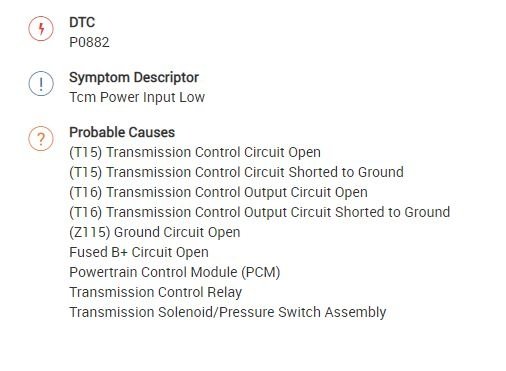

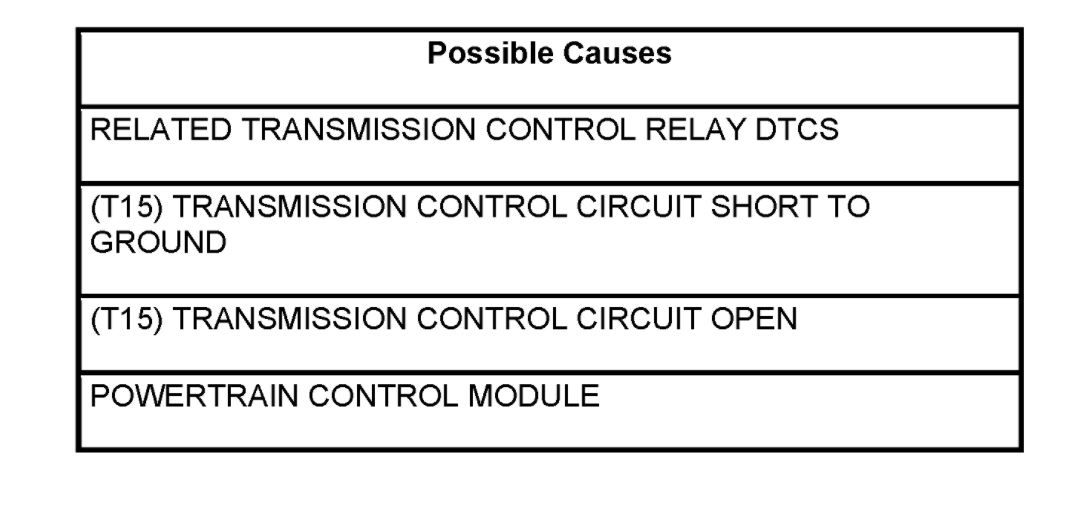

P0882-TCM POWER INPUT LOW
For a complete wiring diagram Refer to Diagrams/Electrical. See: Vehicle > Electrical
Theory of Operation
The Transmission Control Output circuit is used to supply power to the Transmission Solenoid/TRS Assembly and to the PCM when in normal operating mode. The purpose of the Transmission Output circuit is to allow the Transmission Control System to turn off the power to the Transmission Solenoid/TRS Assembly in event that the transmission should need to be placed into "limp-in" mode due to a DTC.
After a PCM reset, (ignition switch turned to the run position, or after cranking the engine) the Transmission Control System verifies that the Transmission Output circuit is open by checking for voltage on the Transmission Output circuits before the Transmission Control Relay is energized. If the Transmission Control System detects less that 3.0 volts when the output is commanded on, the DTC will set.
Note: Inadequate Transmission Control Output voltage can also cause DTCs P0846, or P0871, to set. This does not indicate an internal transmission or solenoid/TRS problem. Repairing the P0882 fault should also eliminate the related DTCs.

Note: Due to the integration of the Transmission Control Module and the Powertrain Control Module, both systems have their own power and ground circuits.

2. CHECK FOR TRANSMISSION CONTROL RELAY DTCS
With the scan tool, check TIPM DTCs.
Are there any Transmission Control Relay DTCs present?
- Refer to Transmission and Drivetrain and perform the appropriate test(s).
- Go To 3

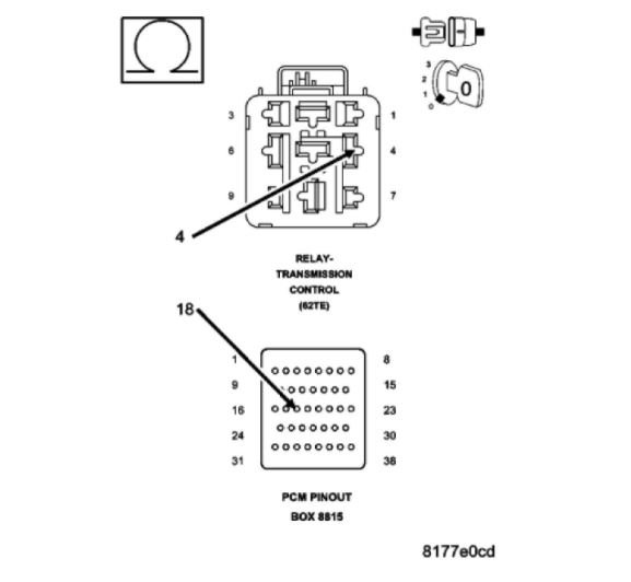

3. CHECK THE (T15) TRANSMISSION CONTROL CIRCUIT FOR A SHORT TO GROUND
Turn the ignition off to the lock position.
Disconnect the PCM C4 harness connector and connect Miller tool #8815.
CAUTION: Do not probe the PCM harness connectors. Probing the PCM harness connectors will damage the PCM terminals resulting in poor terminal to pin connection. Install Miller tool #8815 to perform diagnosis.
Remove the Transmission Control Relay.
Measure the resistance between ground and the (T15) Transmission Control circuit.
Is the resistance below 5.0 ohms?
- Repair the (T15) Transmission Control circuit for a short to ground.
- Perform 62TE VERIFICATION TEST. See: A L L Diagnostic Trouble Codes ( DTC ) > Verification Tests > 62TE Transmission Verification Test
- Go To 4

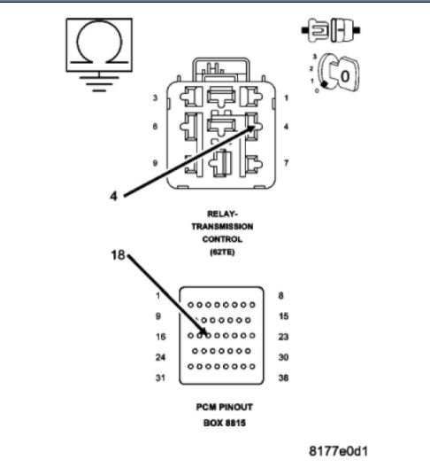

4. CHECK THE (T15) TRANSMISSION CONTROL CIRCUIT FOR AN OPEN
Measure the resistance of the (T15) Transmission Control circuit between the Transmission Control Relay connector and the appropriate terminal of Miller tool #8815.
Is the resistance above 5.0 ohms?
- Repair the (T15) Transmission Control circuit for an open.
- Using the schematics as a guide, check the Powertrain Control Module (PCM) terminals for corrosion, damage, or terminal push out. Pay particular attention to all power and ground circuits. If no problems are found, replace and program the PCM. With the scan tool, perform QUICK LEARN.
