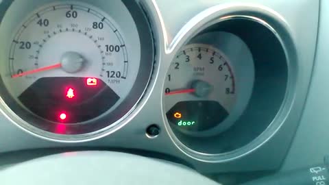

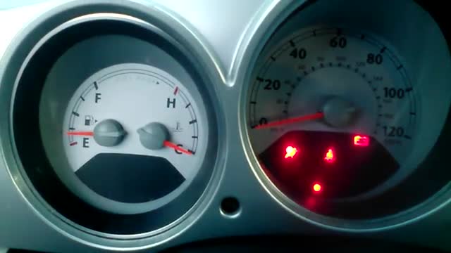

When key on engine off the car is doing as shown in the video plus there is no communication. After when I turn the key to start position the car starts and goes to limp mode with p0882 but the code reader communicate with the car. Parts replaced: PCM and TIPM.

The other thing is when there is no communication .5 volts reference is present so what I heard is if there is 5 volts reference than ground and power to the PCM are good. Also at the same time the PCM does not power up the transmission relay so the car goes to limp mode and no back up light also like you saw in the video the P N R 1 2 either disappear or all of them selected. Also, I forgot to tell the behavior is intermittent.

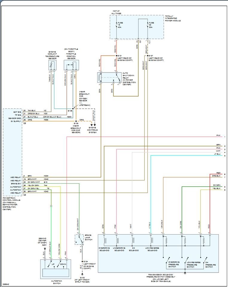

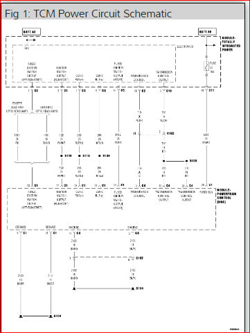

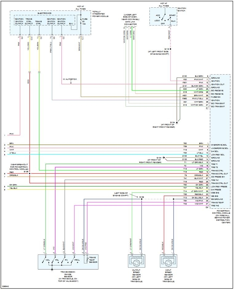

Hello, I am Danny.
Here is a wiring diagram for your vehicle. Have you checked the wiring for broken/corroded/burnt wires near the PCM? Just adding my two cents and hope this helps. I have attached a diagram and a few tutorials for you. Thanks again for using 2CarPros.

Sorry Danny the picture is small I cannot see the writing.
Nov 12, 2018 at 10:27 PM
JONNYB1963
  • 263 POSTS
Let me see if I can get you a bigger picture. I am having trouble logging in to my reference data.
Jon
Nov 12, 2018 at 10:43 PM
JONNYB1963
  • 263 POSTS
Since you say that it is intermittent, then I would definitely look for a broken wire, chafed wire shorting to ground or a damaged connector. That intermittent stuff happens to me all the time. They are the hardest things to troubleshoot! See the diagrams below.

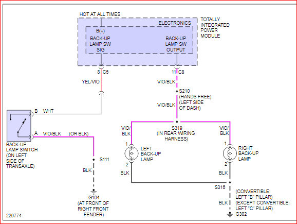

Never mind it was not the cause. Can anyone give me electrical diagram for the backup light?
Nov 19, 2018 at 12:58 AM
DANNY L
  • 5,648 POSTS
Hello, I am Danny,
Here is the back up light diagram. I have also attached a tutorial showing how to check wiring. Hope this helps and tanks again for using 2CarPros.
