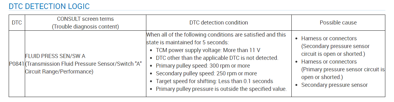

Code p0841 transmission sensor switch, where is located?
Feb 8, 2021 at 7:20 AM

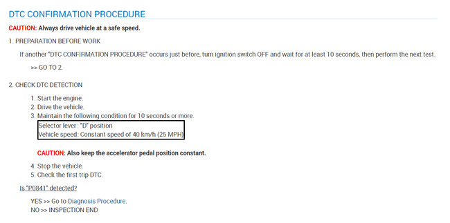

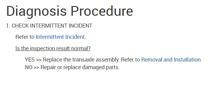

Good morning,
I attached the possible issues for you for the code.
They show no procedure for the pressure switch at all. Since this is a CVT transmission, they recommend replacing the entire transaxle assembly for this code.
